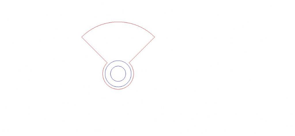

          Interesting contributions chaps
          It looks to me that my pallet is incorrect. Although I did cut it as per Brian's dimensions (shown in blue). As I said, I have overlaid what I believe is Brian's pallet taken from a photo.
          What I started with, is shown in magenta ie using the dimensions shown in blue – there's quite a difference between the two. There's no way you can get the red pallet from the blue dimensions
          BTW the pallet is mild steel and not hardened
          #263371
          Russell Eberhardt
            @russelleberhardt48058
            I think your pallet should look more like this:
            The angle between the faces is 90°. The radius should be as per the original. Yours was too big and there was more rubbing than necessary. Make it from gauge plate, harden it, polish it, and fix it to a bush with Loctite high strength retainer.
            Russell.

              OK ..time to start again with both variants The 122deg Brian pallet and Russell's suggested 90deg pallet
              #263626
              Russell Eberhardt
                Bon chance!
                Russell
                #263806
                John silver
                  @johnsilver78232
                  Well initial results with Russell’s suggested pallet look promising – certainly a lot easier to make.I noticed that my escapment wheels are not exactly perpendicular to the pallet rest. So i have shimmed the pallet base cross bar at one end i think i will now round and polish the escapement spokes and pallet to reduce any friction
