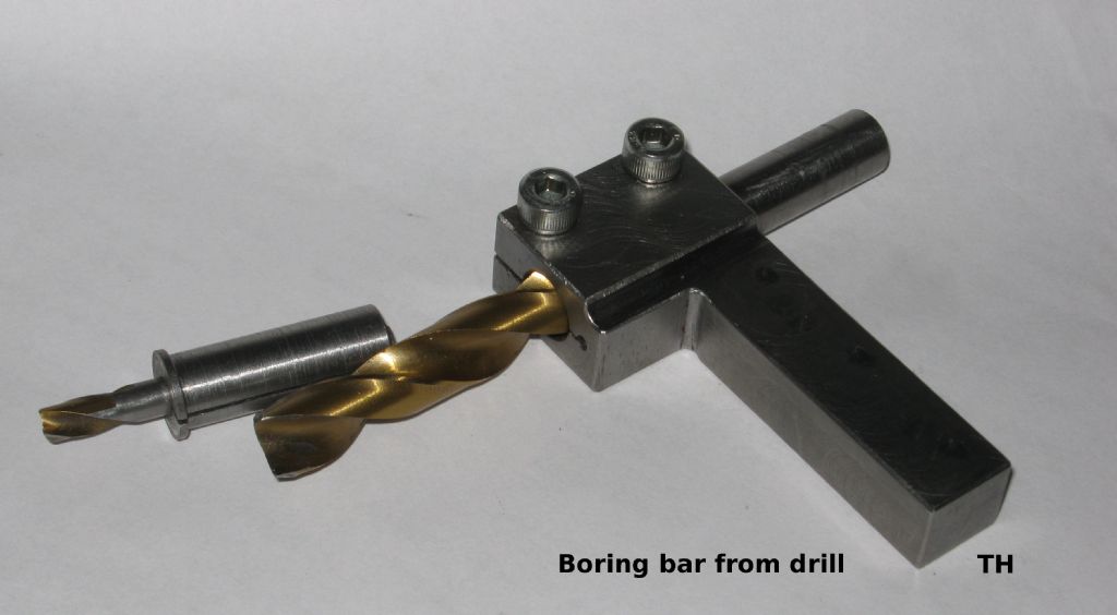

      A drill is far too flexible to use as a boring bar and the outside land would rub.
      I can see flexibility could be an issue, but that could be addressed by taking small cuts – a 3/8" drill normally takes two 3/16" deep cuts, so taking 1/32" on one side shouldn't be too much?
      I can't see why the land would rub?
      This was just a 'get out of jail' thought, I have plenty of proper boring bars but if I even need a deep hole bored perhaps I shall try it and see what happens.
      It occurs to me a that a 'single flute' drill  would still have more metal in its cross-section than a d-bit style boring bar and better 'deployed'. It would also have top rake and better chip clearance. At the very least I think there's room for experimenting with better end shapes for solid boring bars than those usually supplied for boring heads.

        The land of a drill, that is, the outside diameter, is ground cylindricaly with no clearance which means it will rub. You can see how flexible a drill is, you can almost bend them by hand but go ahead and try it, nothing lost.
        A milling slot drill has side clearance and will work as a boring bar until it becomes disproportionally long compared to its diameter when it too will flex. But any port in a storm! If you don't have a better alternative…….!

          Like Peter I have made a boring tool from old drills. Since I don't have imperial drills I used a 10mm instead of 3/8". The cutting end has been ground and the drill must be placed at a slight angle to the lathe centerline to give some clearance, so min. hole dia. I can bore is of course larger than the drill dia. As you say, small cuts will work, and the drill can't protrude too far from the holder.
          Thor
          Edited By Thor on 27/07/2015 06:17:34
              Thor
              That's exactly what In had in mind, aside from the useful idea of grinding the end..
              If the drill is smaller in diameter than the hole, it won't rub.
              Edited By Neil Wyatt on 27/07/2015 08:29:38

                A slot drill makes an excellent boring tool, which can easily be off set and remain ridged.

                  For boring small holes I have used old taps. Worked well for me.
