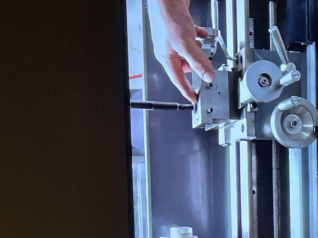

              img_5489.jpegJust watched a YouTube video where a chap had a problem
              mounting a 111 due to the spindle being incorrect – so he drilled the supplied internal mounting bolt of the 111 and tapped it – then fitted it over his spindle. Seemed to work
              well.

                Yes that is an option with the larger 14mm dia of the 111 QCTP, the one from the 10mm would probably be a bit weak by the time M8 thrad had been cut into it.

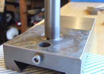

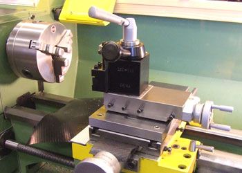

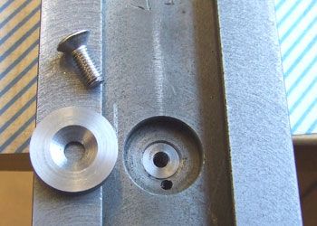

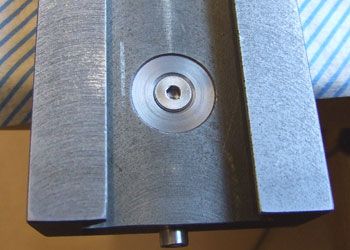

                  There are indeed plenty of ways to fit the new stud. I screwed mine in and used the recess for a washer and lock screw.
                  The new post threaded into top-slide M10 thread
                  Underneath, centre of the post tapped M5 and washer fills the old recess.
                  Fitted together.
                  The end result on my WM250 with the 100 size version (AXA) wedge type QCTP fitted. See my webpage for more info.

                    Very nice solution John – thanks for sharing. yes
