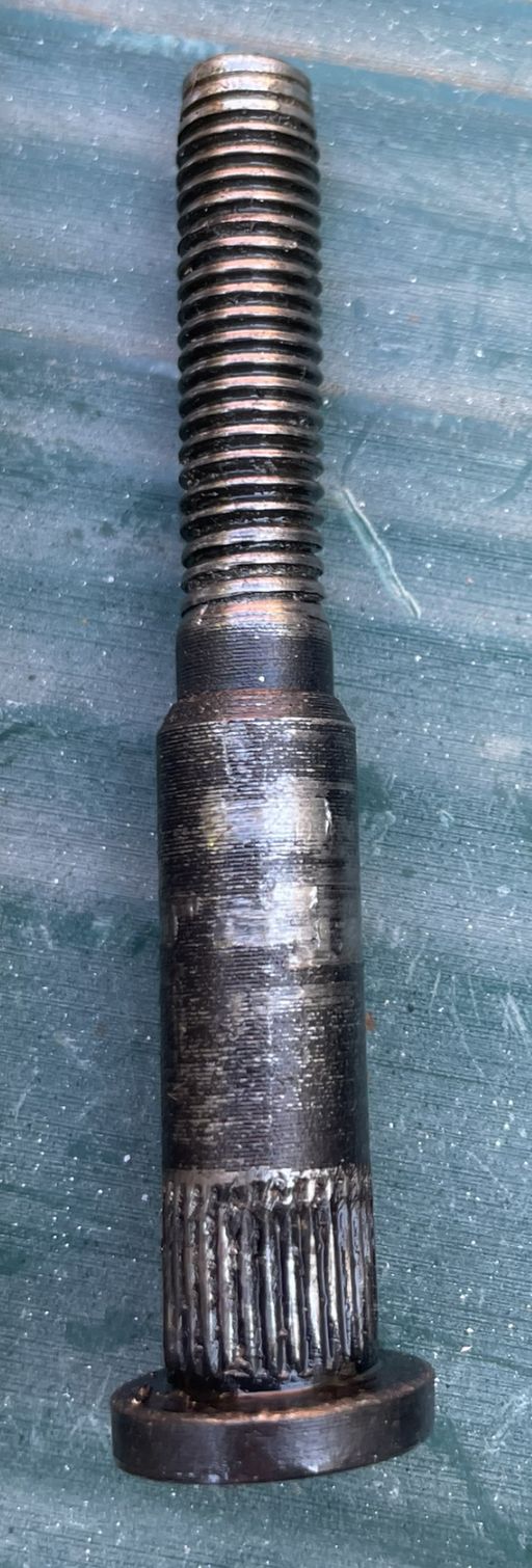

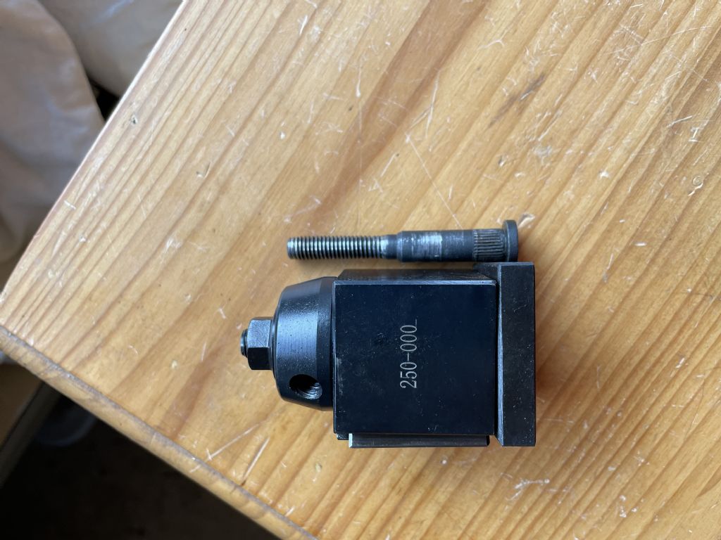

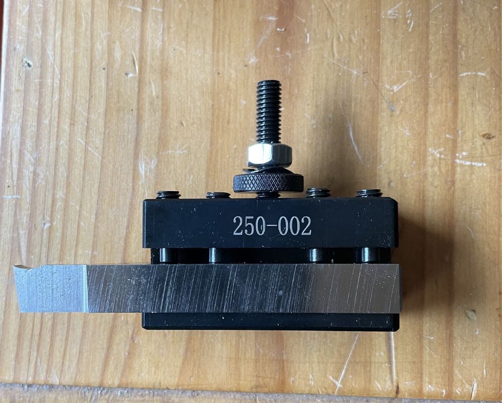

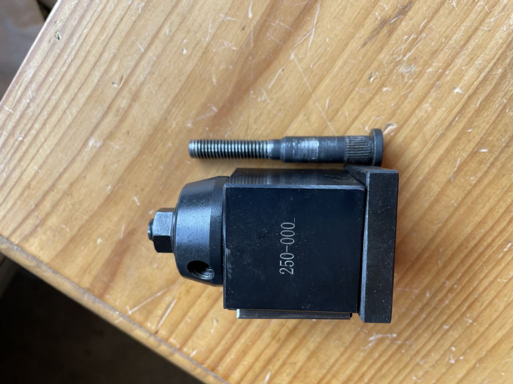

        Thanks gentlemen. I have just purchased img_5469.jpegthe relevant machine screws with socket fitting from GWR as per your recommendations.

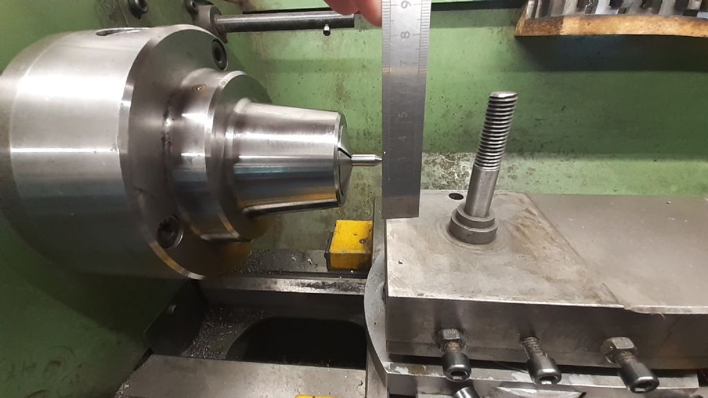

        Jason – I am not sure the original stud is long enough? I tried to photograph it against the QCTP but the phone camera distorts it somehwat. The stud collar is aligned with the base of the QCTP in the pics and to me, looks about 15mm too short?

            Yes looks a bit short to use the existing nut.
            What is the diameter of the thread on the old stud, as I said a custom nut with a shoulder that will reach down into the toolpost hole may be all that is needed.
            Also to check the size of toolpost to suit your machine what is the thickness from bottom of the old 4-way tool post to the surface that the lathe tools rest on?

              It is a fairly minor job to replace/extend that existing threaded part. Best done with an operational lathe, mind. That old stud reminds me of lug studs for fitting wheels to vehicles.

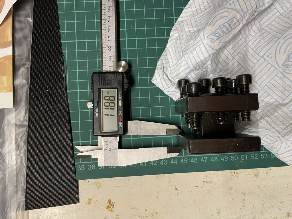

                        Jason

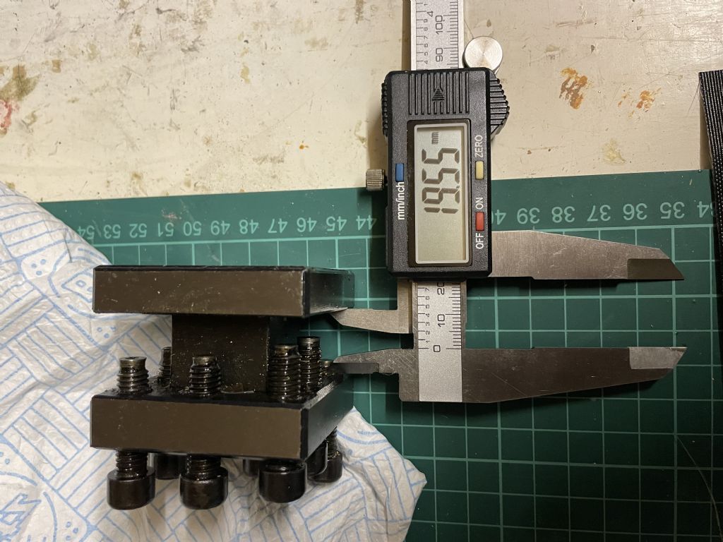

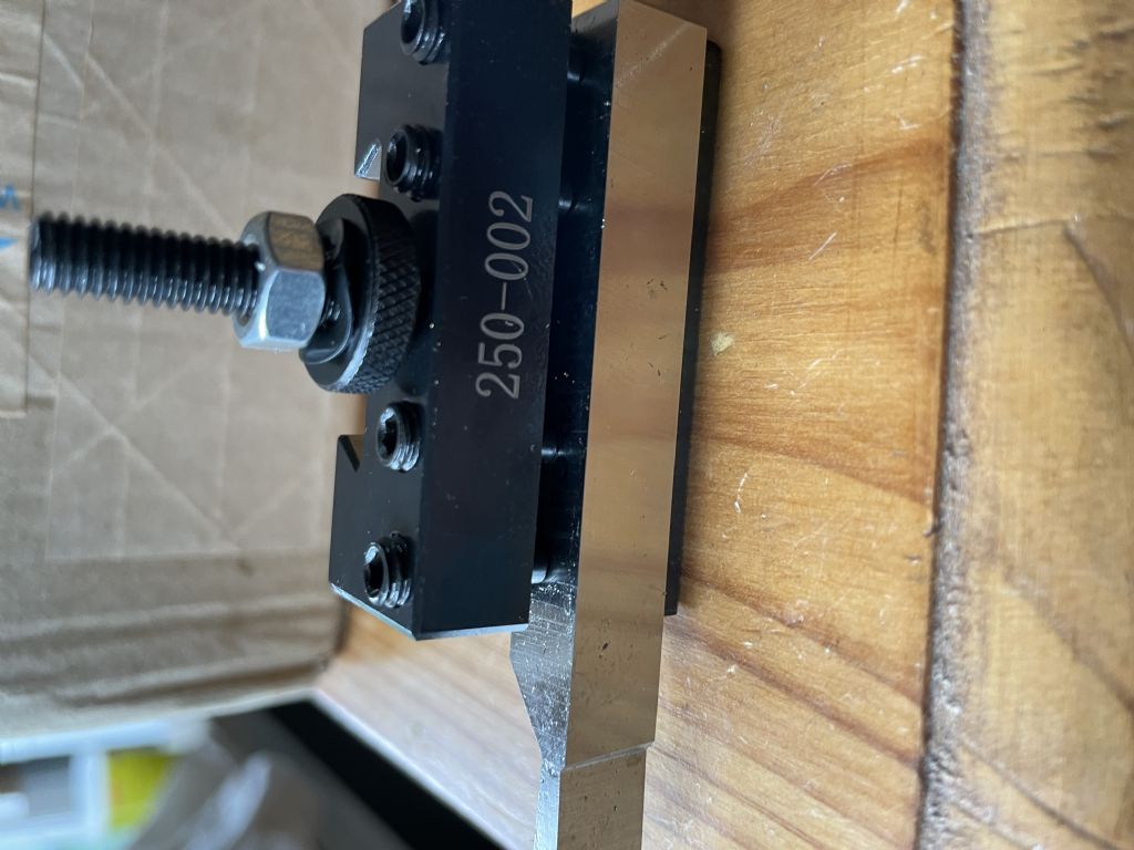

                        do these photos help at all?

                            Let me know the two shown
                            Edited By JasonB on 30/07/2023 20:48:45

                              Jason:
                              #654509
                                Thanks for those Margret, Both the QCTP you have and the 111 would work with larger tooling but the 000 may not suit the smaller sizes. To check exactly what works could you put something pointe din the lathe chuck or tailstock and take the measurement from that to the top surface of the top slide as below
                                Also if you could measure the diameter of the threaded portion of your toolpost stud that would help deciding what's the best way to modify that. I suspect it's an M8 thread so should be 8mm or a bit under.

                                  As jason says, the thread on the original toolpost "bolt" is probably M8, while the new stud for the QCTP may be M10.
                                  IF long enough the "bolt", having a 10 mm shank, wsould be useable with a new washer, Top Hat or conical, with the QCTP.
                                  The damaged csk screws can be replaced by ordinary csk Allen screws. No need to anything different.

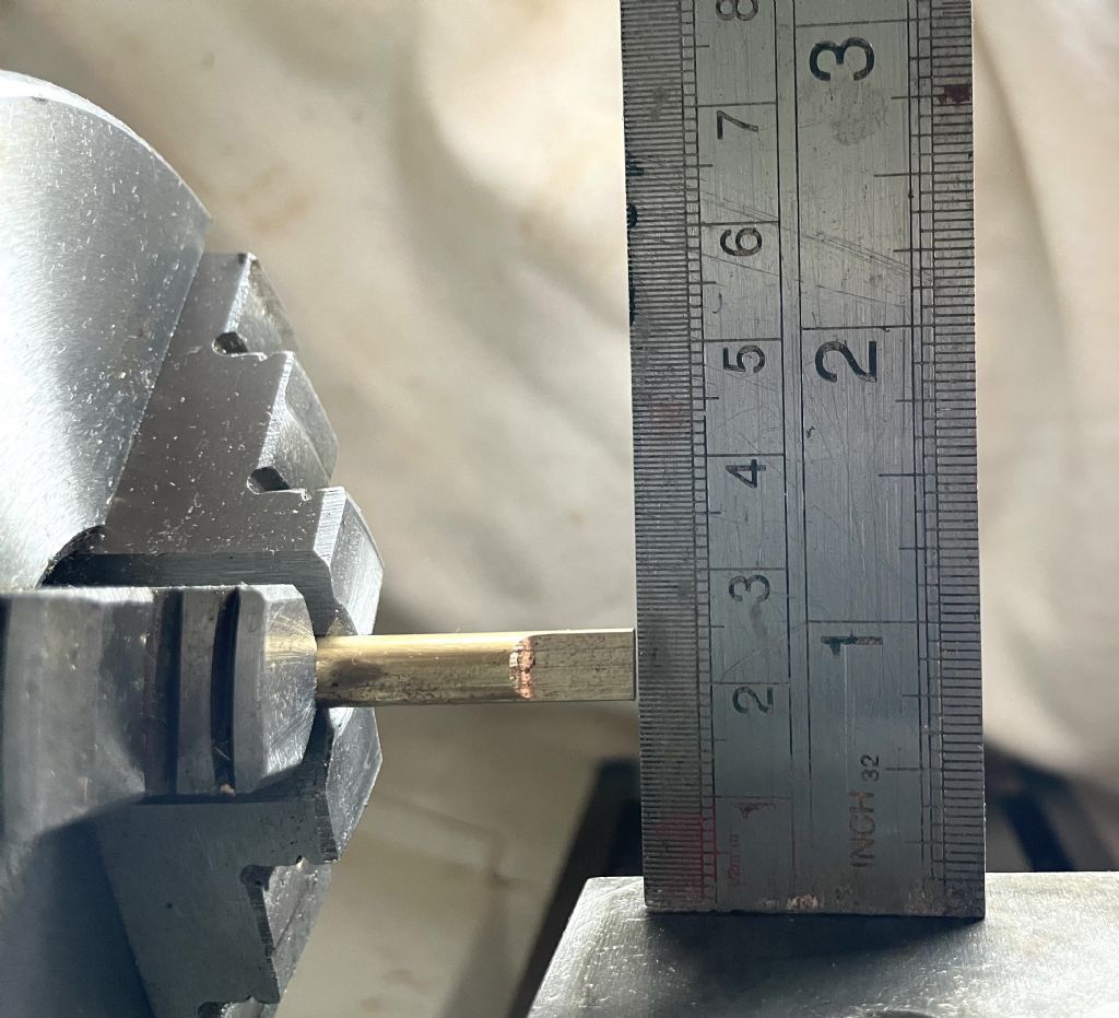

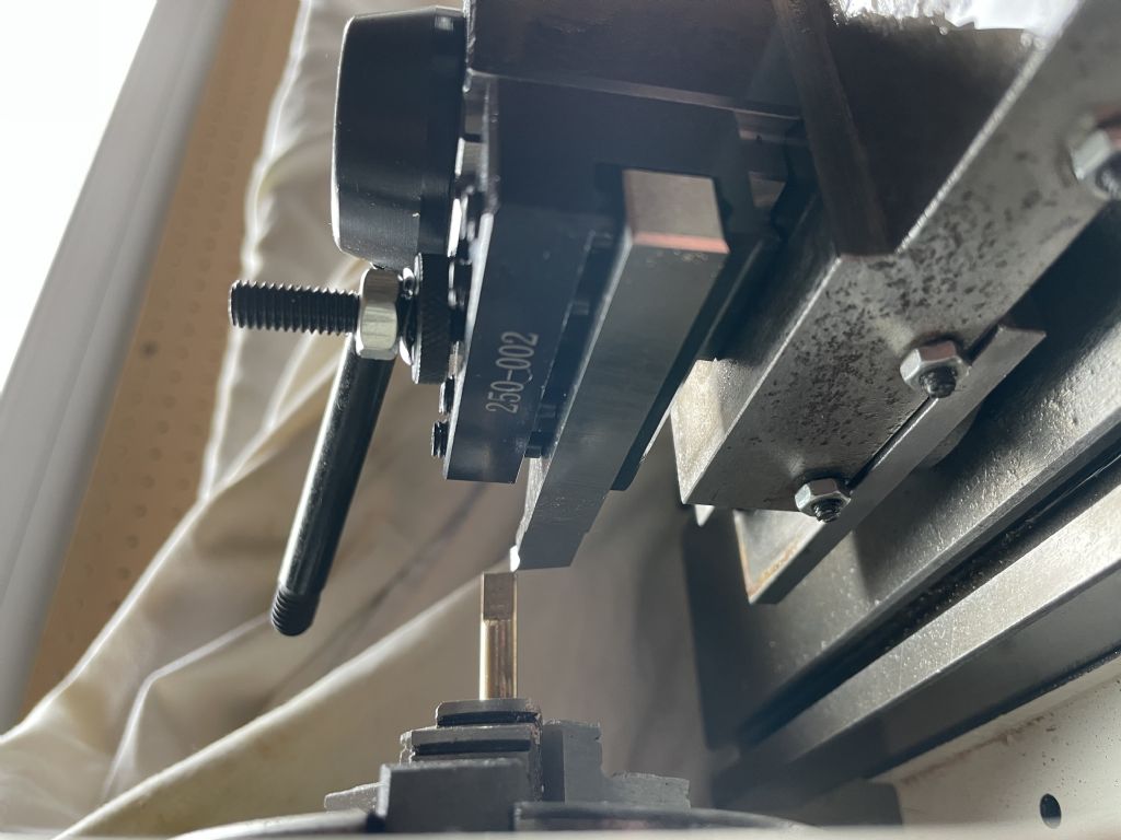

                                    Jason – putting the tool in and offering up to a workpiece looks fine – although I did have to adjust the tool holder up a little (not sure if this is normal practice as i have nothing to compare against) – but a standard tool of the size I generally use does reach the work piece ok. See pic. I will try the stud later when home tonight but it looks likely that the stud will work or worst case, I need a new stud. The threads on the original stud look a bit worn don’t they?

                                      Looking at the first photo the tool does not look like it is not yet lined up with the ctr of what you have in the chuck so could do with going up maybe another 2mm. This will put you right at the limit for that height of tool (10mm? ) and anything smaller won't really come upto ctr height without being packed up. So I would be more likely to opt for the 111 toolpost with standard holders so smaller tooling can be used. (hope the bottom ring is screwed on in that photo)
                                      The other advantage of the 111 is the hole in the middle of the toolpost is 14mm which would be better to allow the existing stud to be retained and a shouldered nut made.

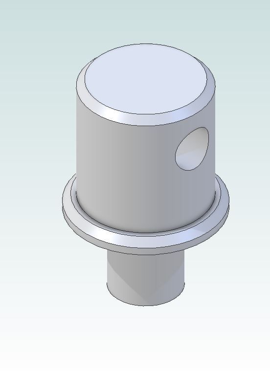

                                          Hi Jason, just read your latest response during a break (lol). Yes I think you may be right, it does seem quite near the extremity of it's adjustment – I think the 111 might be a better option. See pics below, they show clearly how near it is to the limit of adjustment.
                                          Do you agree?
                                          How I would make a shouldered nut though, I have no idea! disgust

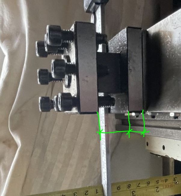

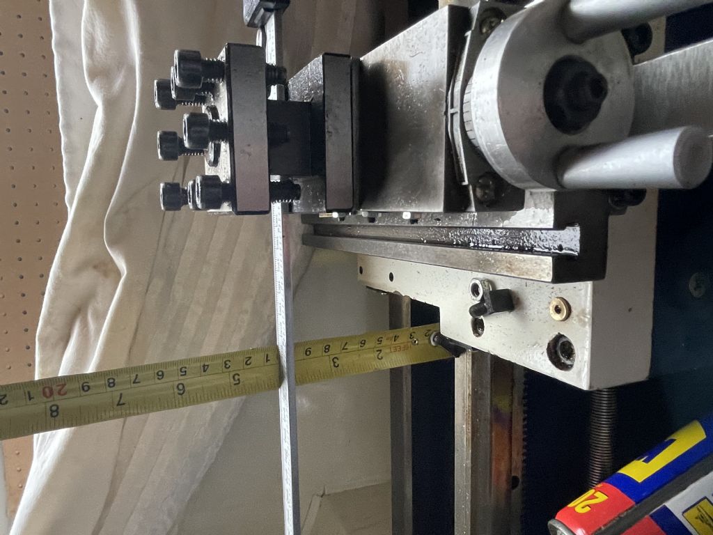

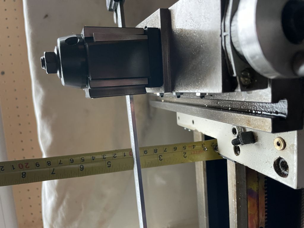

                                            I have just asked my brother to measure the distance from the top of the top slide to the centre of the workpiece/chuck – it is 20mm.
                                            Does that help in anyway? Looking at arceuro's spec, I can't make head nor tail of which QCTP is the correct one for this!
                                            #654544

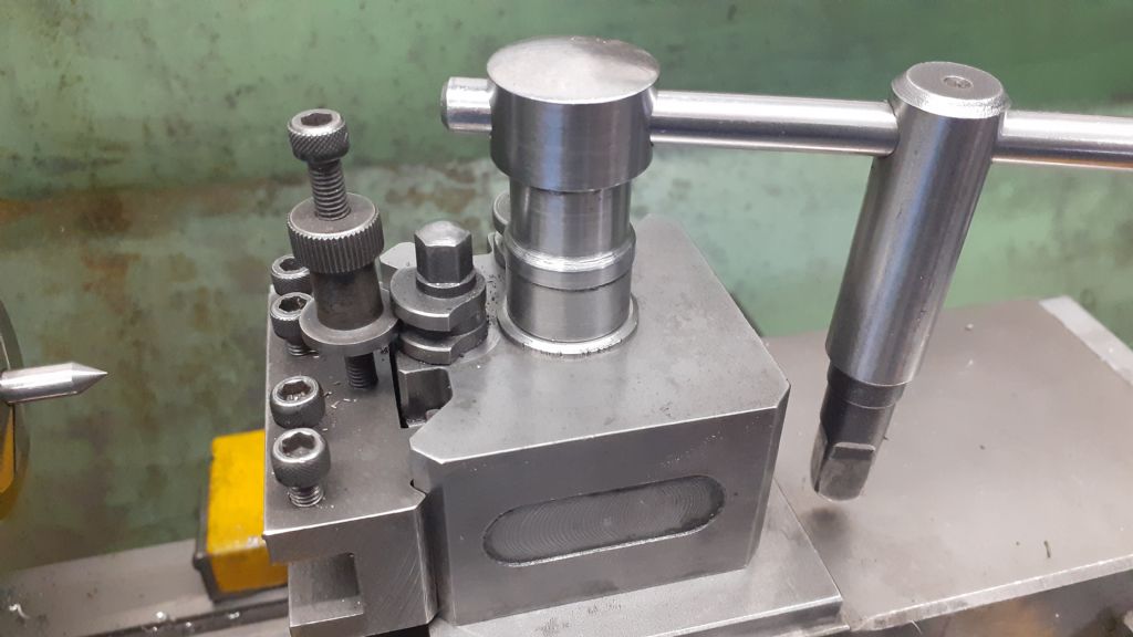

                                              That sounds a bit low to me, from the photos I would put it closer to 25-28mm maybe check again when you are home.
                                              The tool opening in a holder is 13mm so your tool looks to be about 10mm square. Max height of the bottom of the holder is 17mm but your adjuster is a couple of mm from max so lets say 15mm. so add the 15mm and 10mm and the edge of your tool is 25mm from topslide surface.
                                              As for the nut well it only needs to be hexagonal if you want an extra spanner to loose. Simpler to go with something like you have that is cylindrical with either a fixed tommybar or just a hole for one. You could use the washer that comes with the toolpost then it is just a case of turning one end of some say 25mm bar down until it fits inside the toolpost and threading that end to suit the stud assume M8. Last thing is a hole for the tommy bar.
                                              Not far off what I use on mine, the hole is drilled so I can use the chuck key to tighten the "nut"
                                              the larger 14mm hole in the 111 toolpost gives a decent amount of metal around the M8 thread that you would not get if it had to fit the 10mm hole of the 000 size

                                                Thanks, I'll check the measurement when I get home. That is a nice QCTP you have on your machine, where is that from please? Would it fit my machine do you think?

                                                    Jason – you were right about the measurement. Somebody (who shall remain nameless) didn’t do it correctly – it’s 22mm. Does that help in anyway?
                                                    #654594
                                                    Margaret Trelawny
                                                      @margarettrelawny34058
                                                      Ps: it could be more than 22mm Jason but my topslide is not bolted together at the moment while I await those new screws.
