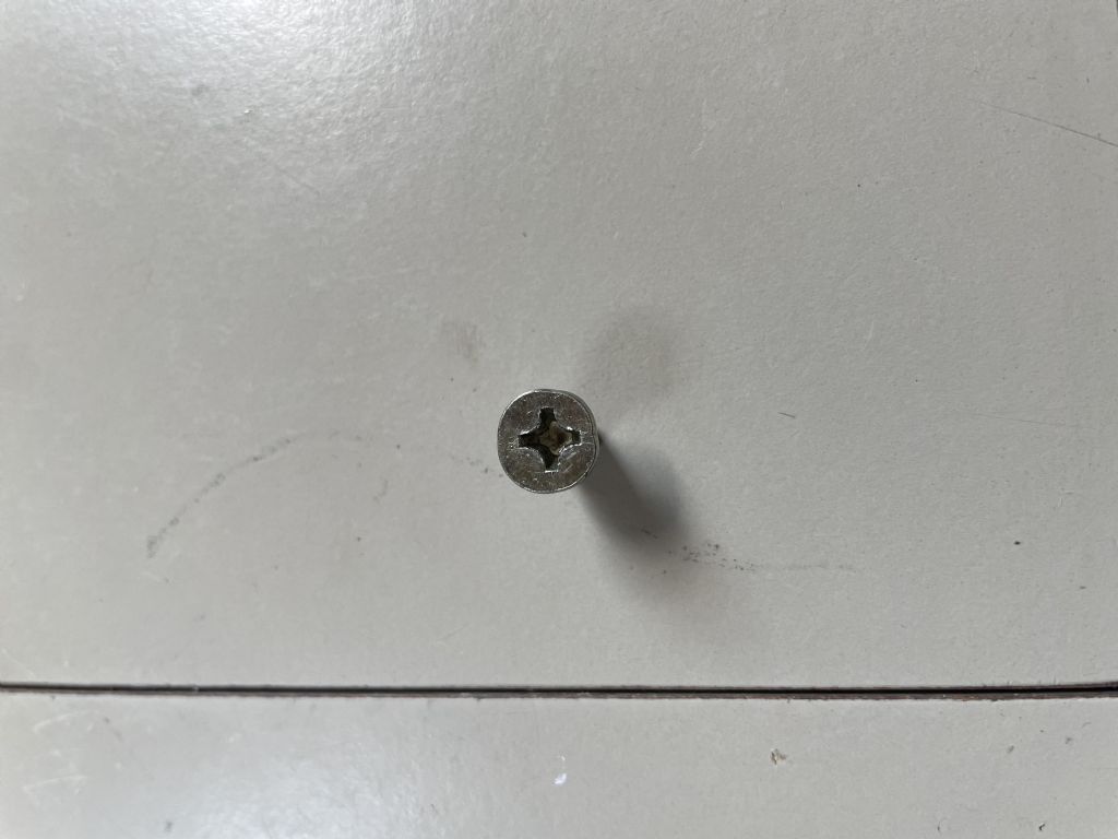

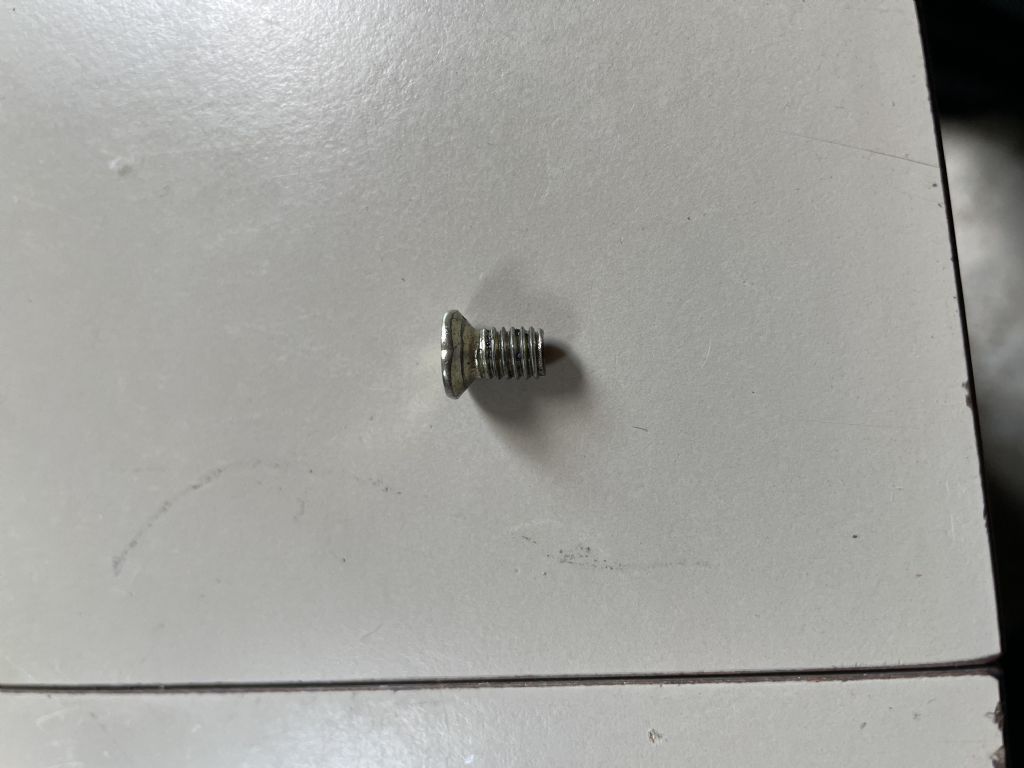

        Hello gentlemen
        I find I am in need of your help again! I decided, on balance, to fit a quick change tool post to my chinese lathe. However, what started out as a good idea has lapsed into a nightmare!
        I cannot budge the fitted standard tool post screw from the cross slide, so thought if I popped the cross slide out – I could access it from the back- but, thanks to rubbish Chinese hardware, the screws won’t come out and now the heads are stripped. So to Amazon to buy a damaged head screw remover kit. No problem. Annoying but it is chinese!
        So I will need to replace these screws – but haven’t a clue what thread size to order! Please see attached photos. Any help or advice most gratefully received.
        Thank you

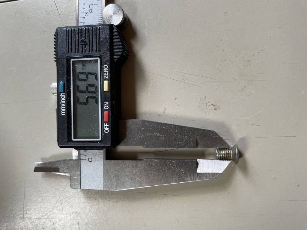

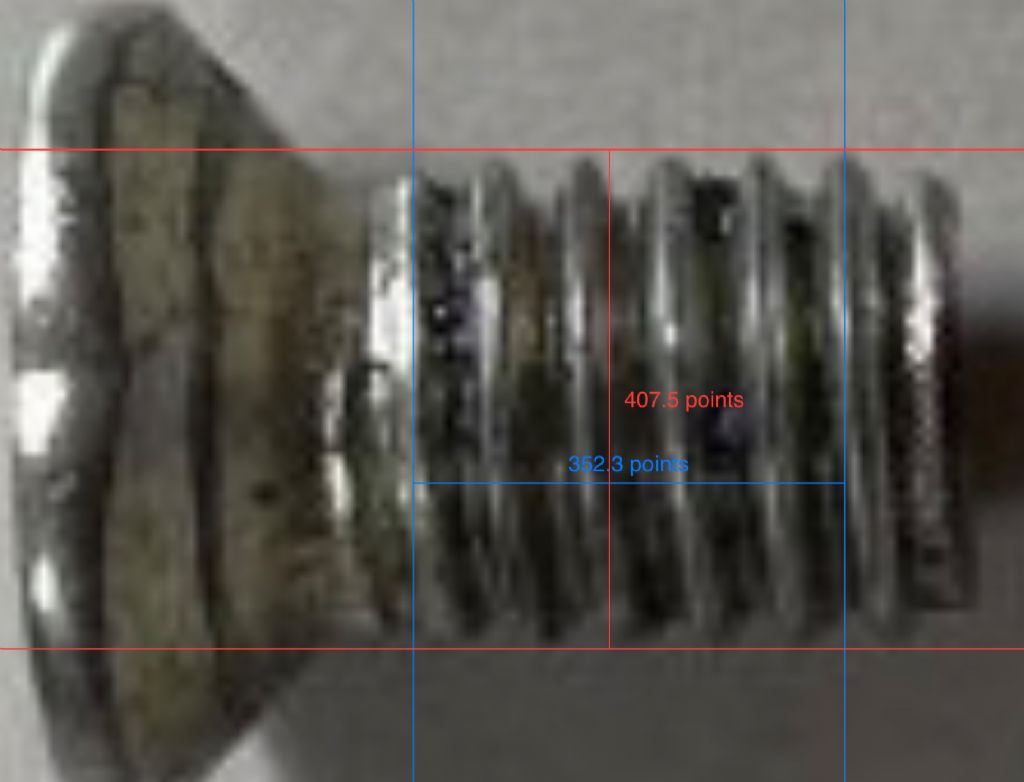

              Use a ruler! Looks like there are about 6 thread pitches on the screw. Measure across the six pitches, metric and imperial. Dividing one my t'other, and inverting for imperial, will give an estimate of pitch (metric) or tpi (imperial) to 5% or so. Could be metric, imperial British or imperial US.
              Looking at the height of the screw the pitch appears to be about 1mm aka ~25tpi. The diameter doesn't seem to agree with any particular thread standard, other than 7/32" BSW, which wouid be an unusual choice.

                  Bit undersize but Could be 6mmX 1mm. Try an ordinary m6 bolt in the thread and see if it fits. Order the right thread but in countersunk socket head HT and use an allen key..As to getting the old ones out, use a 1/4" wide cold chisel on the head to turn them.Tap them round with a hammer. Noel.

                        The usual form of damage head screw remover devices aren't terribly effective on this sort of screw. The head is too soft for the grooved wotsit to get a grip. It generally just cuts out a cone.
                        The only sort of extractor for machine screws and bolts that I've found to be anything approaching universally reliable are the grooved pin and hex turning device type sold by Rigid, Snap-On et al at seriously high prices. Drill the bolt, drive the pin in and around 90% of the time it comes out. Hafta accept that sometimes things will be immobile. Way, way too speedy for one job but I've had my moneys worth over a quarter of a century!
                        The tapered thread easi-out variety can work but are very hard and notorious for snapping off if you apply too much torque or are bit off-line with the spanner. Once snapped you have a really hard bit left stuck in the screw making the problem much worse as it can't be drilled out with normal tooling.
                        These days I just use a drill to take the head off in that sort of situation. I reckon your screws are M6 so 7 mm drill would do the job. With the heads off things can be separated and the sticking out stubs of the screws turned using a decent set of pliers. On relatively new stuff the threads are rarely jammed so the remains come out quite easily. Problem is usually due to the softish head being deformed when the screw is driven home by powered driver jamming it into the countersink. Slack fitting screws can cock over a bit inn then threads considerably increasing the amount of head jamming.

                          I'd also say metric, but the 5.69mm diameter is worrying.

                            A photograph blown up on a printer is a good way to measure pitch/tpi. Comparison of the diameter, to the length of several threads can usually provide a good estimate.

                                    Posted by Bo'sun on 29/07/2023 15:39:38:
                                    Cheap will be cheap.
                                    9 times out of 10 you can eyeball metric vs imperial, both UN and Witworth use a coarser pitch for a given diameter.

                                      STOP RIGHT THERE Margret. You don't need to be undoing those screws to get to the toolpost stud so don't worry about getting the stuck one out and put the other back.
                                      You need to wind the moving part of the top slide off the base and then you should be able to dribe the stud down & out
                                      My bet is they are poor quality M6 x 1 x 10mm long

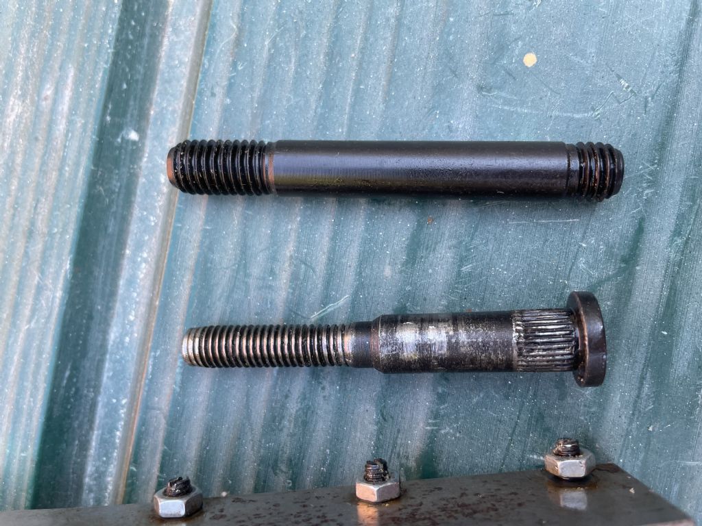

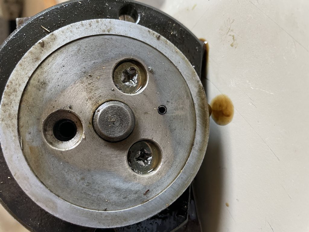

                                        img_5462.jpgimg_5461.jpgThanks everyone. Things are not going well!!!

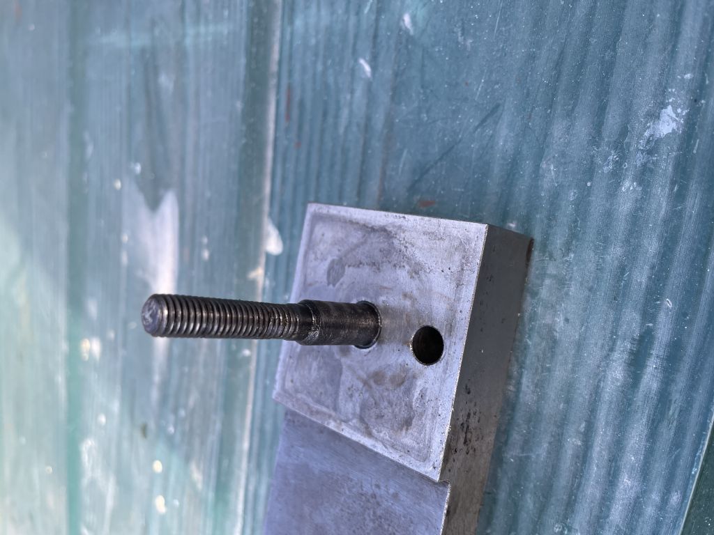

                                        Jason B – in my eagerness to get this sorted out – I took the advice given and used an impact driver. Just a gentle tap and both heads of the stuck screws sheared off! Your post hadn't come in about not having to remove this part – and now I am in a mess – big time!
                                        I can't get the round scale part off to even attempt to get to the now broken screws – the circular part won't wind off – is it that little pin device stopping it? How do I get that out?
                                        Also, I cannot budget that big stud. I have tried the two nut method, nothing. It seems to be threaded into the cross slide – is that correct? – it just will not budge.
                                        Oh dear – I am so stuck! Help!

                                          SOUNDS as though loctite has been used. Some heat will cause expansion and the loctite will give up. Do you have a small blow torch ? As Jason says it should be able to drive it out – put the nuts on the top to protect the thread. Noel.

                                            Hi Noel, thanks for the reply. I took your advice and added a little heat and gave it a small tap and it popped out. Yey!

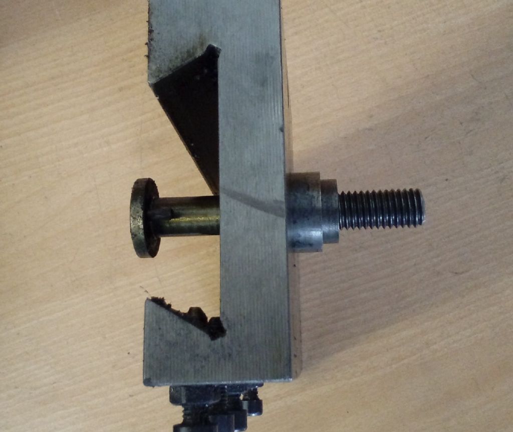

                                            But now I find the two posts are different! The one in the kit is threaded both ends – have I purchased the wrong kit from arceuro? The one on my lathe is a push in fit, the kit one threaded. (My lathe is an Amadeal CJ0623b if that helps?). The videos I watched on ebay it was a straight swap! crook

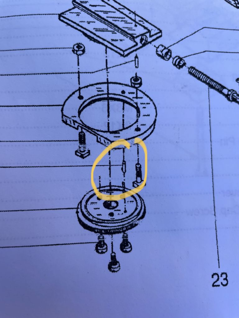

                                            Also, I have identified the little pin which seems to be stopping the circular part from moving. How can I remove this please?
                                            I am at my wits end! I wish I hadn't bothered and stuck with the 4-way tool post.

                                              Some but not all roll pins on teh far eastern machines have an internal thread so you can put a screw in and then pull on the screw but not sure if your one will.
                                              Not sure it screws together anyway
                                              #654302
                                              DiogenesII
                                                @diogenesii
                                                Try holding the dovetailed part, and gently tapping on alternate sides of the ring with a bit of wood, see if the round base will 'walk' off the boss and roll-pin a little at a time..

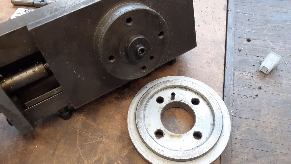

                                                  Although my lathe is larger I went and had a look, after removing the four M6 cap head screws a few taps with a copper hammer had the base ring off, it was just being held by the roll pin. I suspect the pin is only there to make sure the ring goes back in the right place as it carries the angle scale for setting the topslide at an angle.
                                                  As for the stud can you post a link to the ebay listing with the videos, I suspect you were looking at ones sold for Mini-lathes which have athreaded hole for the stud, your sis a slightly larger machine.

                                                    Given the size of the photo, this is ludicrously ambitious, Margaret … but it will serve as an example of how you can measure the thread
                                                    This is a crop of your photo, with point-counts added :
                                                    Use the vertical dimension to calibrate your Calliper measurement, and then you can see, on the horizontal scale, the distance occupied by five threads.
                                                    A brief pause for some arithmetic might soothe the troubled mind !
