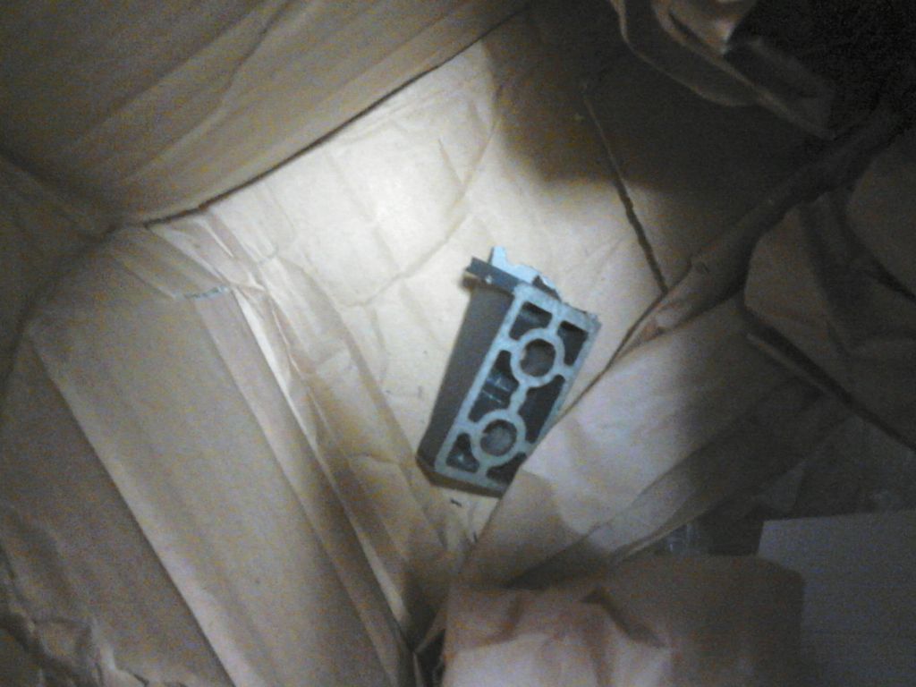

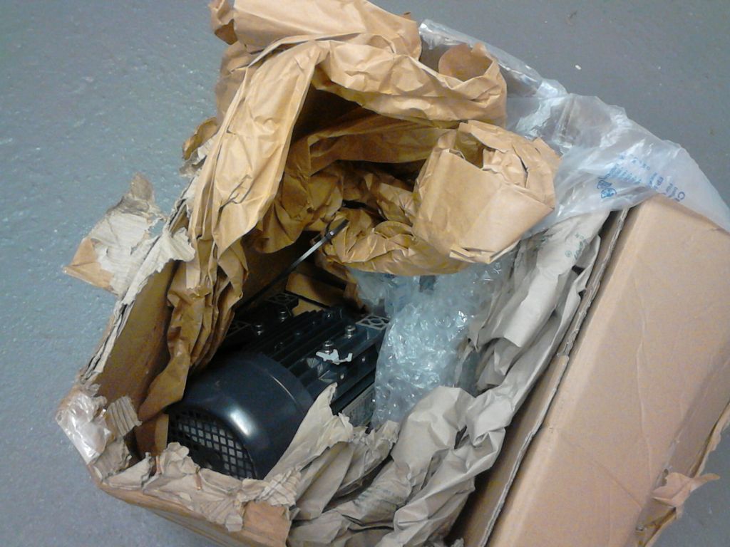

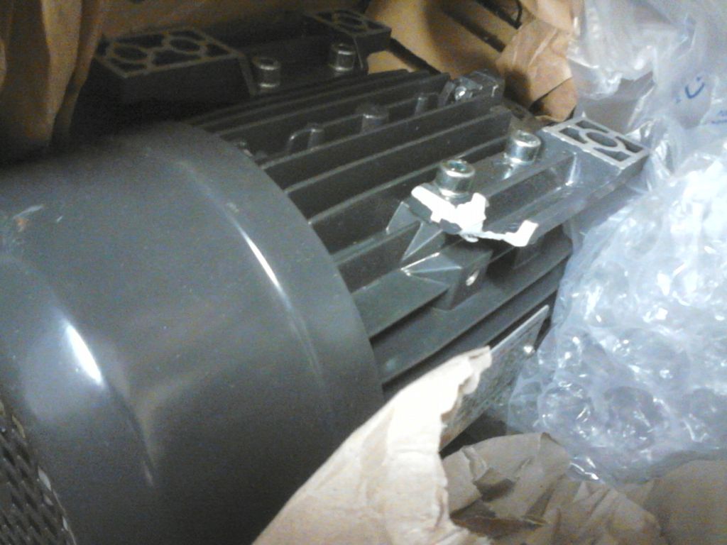

      dsc_0018.jpgdsc_0017.jpgGreetings All,
      I arrived home today to find a parcel waiting for me. The condition of the box immediately gave rise to concerns.
      As I suspected the parcel was the motor and inverter I had been waiting for from RJW Engineering.
      The inverter was boxed up separately inside and turned out to be fine. The same could not be said for the motor. It seemed to have just been thrown into the box.
      The photos above tell the sorry story. One of the motor's mounting feet has broken off, presumably down to the motor bouncing around in the box. I found the broken portion of the foot in the bottom of the box.
      I'll be contacting RJW in the morning. I'll let you know how I get on.

          I had to sent a fairly large motor by UPS recently. I bolted the motor onto a piece of 12mm MDF that exactly fitted the inside of the carton that I had reinforced with extra tri-wall cardboard internally. I used lots of expanded polystyrene on top of the motor to prevent any vertical movement. all carton flaps were sealed down with hot melt glue. Lots of parcel tape was used around the outside. The motor arrived in perfect condition due to the method of packing that provided adequate protection and prevented the motor from moving within the carton.

            Looks like that foot is bolted to motor casting..if no joy for replacement motor maybe accept foot only. .

                Quite a force needed to break that foot off, so what unseen damage to the motor internals?
                I'd be very reluctant to accept just a replacement foot.
                A new motor is what I would be wanting.

                  Thank you for your comments. Lambton, I think you should be working for RJW Engineering in their despatch department.
                  Not shown well in my photographs was the damage to the fan cowl as well as the foot. I can well understand that things get knocked about in transit, but had the motor been adequately packed the damage would not have occurred.
                  I have just got off the telephone with Mike Thompson, RJW Engineering Sales Engineer. He is looking into what happened at their end, but the long and the short of it is I will be getting a new motor.
                  I should get a call from him this afternoon, so I will keep you posted.

                                                  Good point. As you can see from my photo my motor was "packed" for transit in this way. I did not move the motor but took the photo as I found it. Camera phones are a great development!

                                                    I tend to agree with Ouballie, the electric motor internals are not as robust as one might think, a good clonk, even from a small height can cause a motor to write itself off.
                                                    Most motors have quite heavy rotating masses and to enhance performance, close tolerance clearances are employed. If the internal clearances are affected, then low performance or damage through additional heating may reduce it's life considerably. Not to mention vibration that not only reduces the working life of the motor but , in an extreme case, may affect any close tolerance work being carried out. The fact the one of the mounting feet was damaged may have saved the rotating assembly but the choice is yours, I would return for a complete new motor and insist that the motor is packaged as described in one of the earlier posts.
