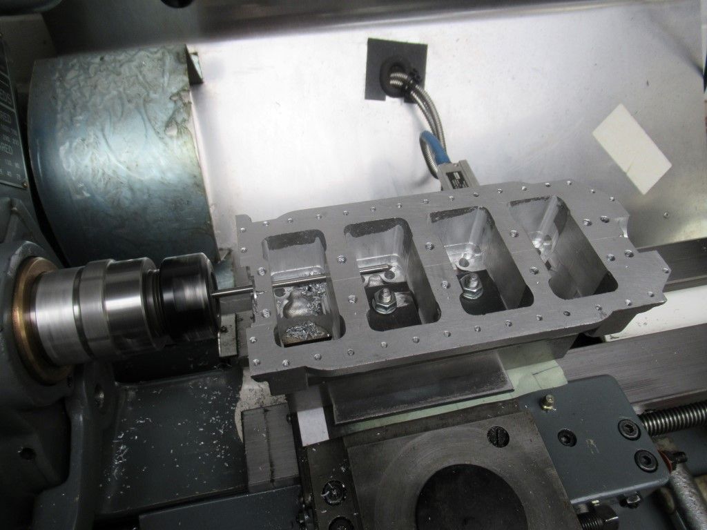

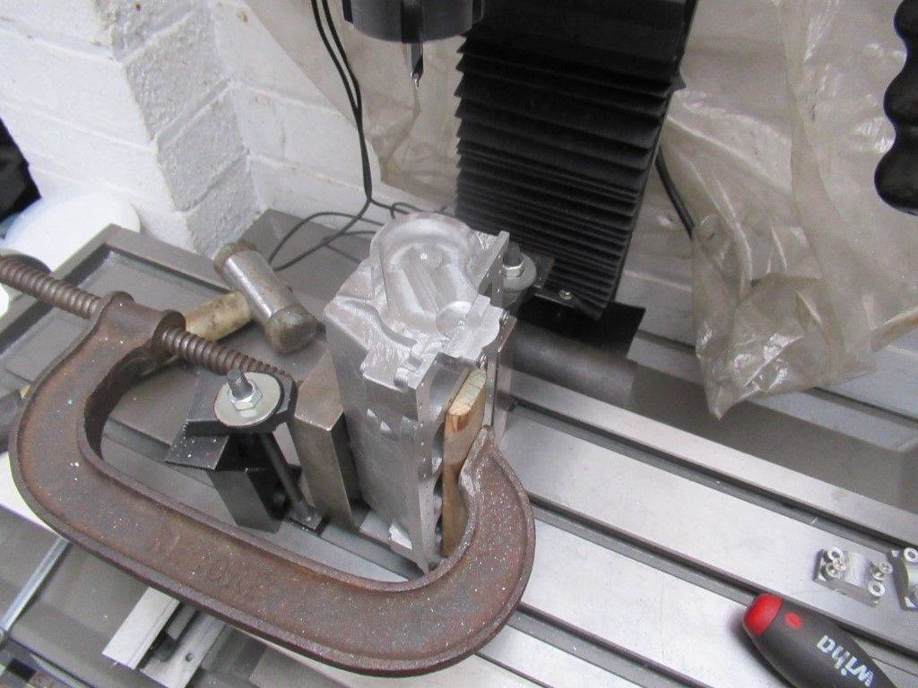

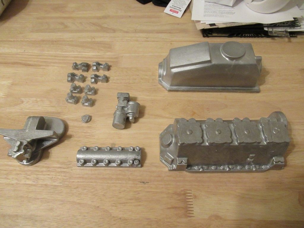

      I was going to do a full build thread but time and forgetting to take pictures as I went along means it will be more of a quick build.

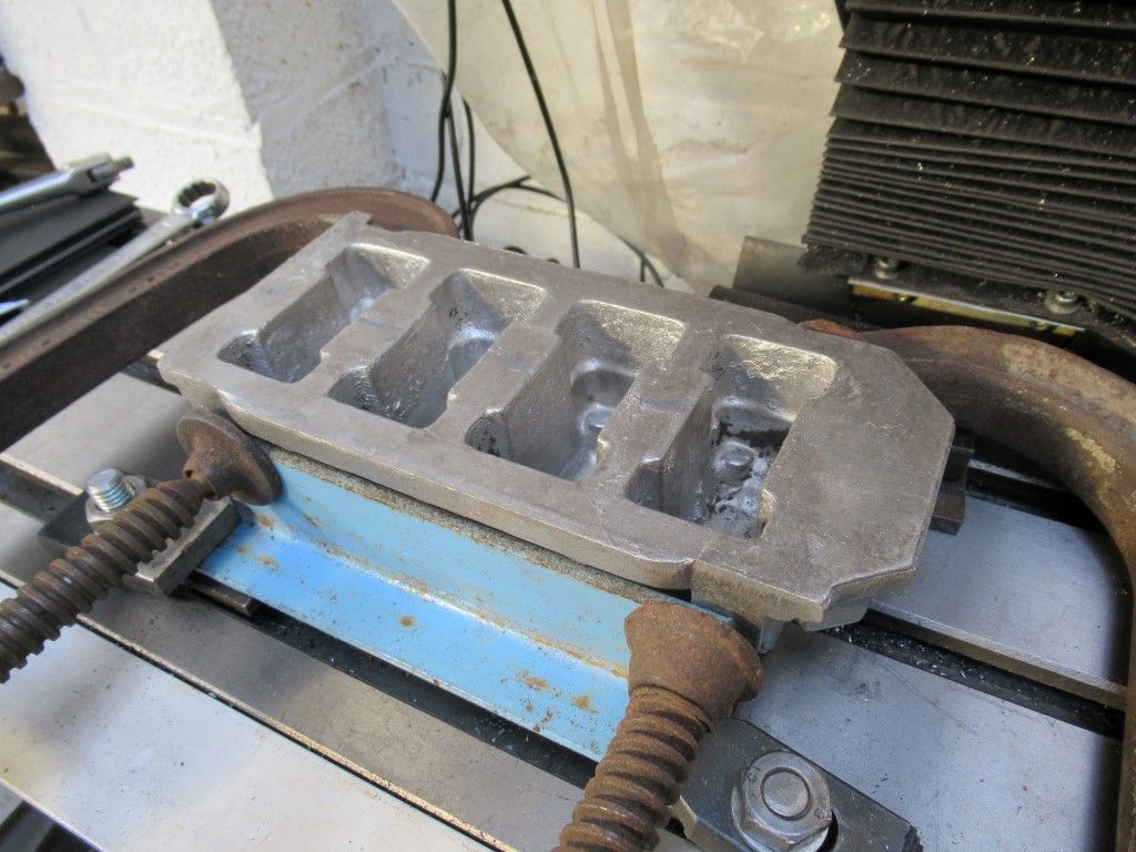

      So i purchased these castings second hand complete with plans ,

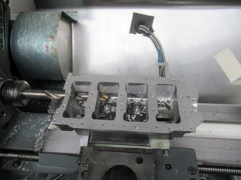

      It took me a while to decide where to start but eventually took the plunge and started to machine .

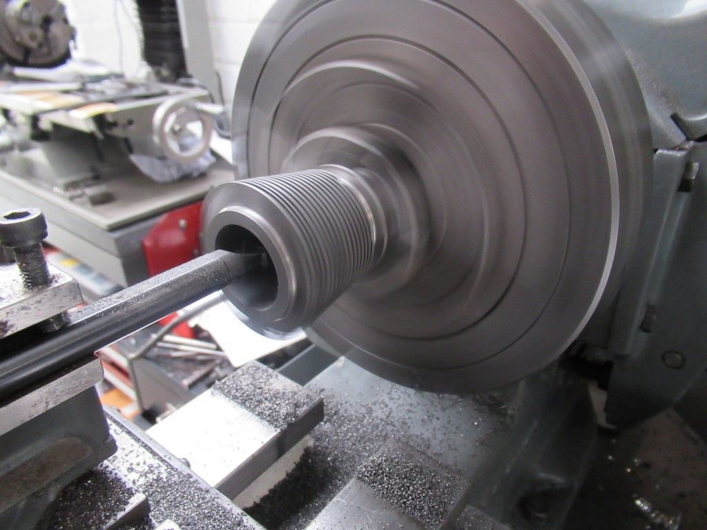

      Boring through for the cylinders

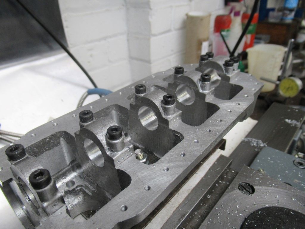

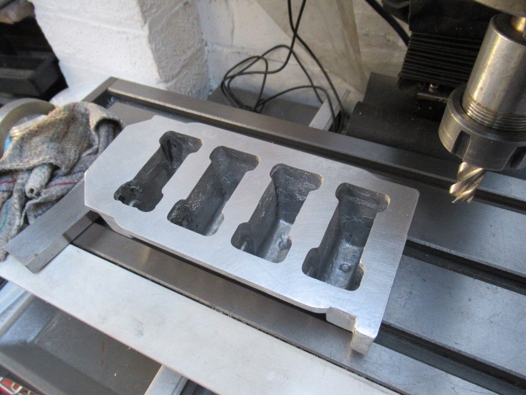

            more machining of the end plate
            Using an extra long centre drill to mark through for the camshaft
            Then open out using standard drill bits
            #454884
            David K
              @davidk77137

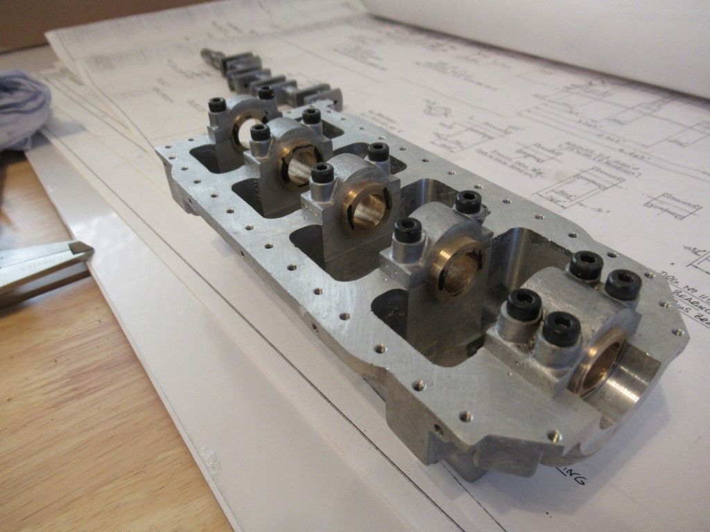

              Then the same for the main bearings but finished off with a home made boring bar
              #454885
              David K
                @davidk77137

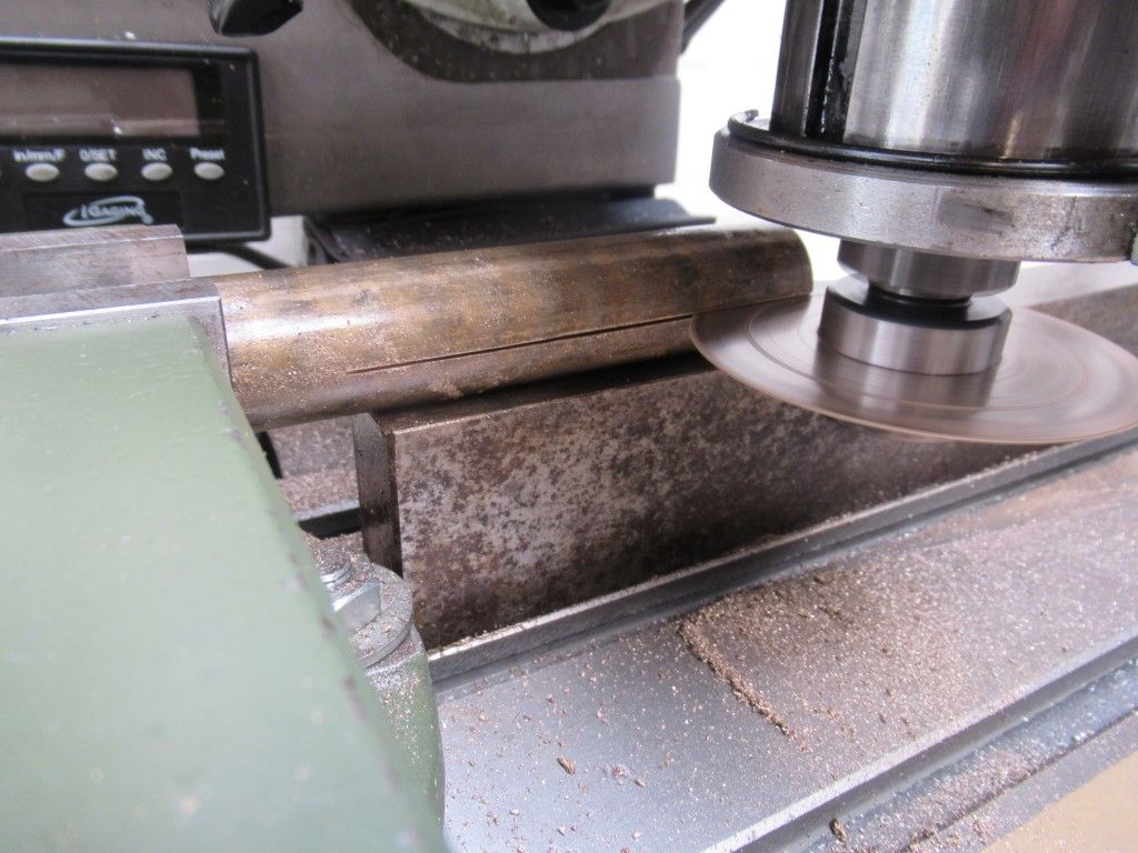

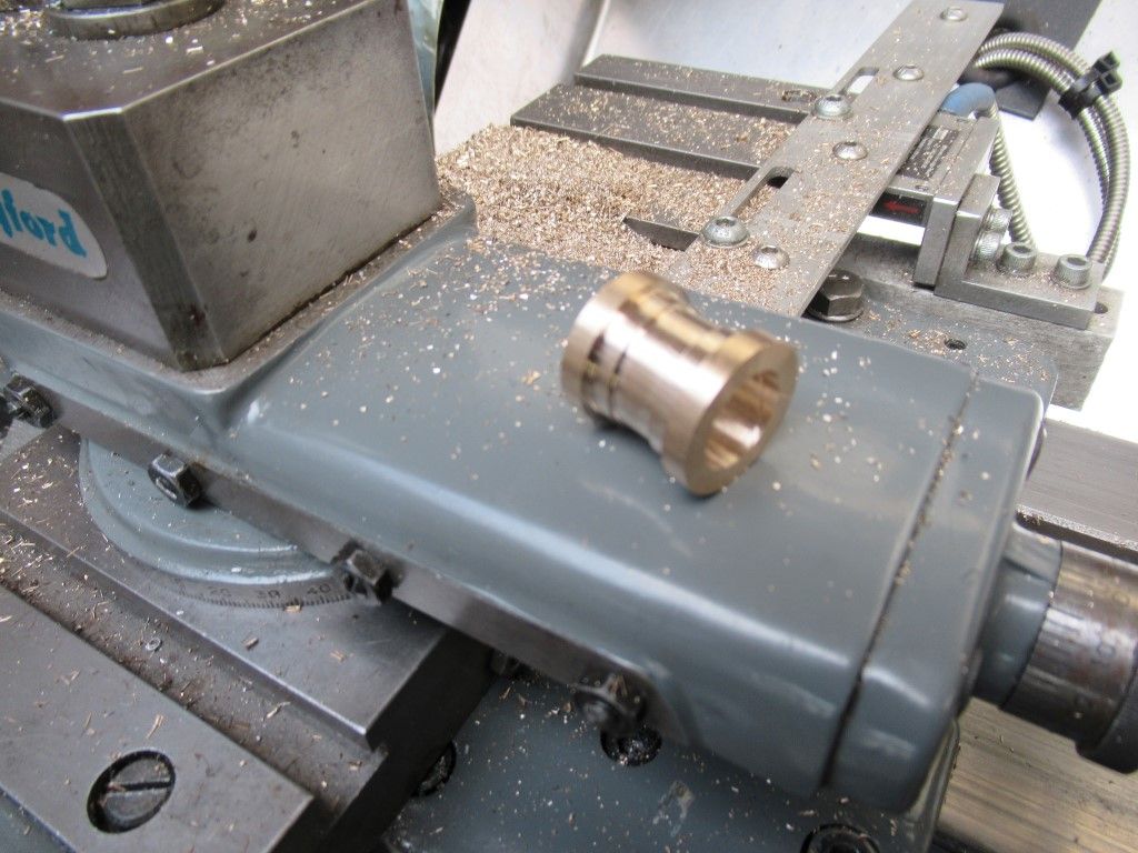

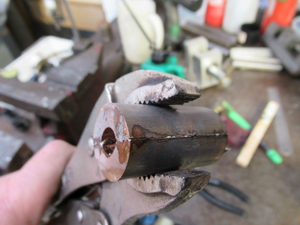

                Sitting a piece of bronze for the main bearings
                I soldered the two halves together before machining, if I was to do it again I think I would use super glue.
                Machined then heated and split again
                trial fit

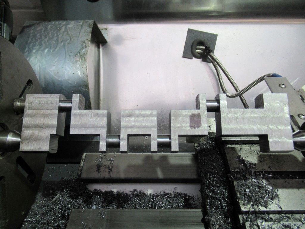

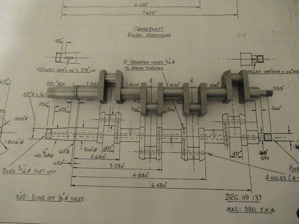

                    I couldn't find a reasonably priced piece of flat bar for my Crankshaft so I ended up machining
                    some round down to size
                    I milled out the basic shape
                    Then transferred to the lathe and machined the bearings. I made some spacers to fit into the gaps between the crank webs but they seem to have disappeared in this picture

                      I bought some extra long drills to put in the oil ways
                      Finished crank needed minor alterations to fit into the main bearing caps

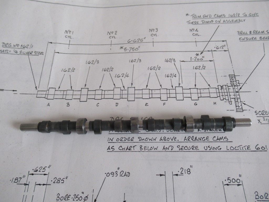

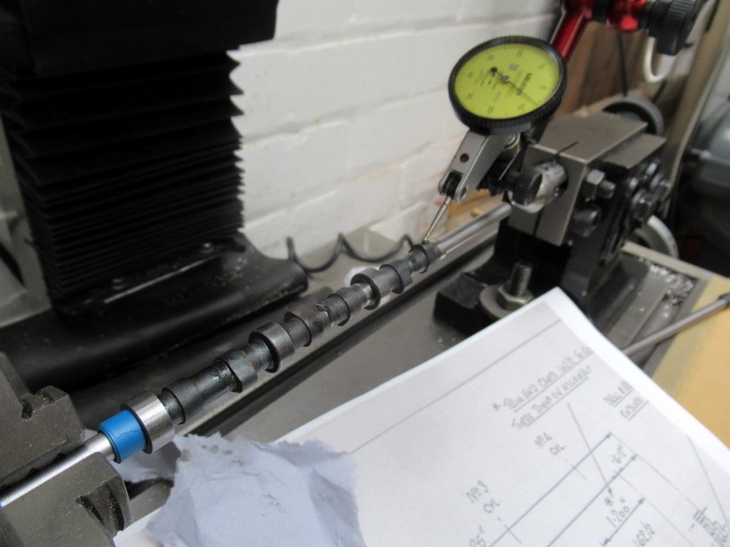

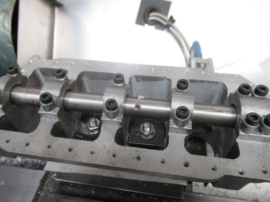

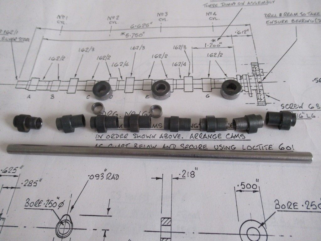

                        Camshaft lobes being formed on the mill and rotary table
                        Lobes , bearings , spacers and shaft
                        Loctite the camshaft parts using rotary table and Dial gauge to set lobes
                        Finished camshaft

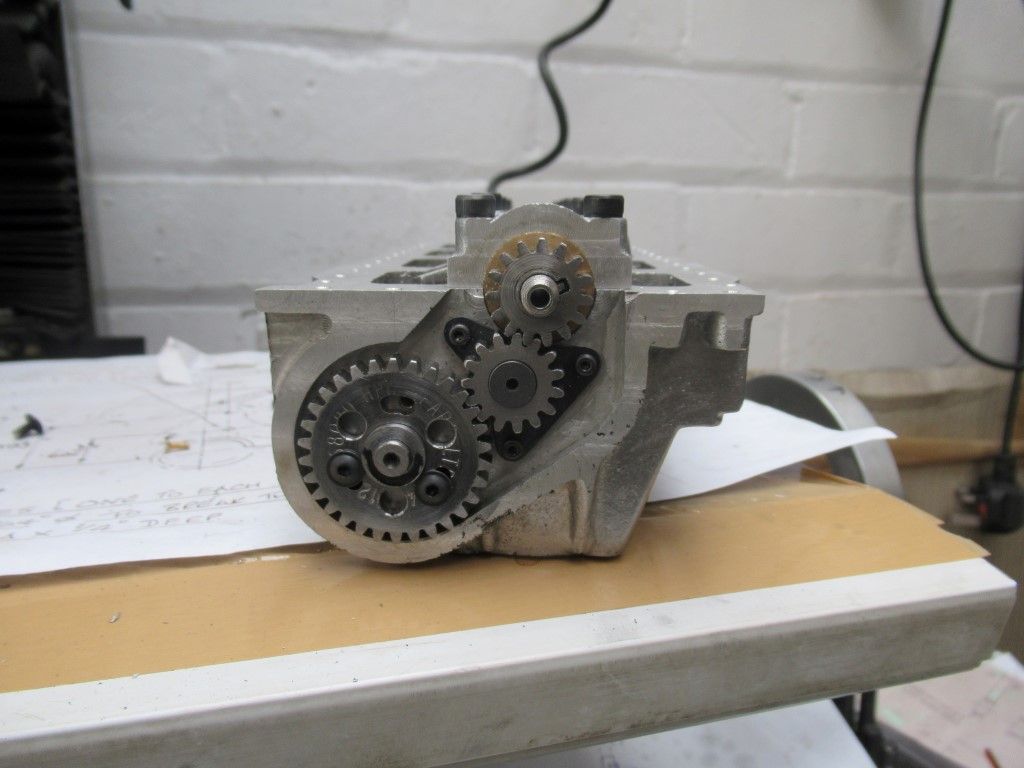

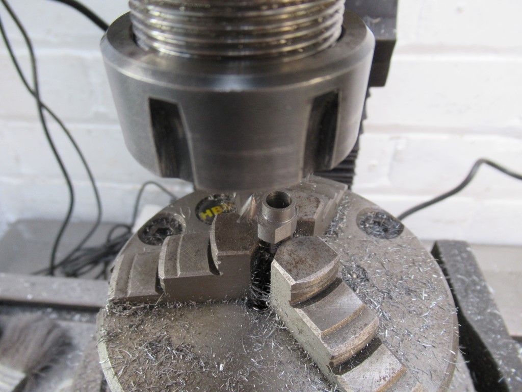

                          Machining shop supplied cam gear
                          Timing gears with idler gear

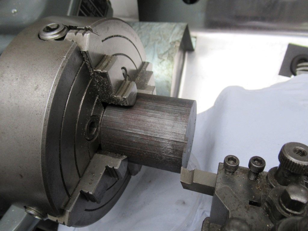

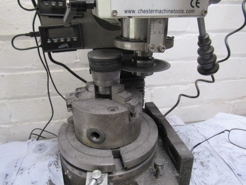

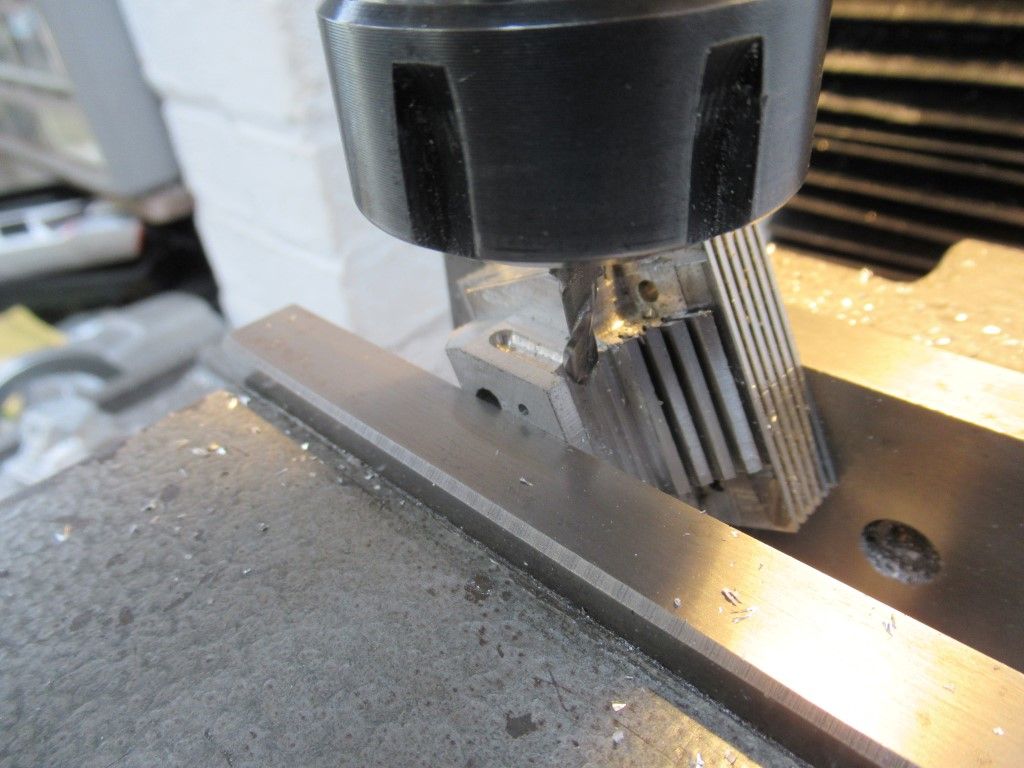

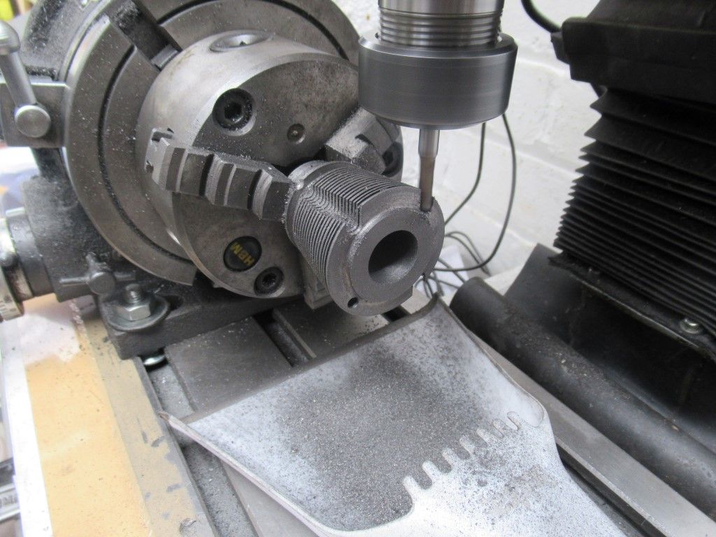

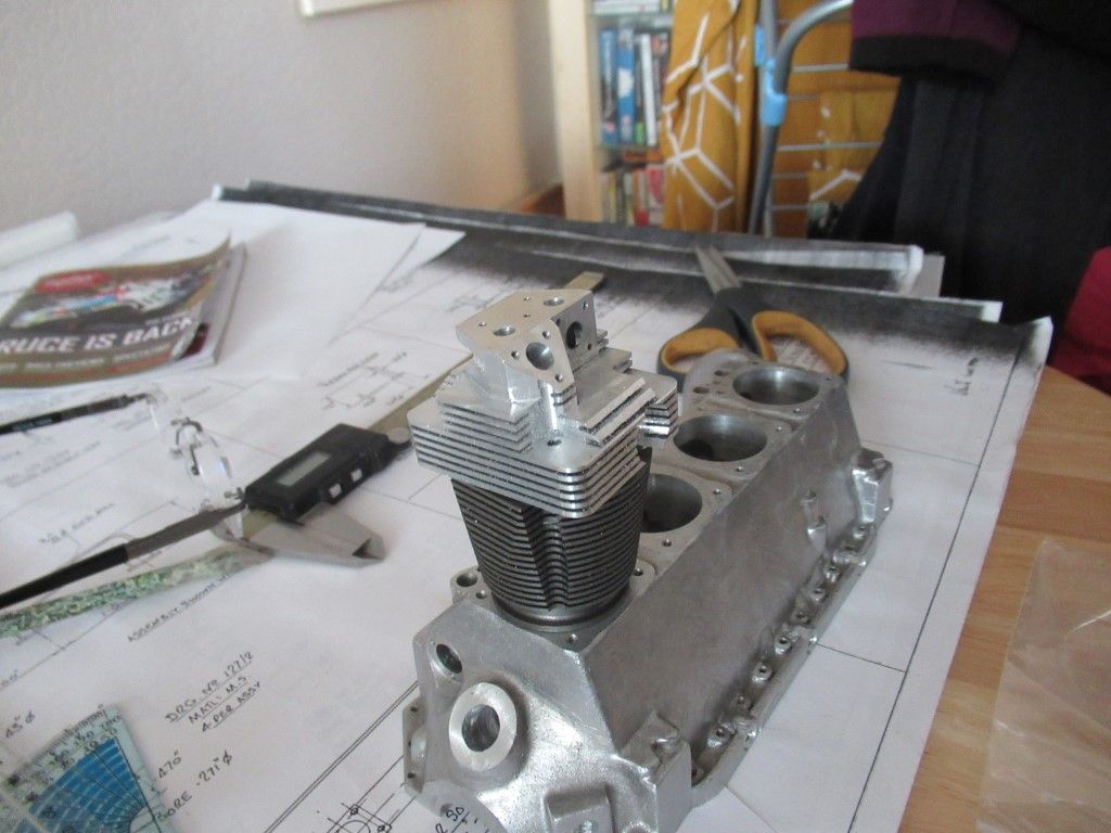

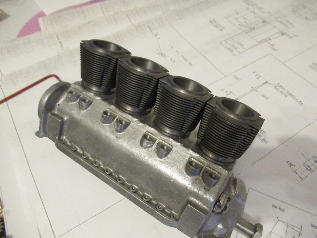

                            Cast iron blank ready for machining to shape for cylinders x4

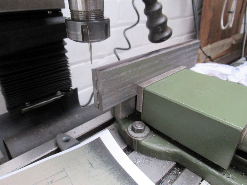

                            Cutting the fins with a slitting saw, hated this job , everything was covered in black dust including me.
                            Recess for the cylinder studs
                            #454911

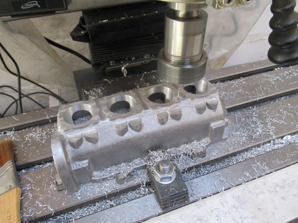

                            David K
                              @davidk77137
                              Boring the cylinders
                              Finished cylinders

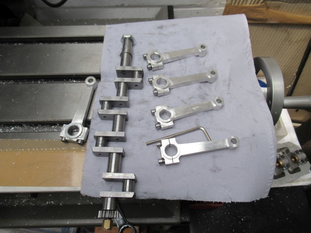

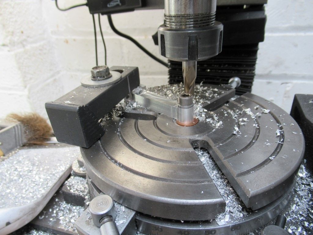

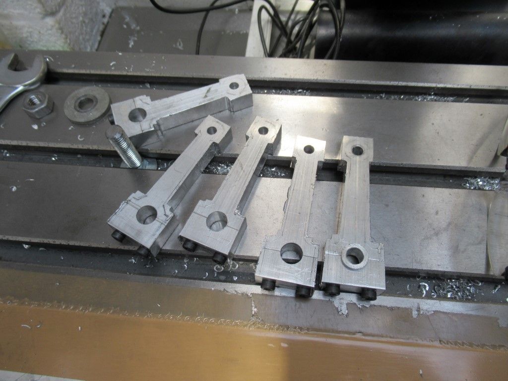

                                Conrods basic shape
                                forming the rods on rotary table
                                Finished rods

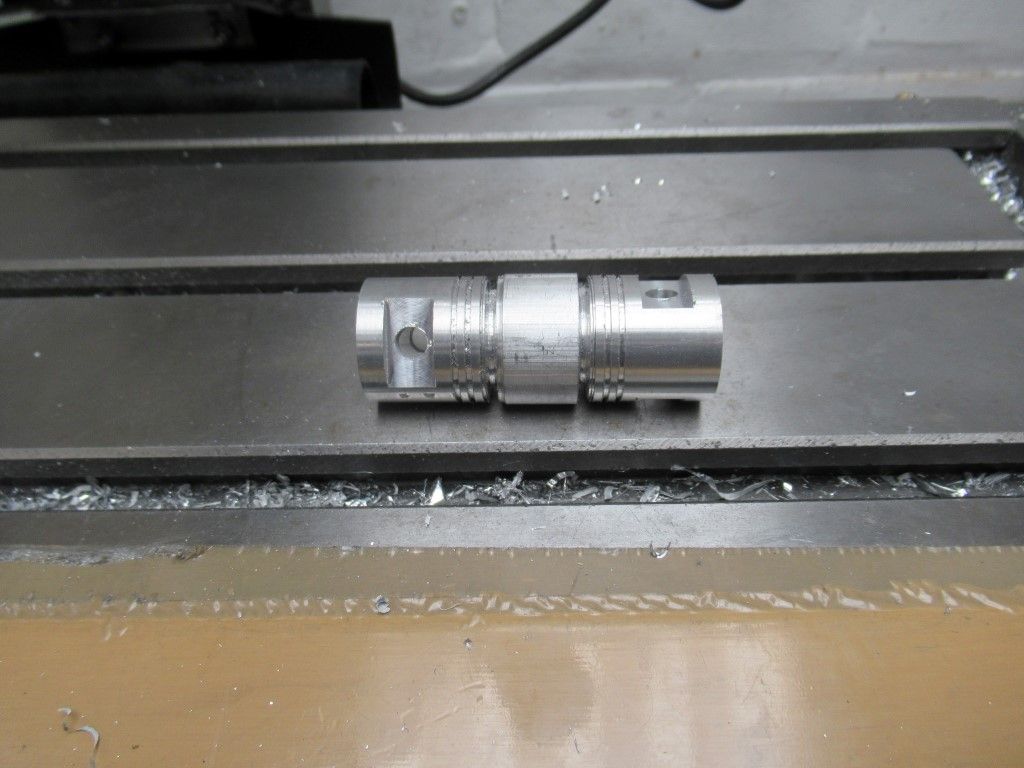

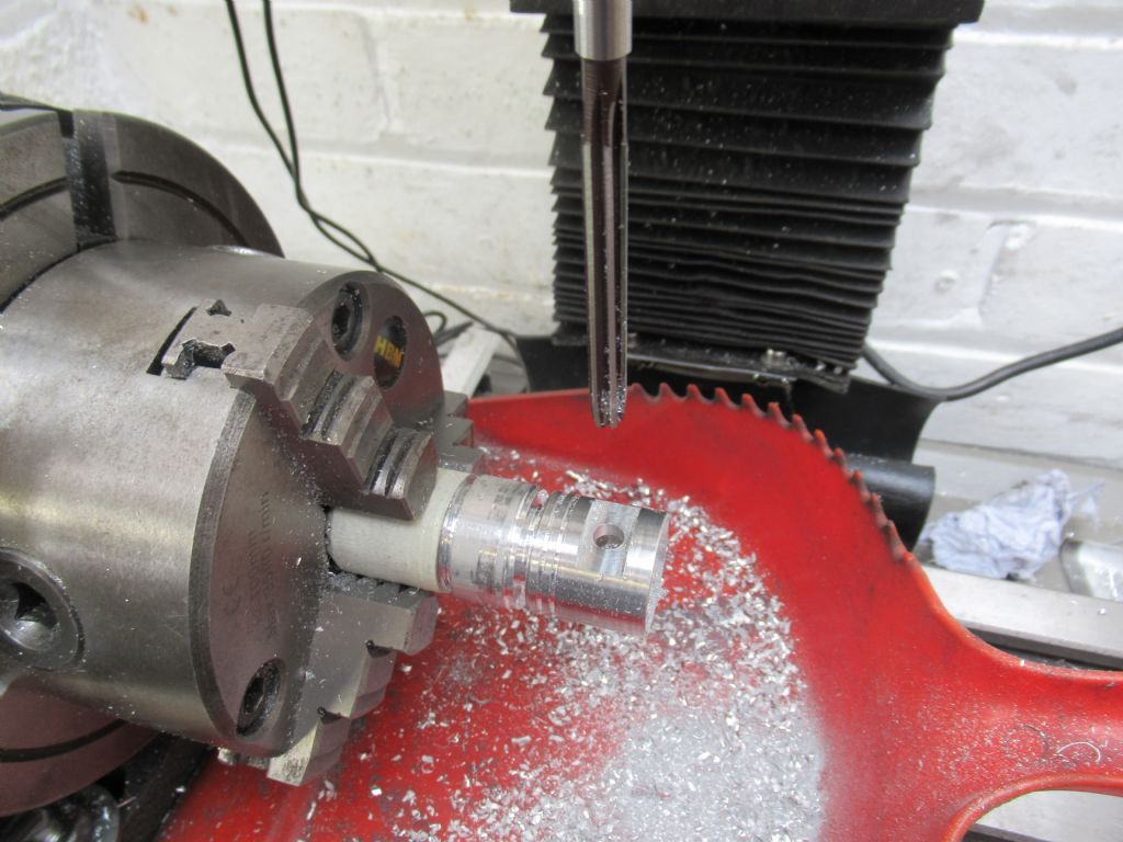

                                  Turning the pistons
                                  Milling the cut outs and reaming the gudgeon pin hole

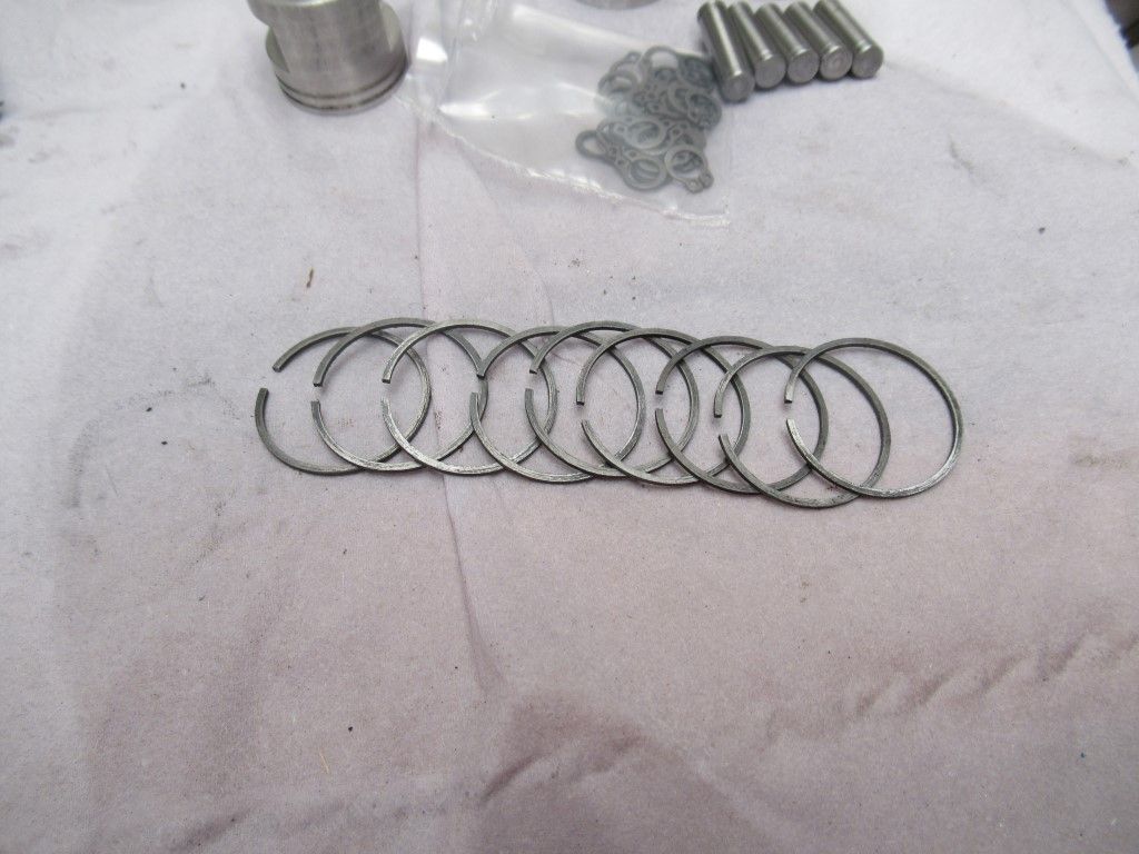

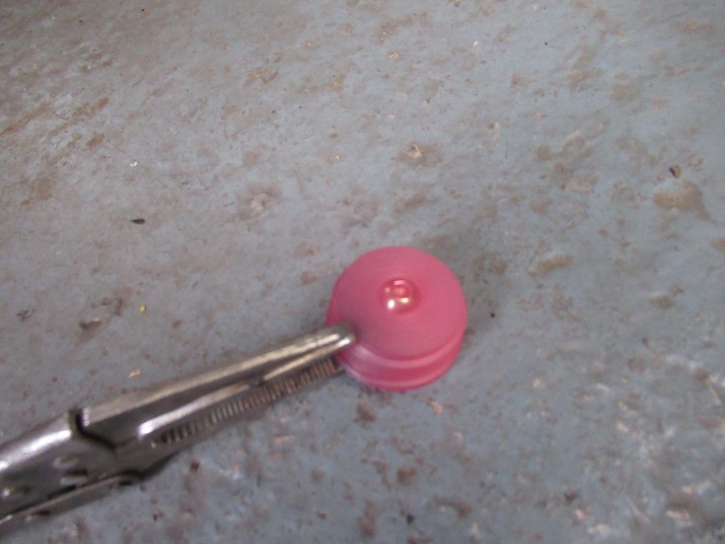

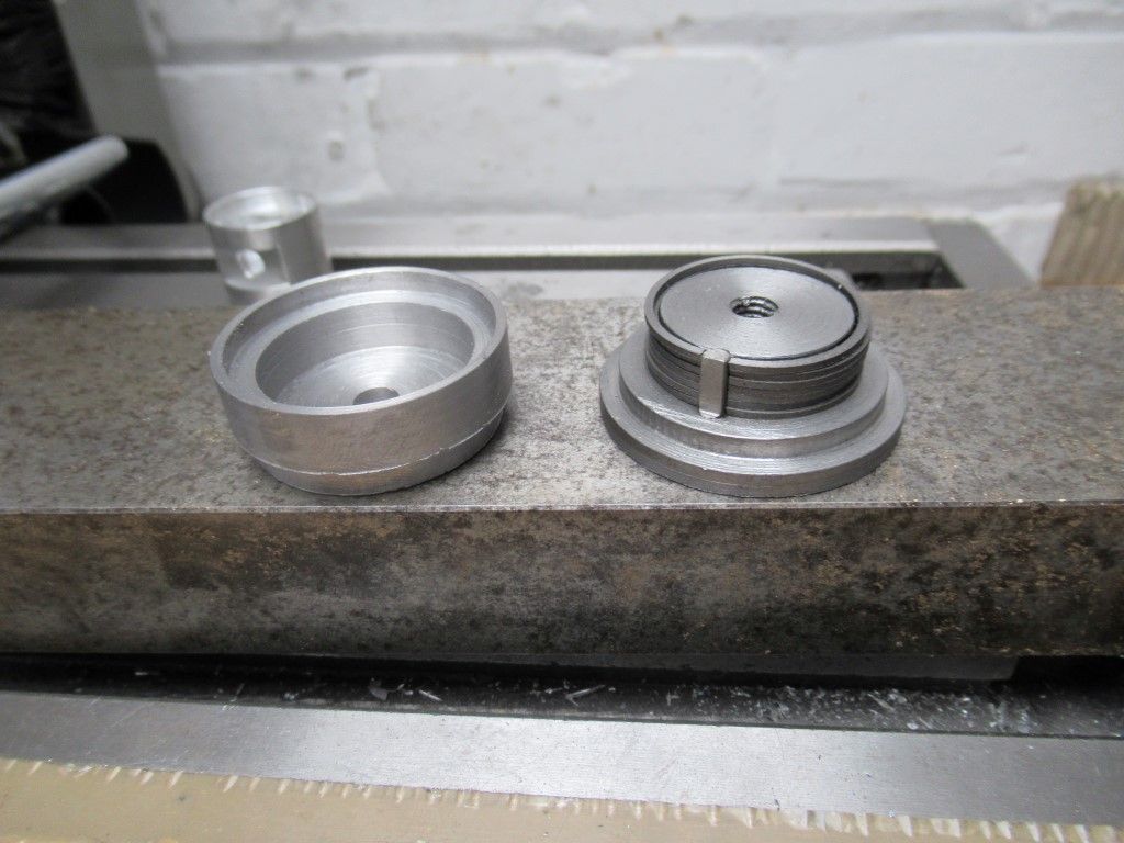

                                    Parting off some piston rings from cast iron
                                    Made a small oven to set the ring gap
                                    Heat to cherry red
                                    rings before fitting into cylinders and adjusting ring gap

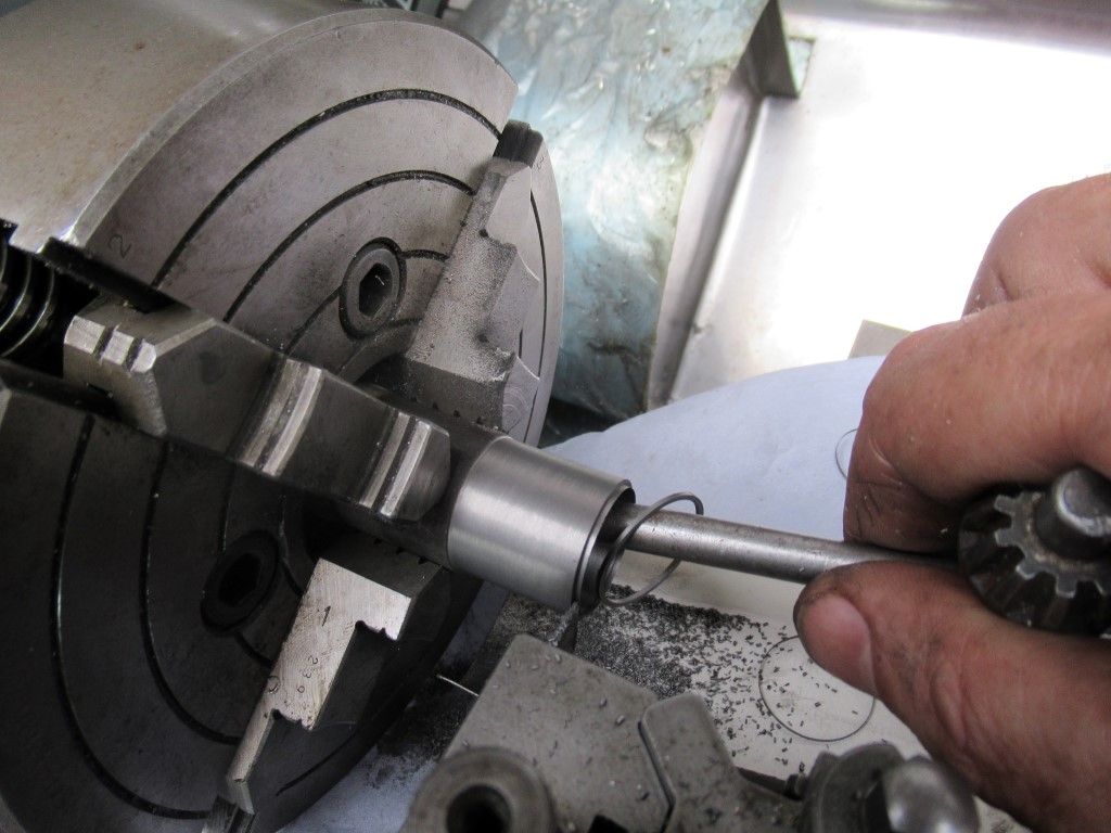

                                      Enjoying your posts David. Could you please explain how the holder for the shop bought gear works please? I am still very much a beginner and have some gears to alter for a clayton steam wagon differential. Many thanks John
                                      #454975
                                      David K
                                        @davidk77137
                                        Hi , that piece of Alloy I used was in fact an older jig I had lying around from a previous build.
                                        I had cut the four slots so it compressed slightly on my four jaw chuck in my lathe.
                                        As for the gear , all you need to do is turn a recess slightly smaller diameter than the gear and then tap the gear in with a soft mallet. The steel gear will slightly cut into the alloy as its tapped in and this is enough to hold it tight.
                                        Remember to bore a hole through the centre of the jig so you can drift the gear out when finished.

                                              Hi JA, Just looked at the date on my first pictures and it seems I have been working on this for just over a year.
                                              Must admit I did not think it was this long but I do tend to make one part or so then take a break.
                                              I believe the castings were made by a ' Les Chenery' , I know there are a few around but rarely come up for sale.
                                              The castings are good , a few small 'blow holes' have appeared but nothing to cause problems. I have tapped a lot of small threads into the casting and they seem to be holding up so they must be pretty good..
                                              Drawings are very good , a few decimal points on the dimensions have been in the wrong place and there are a couple of mistakes but so far the build is going well.
                                              The castings were quite solid and I have removed a lot of material from them , the only place were the material has got a bit thin is the side wall next to the camshaft bearings and cam followers. If I could start again I would move the crankshaft a few thou over to one side which intern would give a bit more camshaft clearance.

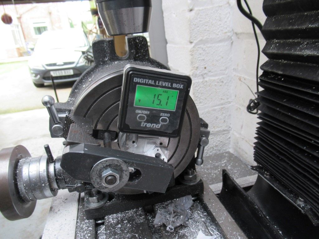

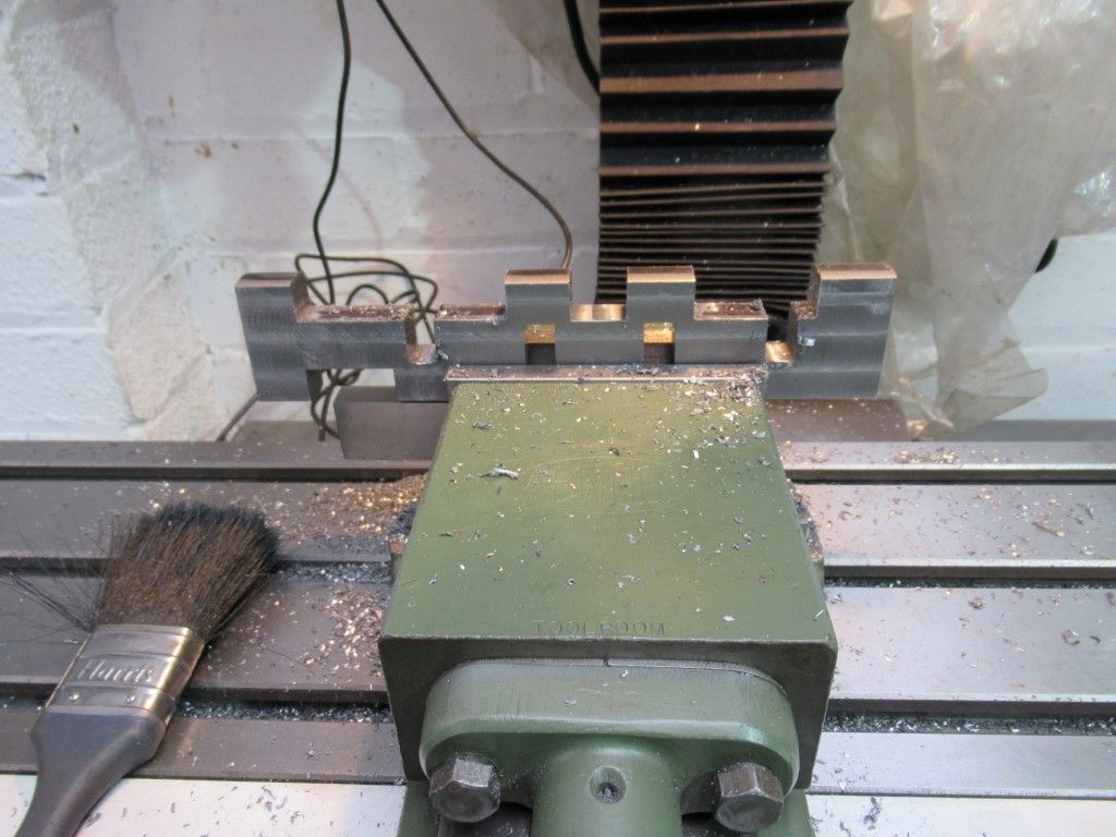

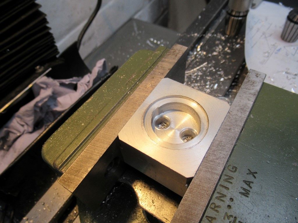

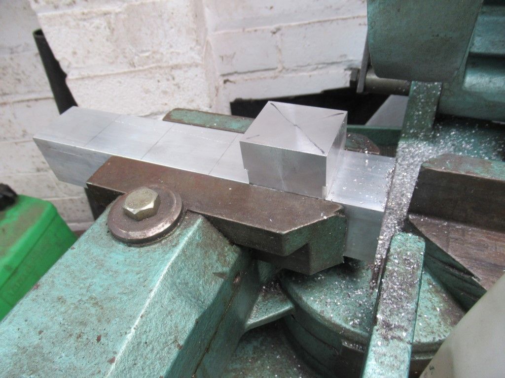

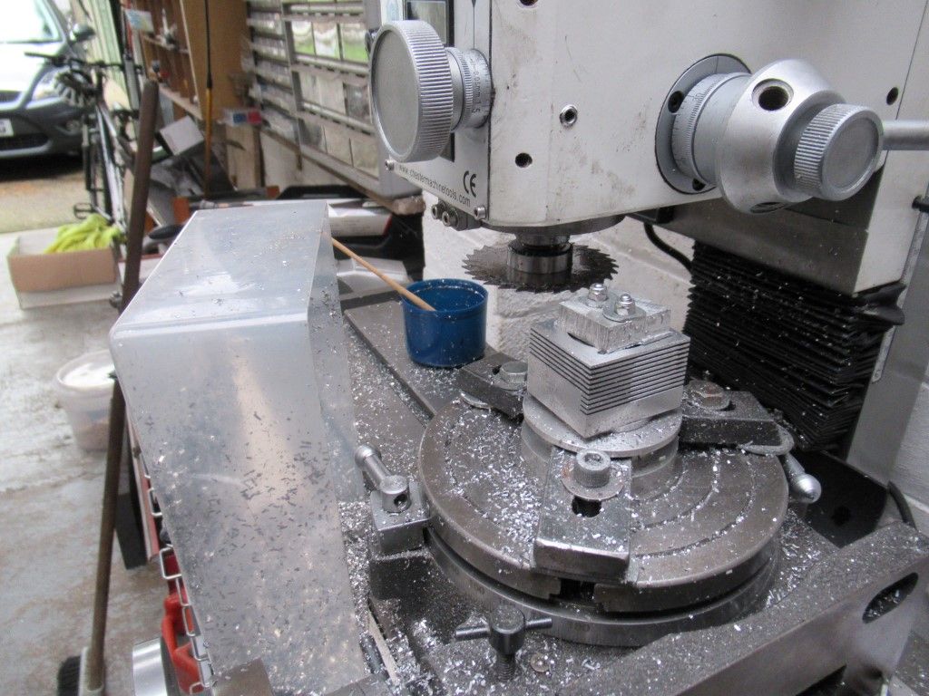

                                                Turned the combustion chambers on the lathe thengypsy (42).jpg moved to the mill to drill and cut the valve seats.
                                                Cutting the fins was more problematic than the barrels, I found it better to use no fluid and to cut in the same direction as the saw , 'climb cutting'
