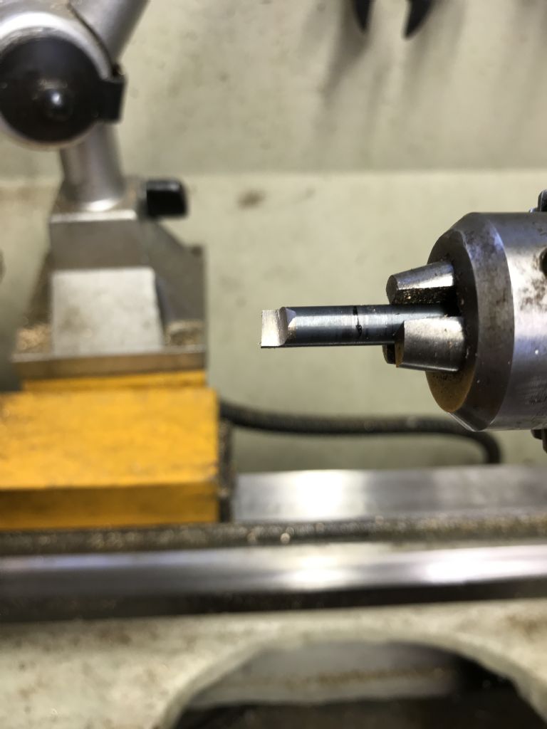

      I have never made a D bit so I thought it was about time I had a go. I ended up using a 1/4" hss drill bit. After cutting all the fluting off I gently ground the bit until it measured up to what I needed. Square on the end and exactly half the diameter. The half diameter being flat to the axis of the shank.
      So should I counter bore the hole to just short of the finished hole depth and say 3/16" diameter or should I just go straight in with the D bit?

          For best results treat it like a reamer, leave it 1/32 or 1/64 to remove.

              The advice always used to be that the D of the D bit should be a couple of thou greater than half the diameter so that it cannot cut on the side and produce an oversize hole.

                  Assuming a flat bottomed hole is required the non-cutting half at the end of the D-bit should be relieved, otherwise one side will cut and the other side will rub. If one is not worried about exactly flat bottomed the whole end of the D-bit can have a slight chamfer.
                  The hole should be predrilled undersize, but generally no need to bore. If the D-bit is properly relieved it acts as a fairly stiff boring tool.
                  Errr if the D-bit is made from the shank of a drill the shanks aren't normally hardened.

                    Hi Andrew, its only cutting PB1 so it should be ok. I think the relief might be a good idea.

                          And don't grind the shank down too far beyond the flutes. Most/many drill bits have a soft shank welded to the HSS fluted section.

                            I chose a quality bit to try it with and cut the flutes to leave solid metal.

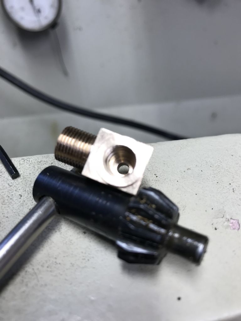

                              Ok here's the results of my efforts.
                              PB1 material. I still have to clean up the edges and round the back off to suit the existing ones.
                              The seat has not had the ball seated yet as i have to make a guide for the punch.

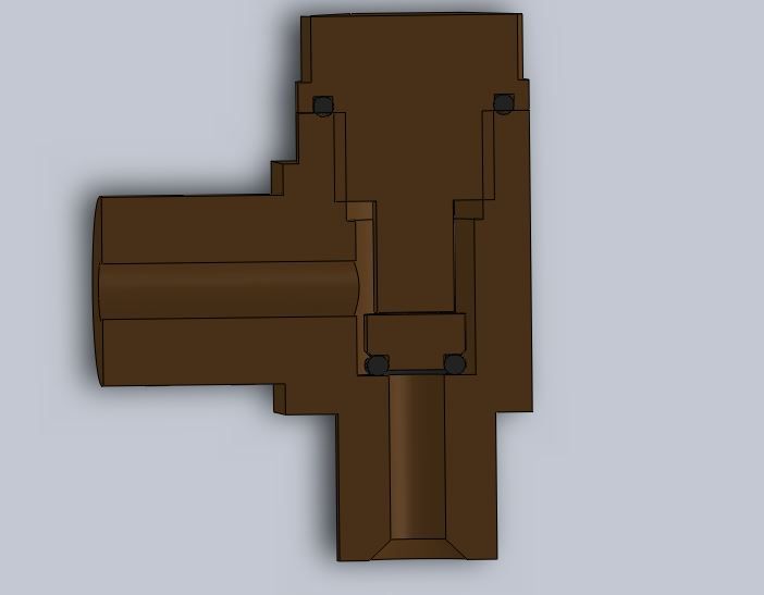

                              A fellow forum member very kindly sent me some drawings of his valves with O rings fitted. I have drawn these up and if i am not happy with the ball method i will be converting them to O ring.
                              6MM D Bit
                              I still have some parts to make before i can test them, new top cap etc.

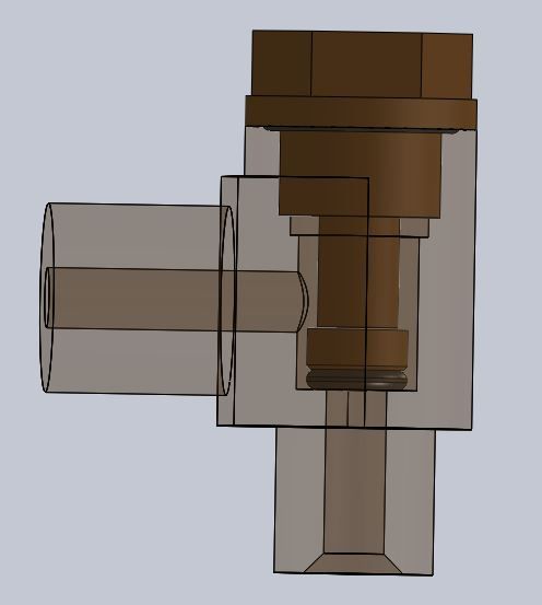

                                That O ring check valve looks interesting. Is the O ring mounted on a spring loaded plunger?

                                  Hi. The o ring is mounted on a small spigot to stop it wandering the spigot is just over halfway through the o ring and to the same shape. It needs about .2mm to squash down
                                  Hope that helps.
