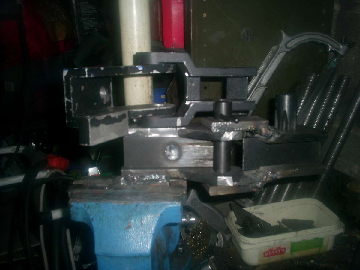

              The bottom line is (Ian etc) the main casting is made of an aluminium type casting on all these kits.
              If you want a really good tough lifetime use higher capacity versatile bending unit then you will need to fabricate/weld your own "castings" from bits of steel using the original as a guide
              I would also put a roller option on the end of the ratchet
              This kit takes a lot of the mystery out of building your own metal forming tools

                                      #707400
                                      Ady1
                                        @ady1
                                        I finally got around to uprating the original aluminium cheese unit and fabricated one in steel, finishing the main fitments today
                                        Still got to do a few things to finish it off though…
                                        there’s always just-another-thing isn’t there…
