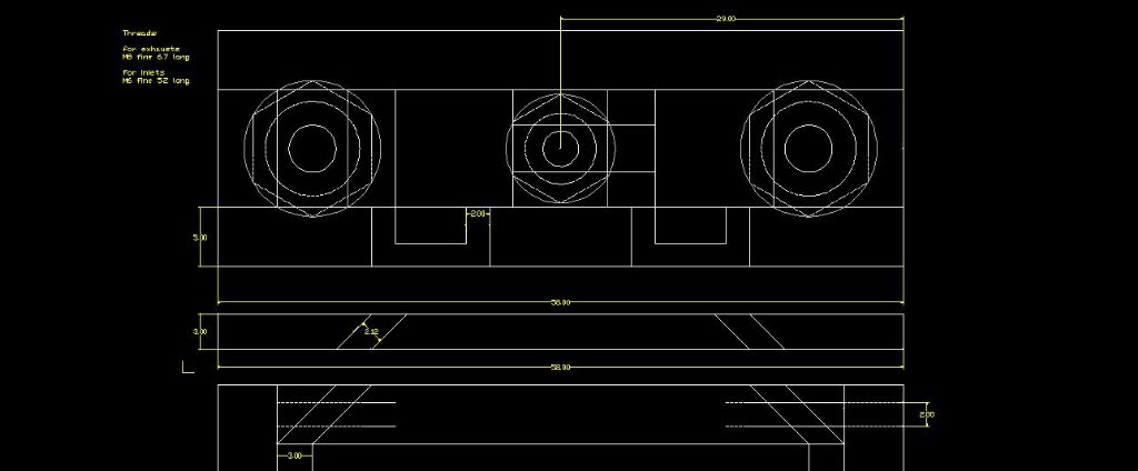

      Here are the first of the plans – in this case for the cylinder heads for the engine. I exported them from DraftSight in JPEG format which is the only format that this site allows images to be uploaded in and I thought might be the easiest format for people to view. They aren't as clear as I'd like and it's necessary to right click, view image then zoom in a bit (Ctrl key and scroll middle mouse button) to read them (the colours also appear faded after uploading so it's difficult to tell the difference between white lines and grey layout lines). They look much clearer in SVG format.

      #101922
        I've never run o rings or teflon in an iron cylinder so can't comment except to say there wa sobviously a reason they were not specified on the iron cylindered engines that I have made.
        Two comments on the drawings.
        1. cylinder covers (not heads) look very thick, its not dimensioned but the bolting flange looks to be 6mm thick where 2.5 – 3.0mm would be quite adequate on a 30mm dia cover, also the spigot going into the cylinder can be shorter as well.
        2. your drain cock holes will leave the hole in the middle of the cock above the base of the cylinder, move them down and cut a notch in the spigot like you have done for the steam port.

          Hi Jason,
          I'd seen o-rings in cast iron cylinders in designs online and people had reccomended them – it looks though from your experience as if Tubal Cain was right and they're a bad idea in cast iron cylinders.
          Thank you. I haven't bought the drain valves yet but I measured one of the oilers (which is about hte same sise) and moved the holes forf the drain valves down by 1mm.
          I have to admit that there was a reason I made the cylinder covers and the flanges so thick and didn't dimension them – it was so that I could make the piston valve assembly longer without it looking out of place and give myself a bit more flexibility with the layout of the piston valve assembly. If I increase the stroke from 30 to 32 or 34 mm and move the steam ports a little that will let me reduce the sise of the flanges. The two pistons on the valve spool are each 10mm long at the moment – that was to allow me space to add piston rings to the piston valves in the future – do you reckon I'll be OK if I reduce the length of each piston in the piston valve to 6 or 8mm?

                                Having seen your piston drawings these are my thoughts:
                                Couple of thoughts on the pistons
                                1. I've not used teflon but I don't think the 20.5mm dia ring will compress down to the 20mm bore
                                2. The way you have shown both halves of the piston threaded M5 is not good. If using a 5mm piston rod the turn the end down to 4mm and thread M4. Drill the thin part of the piston 4mm and tap the stepped part M4 and fit a M4 locknut. This way the two parts will be pulled up tight against the sholder as the rod is screwed in.
                                3. The whole piston looks quite long, at least reduce the two 4mm flanges to 3mm, if needed you can put some clearance in the cylinder cover to clear the locknut.
                                4. For a brass cylinder you can make the piston from bronze, CI or aluminium.
                                5. The cast iron rings are much to thick, halve them to 2mm x 1.5mm or less
                                6. No need for the solid ring between the two split ones
                                7. How do you propose to cut the 45deg joint and spring the rings
                                8. I would just split the rings straight across and snap stretch them
                                over the piston which can then be a singel piece rather than two
                                piece.

                                  Will Robertson
                                    @willrobertson16447
                                    Hi Jason,
                                    Thank you very much. Here are my replies to Jason's points (originally sent by email but put on here in case anyone wants to correct me on anything or has anything to add.)
                                    1) Yes – I'm uncertain about that as well – the design and dimensions came from a model builder here – the design is very similar to one that's used for hydraulic cylinders. I've got a fair-sised piece of PTFE (Teflon) stock so I can afford to get it wrong a few times and have to re-make them.
                                    2) I wondered about that – it didn't 'feel' right – I'll change to the way you recommended. Should I use an M4 coarse or M4 fine thread? (Maybe I should go for M4 fine just for uniformity since most of the rest of the engine seems to have ended up using fine threads.)
                                    3) Yes – the whole piston is 10mm long – I'll reduce the length as you suggested.
                                    4) Is stainless steel not suitable for the piston in a brass cylinder? – I wasn't sure. Ideally I'd make a gun metal (bronze) rather than brass cylinder but a friend gave me a big chunk of brass stock so I felt that I should use it. I've become more and more interested in cast iron and in the future I'd like to make an engine with cast iron cylinder and piston but I'll avoid cast iron in this particular engine to keep it rust-free. I'm usually sceptical of aluminium in a steam engine because I'm concerned that contact with air and hot steam may cause it to build up too thick an oxide layer and jam – but this comes from school chemistry not engineering experience.
                                    5) Thanks – I'll halve the thickness of the cast iron rings.
                                    6) Thanks – I was following Greenly on this but I noticed that hydraulic engineers often didn't have a solid ring between the split ones.
                                    7) For the PTFE (Teflon) with a scalpel and a good light. For the cast iron I have no idea but I hoped that somehow I'd manage to find out along the way or that someone would tell me (maybe using a slit saw or a very sharp and very carefully positioned chisel?).
                                    8) Thanks – I didn't know how springy cast iron was – I'll give that a try – it makes sense since it's how internal combustion engine pistons and rings are made.
                                    I've updated the drawings with Jason's suggestions.

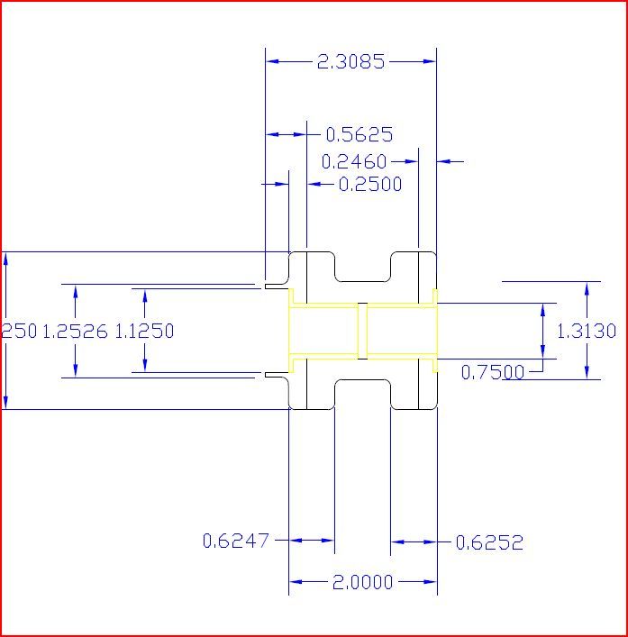

                                            You can leave out stages 1&2 and go straight in with the larger centre drill.
                                            If boring I would likely drill it 5/8" (16mm) but the 12.8mm will be OK if thats all you have.
                                            No need for any cutting fluid with brass, maybe a bit when drilling the bronze but not needed when boring.
                                            Will see what this comes out like when you enlarge it by clicking on the image, thats done as I described above from Draftsight.
