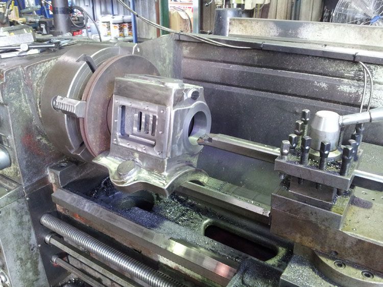

                          I have just machined the bore and the location flange on the steam chest for my 6" scale traction engine. The steam chest was too big for my mill and lathe so borrowed a friends.
                          The far side of the steam chest is tapped to mount a cover plate and I used these holes to mount it to an old car brake disk. First machined the the faces of the brake disk, then bolted the steam chest to it.
                          This mill is a little bigger than my Sieg X3 (table is 1m wide x 8m long). The steam chest is the little thing under the cutting head.
