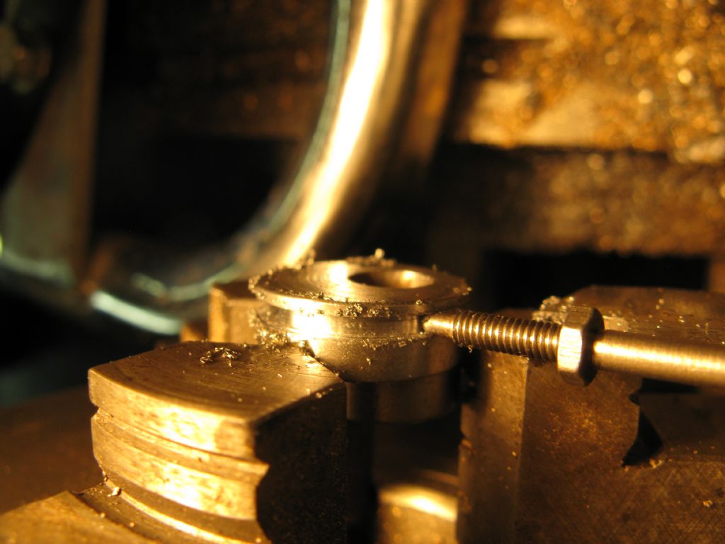

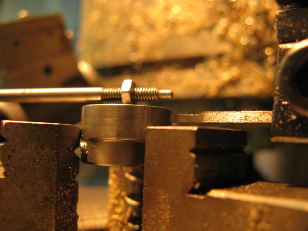

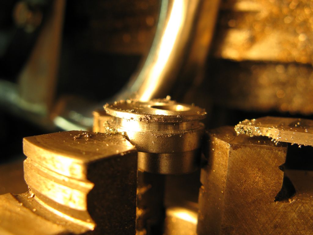

                      Some pictures of the restoration of the knackered S50 (a la Ebay) as promised. The grove on the eccentric was missing which allowed the eccentric strap to slip sideways, ceasing the engine. Aligning the eccentric so that it was true was a bit tricky – even in the small 3 jaw. Very little space so cutting close to the chuck. Here's the smallest lathe and a modified parting off tool being used to cut the grove.
                      Preparing to cut missing eccentric grove.
                      Not much clearance...
                      Perfect running fit.
                      Edited By Will Robertson on 02/02/2013 23:29:31

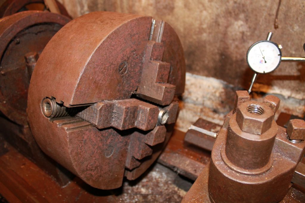

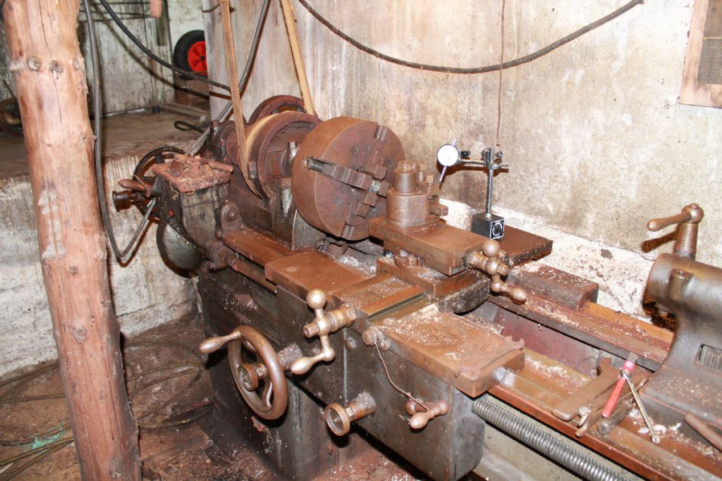

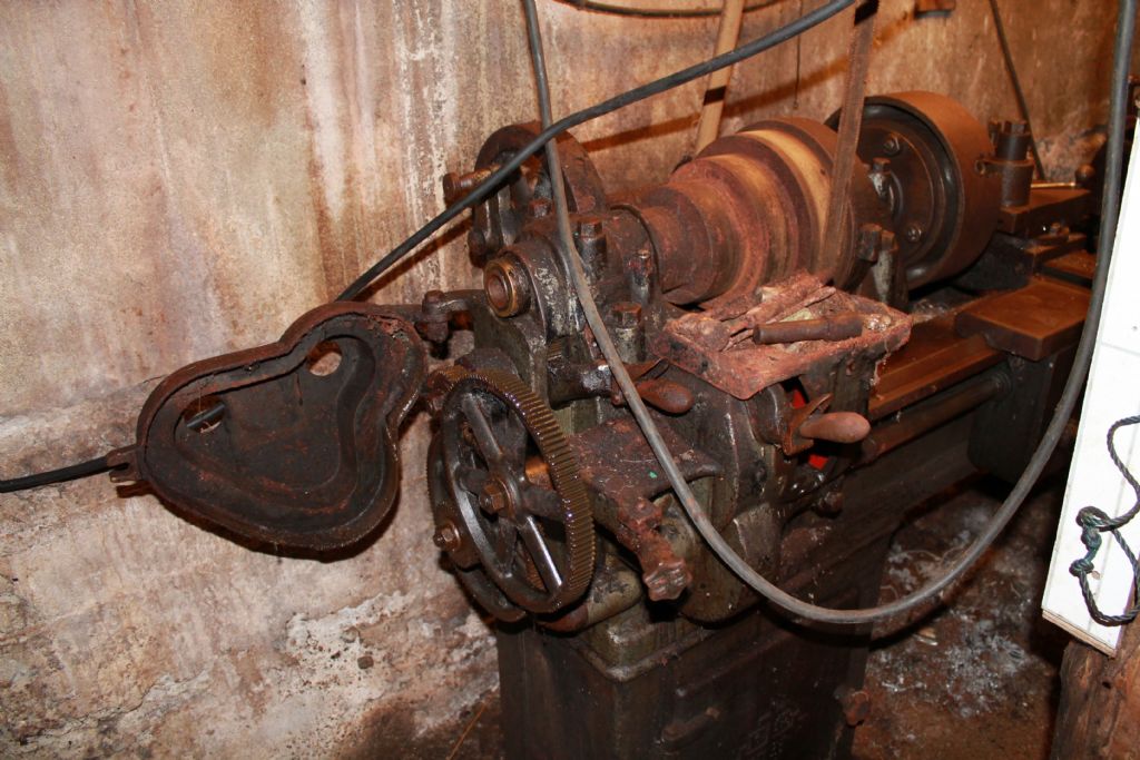

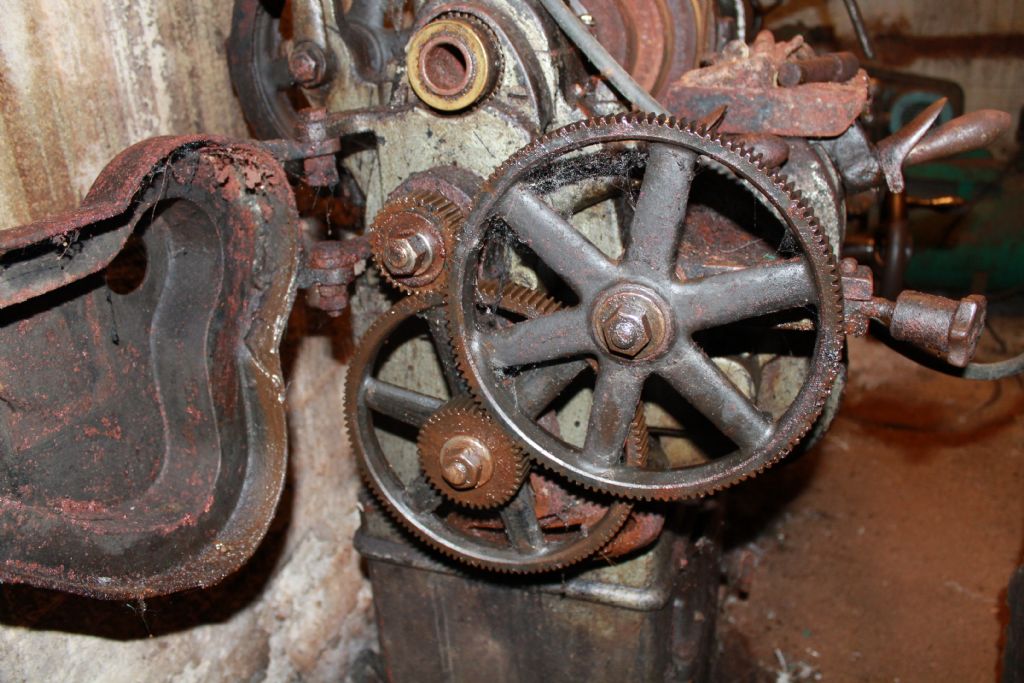

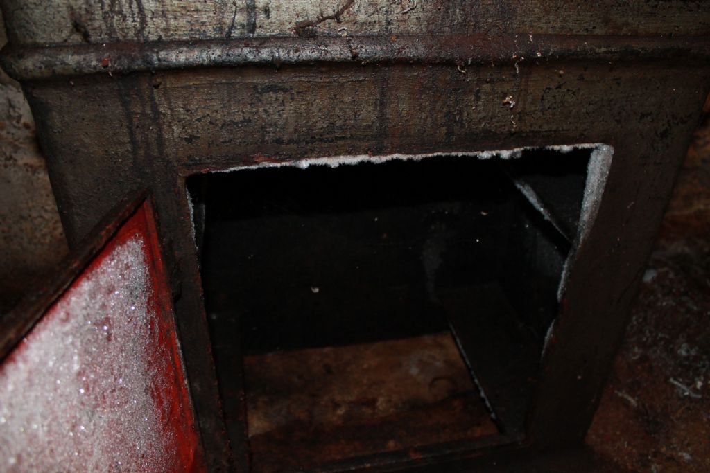

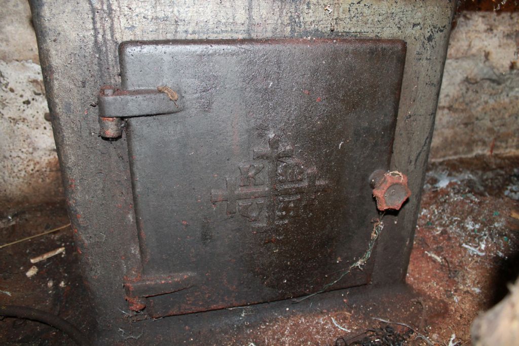

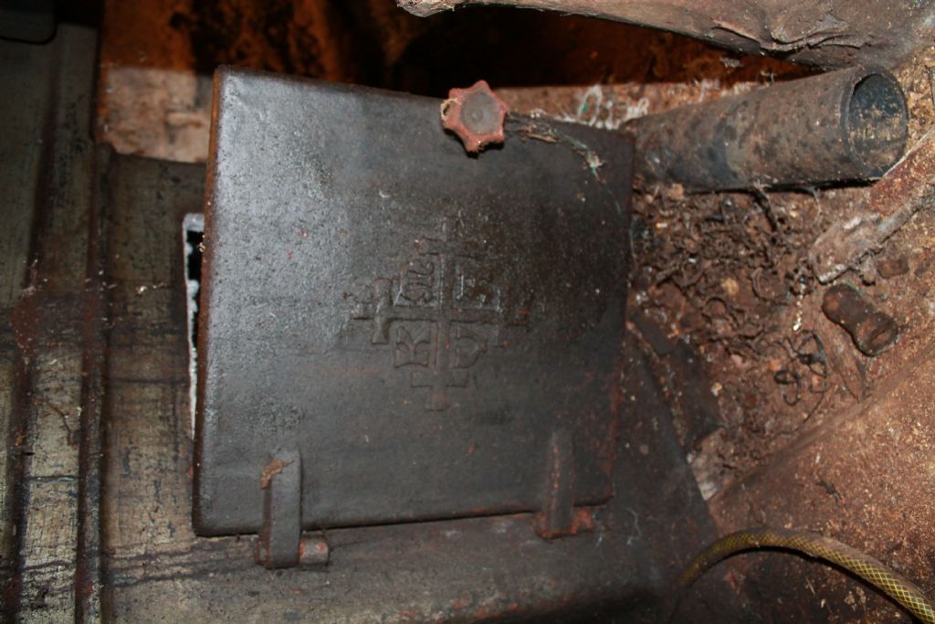

                                  The last set of photos were a bit boring – these are a bit more interesting. Just in case anyone didn't believe me about the age of the wonderful lathe or the temperatures involved…
                                  Gear chain - largest gear ratio possible - too large to fit in the gear box...
                                  The biggest gear ratio possible for the leadscrew on this lathe. The gear chain is so large that the door won't close.
                                  Can anyone identlfy this maker?
                                  Can anyone identify the maker?
                                  Frost in the lathe, - 8 C in the workshop during boring.
                                  Frost inside the lathe – the boring was done in Arctic Norway with the unheated farm workshop at about minus 8 Centigrade.
                                  Wonderful technology.
                                  Over 60 years and still going strong
                                  Just a moment to pass the mandatory health and safety inspection with flying colours. (Note the moving drive belts from the overhead drive shaft and the positioning of the 3 phase electrical cables.)
                                  Ready to cut.
                                  Ready to bore. The Ifanger ECS boring bar is in use (thanks Clive!). (4 jaw is centred and the DTI is just hitching a ride in this photo.)
                                  Will
                                  Edited By Will Robertson on 04/02/2013 21:21:03

                                      Can anyone guess at the maker of the lathe in Norway? I've never been able to recognise the logo on the door and I've nothing else to go on.
                                      Will

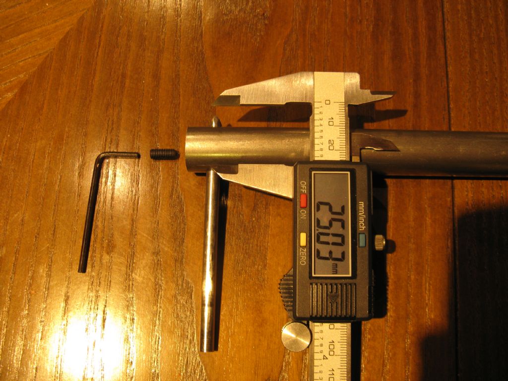

                                                Hi all,
                                                I've built a boring bar designed to cut from about 30mm diameter upwards. This will be used for milling the concave surface on the part that goes between the main cylinder and the valve. The boring bar is made from 22mm diameter steel and is 250mm long with an HSS cutting tool mounted at the end. Is it OK to attempt to mount a boring bar like this in a collet in the milling machine or should it be tapered and fitted direct into the taper of the milling machine? (The largest collet I've got access to is 16 mm but I can see if a bigger one would fit – if not I can turn down the top of the borign tool to fit.
                                                Hi Ian,
                                                I know that a diamond grinding wheel for me must seem both pretentious and decadent. Because shipping costs make up such a large part of the cost of me buying anything and because I tend to buy more from keenly-priced industrial suppliers a diamond grinding wheel actually works out about the same price or cheaper than a decent-sised oil stone or lap. A diamond wheel also opens up the opportunity to hone carbide tipped tools and this might come in handy in the future. It was Hans Rudolf here who first showed me one in action and I was impressed. I'll try and get my paws on both and see how they work out.
                                                Will

                                                    @willrobertson16447
                                                    Hi Clive,
                                                    Here's a photograph of the boring bar. It's intended to be adjusted to sise using a micrometer then the grub screw fixes the HSS tool in position. Clearly, the accuracy of this design is very limited – I've got a more accurate design in mind if I need it.
                                                    I might cut a datum surface on the back to make it easier to set using the micrometer.
                                                    The piece of HSS will be much shorter in use than in the photo.
