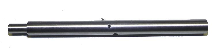

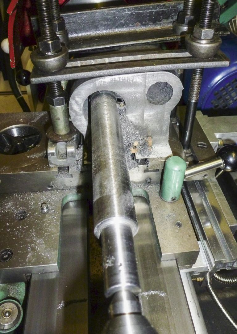

                Would endorse Jason B's recommendation "……. put it on the lathe cross slide and use a sturdy between ctrs boring bar." Adequately secure the casting on the cross slide after squaring it against the face plate. The boring bar designed by Geo Thomas is ideal as it is comparatively easy to adjust and measure the tool tip swing. Make it as big a diameter as you can. (Can point you to the source if required)
                However, as Paul K comments " cast iron can be a very variable material…………." I've just finished boring out CI cylinders to similar dimensions as yours, sold by one of our suppliers and the CI has machined much less cleanly than previous castings I've purchased. Surface finish even after much honing is relatively "rough".

                  I am coming to the same conclusion as all of you. Although the boring bar is 12mm in diameter it can flex easily when stressed. The lateral movement can be substantial.
                  However I will try a light cut using my aluminium cutting tool and if that works then fine. I suspect I will have to go to the boring bar solution.
                  Fowler, I think you should have an apostrophe in you name…!!! Thanks for the photo they are very informative.
                  Can you point me to Geo Thomas's boring bar design?
