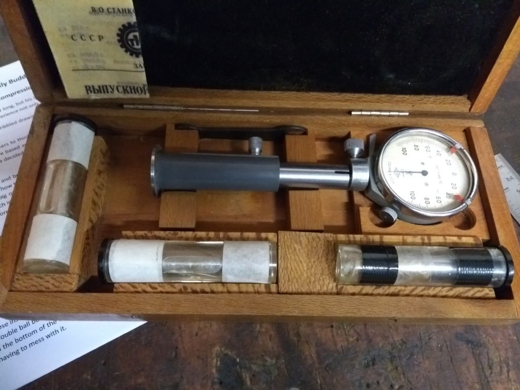

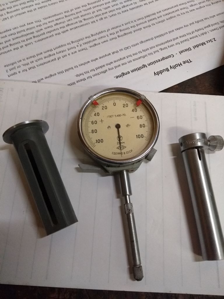

    Graham Williams 11
      @grahamwilliams11
      Chuffed today received a Russian 4 point Bore gauge, all the way from Bulgaria of all places, measure down to 2 microns in the range 10 – 18mm which covers all engines I'm likely to have an interest in. No guessing now as to how much pinch I've managed to get when lapping liners. Made a new liner for an AM 25 last few days, gauge saying 25microns pinch so well pleased

            Graham Williams 11
              @grahamwilliams11
              Don't need a setting ring as just trying to find the difference between top and bottom of any liner. Choose 1 of 3 'probes' to suit bore set reading at one end to zero and then measure other to show the difference + or – basically a comparator, if you need a setting ring the guy has all sizes though quite costly. Was told by one who knows that the 4 point was superior and used by all the top combat engine makers (Ukrainian/Russian)and easier to use and so far I've found it easy to use. Was only 100 dollars delivered, they do like dollars, he had others that were cheaper. Searched online after only finding ones that didn't have the required scale and they all looked well used, pricey and used a different system to measure which looked clumsy.

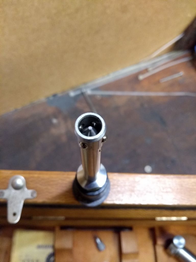

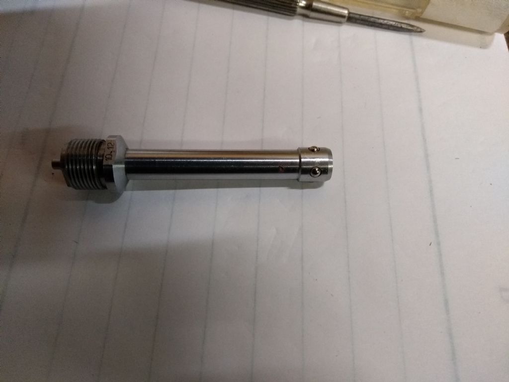

                    Graham Williams 11
                      @grahamwilliams11
                      Hi Kiwi. I/we do use it basically as a comparator but it is capable of measurement, that is what it's designed to do.
                      All 4 contact points (balls) move and are in contact with a central precision? made tapered spindle. I'll take pictures of a 'probe' and post later and perhaps you can tell me whether the design is superior or not to the 3 point type, which as you say are much more expensive and unless you have a no expense spared approach to model IC engine making putting them outside what is reasonable, in my opinion, to spend, Also I didn't want a micrometer (barrel) type as I wasn't confident in getting repeatable readings as all mikes, again in my opinion, depend a great deal on feel. For example measuring a liner with an ordinary inside mike I can get readings that differ by a thou maybe more taking one reading after another, heavy handed or what but it caused problems for me doing it that way. Also ball and telescopic gauges gave differing results so a decent dial bore gauge, economically priced with micron capability, looks good from here.
                      Hiya Tug. Don't know about perfect but being able to decide on whether you've got the pinch to a working position looks easier to decide on with this gauge. Never underestimate the Russians on producing good stuff, look farther than a cold war Lada lol. Finished with the AM25's now so sorting material for the Holly Buddy engine, think I'll do the liner first LoL.

                      #453497
                      Graham Williams 11
                        @grahamwilliams11

                        Kiwi Bloke
                          @kiwibloke62605
                          Fascinating Graham; never seen one like it.
                          I'd still call it a comparator, however, although, like the more conventional bore comparators, quantification of deviation from the null can be read from the dial. That isn't really the same as a 3-leg bore micrometer. As to why the Russians used four moving (and apparently gauging) contact points, I've no idea. They liked to plough their own furrows, didn't they? Perhaps someone can offer a suggestion.

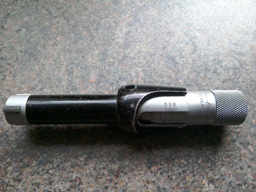

                                Martin Connelly
                                  @martinconnelly55370
                                  This is my Fowler Bowers 3 point 0.75" to 1" bore gauge. I also do not have a ring gauge to check it against.

                                    All very interesting as the guy in Rowan & Martin's show always said. Tried it out again this afternoon on 2 liners I've made and what I've got is exact repeatable readings on multiple attempts, gauge hand held so it's what I'm going to use from here on in. As to why the Russians went for 4 contact points I have no idea but I've always had a healthy respect for Russian technical products, were they not at the forefront of CMM introduction, they do indeed plough their own furrow and because of a desire for usually Dollars the products are within reach price wise.
                                    Martin, will your Fowlers gauge measure in microns? I'm not a fan of barrel (thimble) measurement for anything needing sub thou measurement for the reason I said previously.

                                      #453621
                                      Martin Connelly
                                        The Fowler gauge is marked to 0.00025" (quarter thou) and you could theoretically estimate between the marks. Not having a temperature controlled workshop or inspection room I doubt I will worry about microns.
