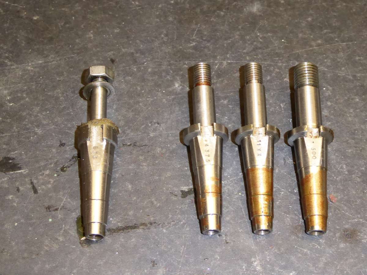

      Does anybdy even use these any more? I have a bunch of cycloidal gear tooth hobs of 8mm and 10mm bore but after doing a search I don't see any used ones for sale which means they are either undesirable or unobtainable, I suspect that it's a bit of both. I also have a few ratchet cutting hobs.
      Having no interest in horology or instrumentation I don't suppose I will ever use them. They don't take up much space so keeping hold of them is not much of an issue but on the other hand I'm conscious of the fact that with the advent of additive machining in metals these hobs might soon become completely obsolete that is if in fact it has not already happened.
      If these things are still in common use somewhere I should like to find out where. Alternatively, if there's a common range of gears used I wouldn't be averse to producing cycloidal gear form bar stock for people to part off their own gears from but again I wouldn't know where to start looking.
      It just seems such a waste to have them sitting in a box for the next twenty years (hopefully, at least) for them to then end up in a skip.
      Looking for ideas, suggestions etc.

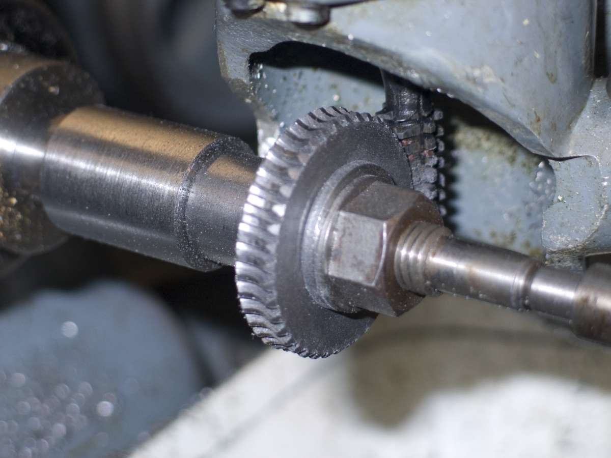

                          I have found that when hobbing ratchets, the hob only produces a correct profile for one specific tooth count, that elusive number is often only discovered by trial and error if the hob is not marked with it.

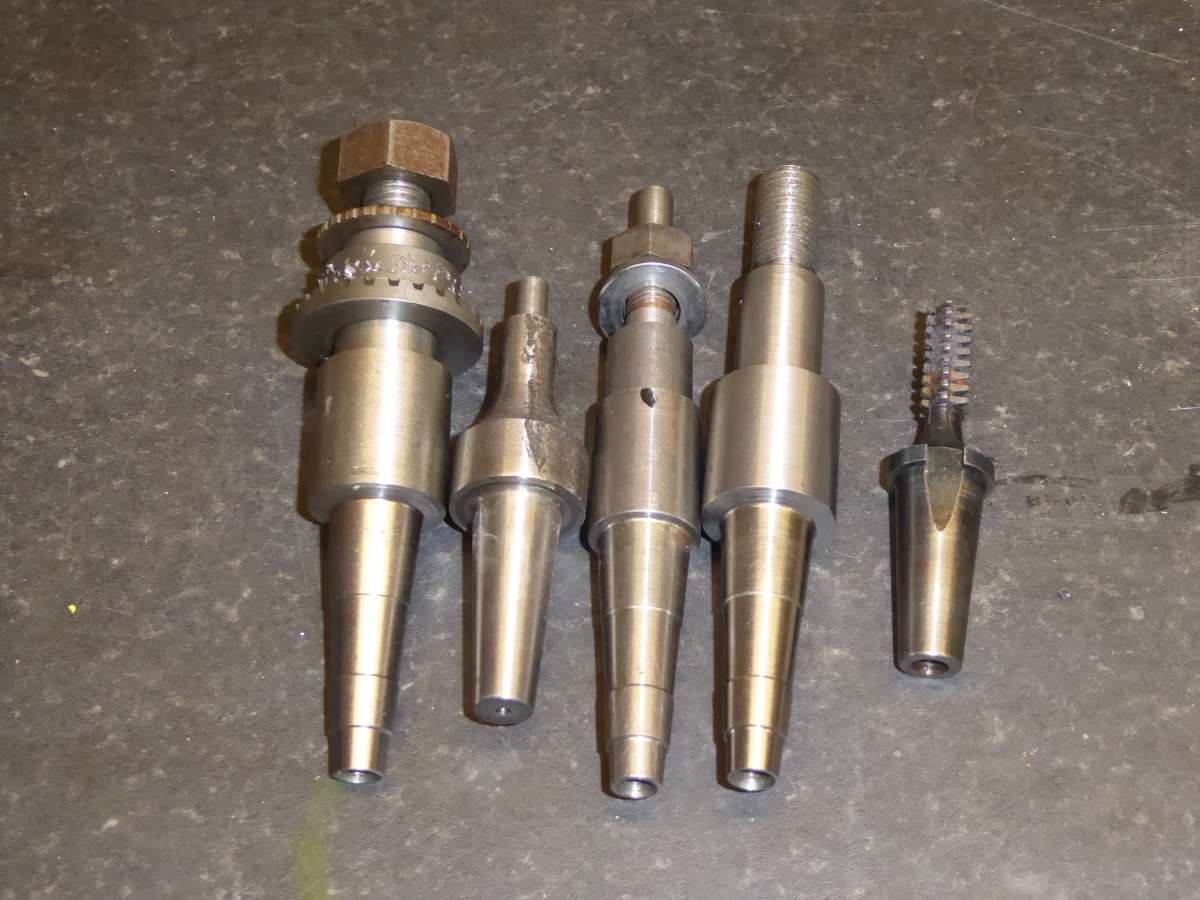

                                  Does your 112 not have removeable hob arbours ?
                                  Mine has a spare spindle that only takes 10mm bore hobs, but it also has one which I use all the time that takes taper shanks which are the same taper as the main work spindle.
                                  Mikron Tooling 003 02-06-21
                                  I made various new arbours to take the different size hobs I had available.
                                  Mikron Tooling 002 02-06-21

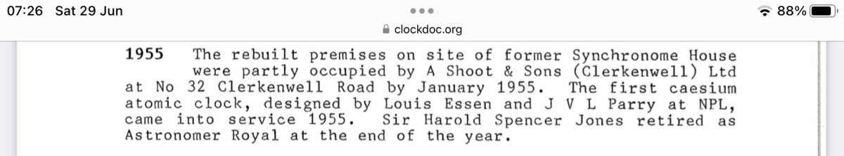

                                    I believe the hobs that Pete has came from Pullars Instruments in Brighton. Pullars were a division of Smiths Instruments and I believe they made parts for aircraft instruments, possibly altimeters etc, so the hobs could be DP but may also be non-standard MOD sizes.
                                    I have quite a few wheel and pinion cutters that came from the same source. All of these have identification codes rather than DP/MOD sizes. The codes are similar to those on cutters sold by A. Shoot of Clerkenwell. For instance a cutter I have just has the marking K1978 which by measurement may be for an 8 tooth pinion M0.59/DP 50.8. A. Shoot may have only been a supplier rather than the manufacturers and I have a list of their Catalogue numbers with associated cutter info. For instance their Cat No K1007 cutter is listed as M0.32 12 T special cycloidal.  Although we now only have PP Thorntons as a UK manufacturer of cutters there must have been others and does anyone have any info about them.
                                    Clive
                                    #738502
                                      On Clive Steer Said:
                                      […] The codes are similar to those on cutters sold by A. Shoot of Clerkenwell. For instance a cutter I have just has the marking K1978 which by measurement may be for an 8 tooth pinion M0.59/DP 50.8. A. Shoot may have only been a supplier […]
                                      I have a dim and distant memory of visiting Shoot’s emporium and, based only on that, I would think ’supplier’
                                      Edit: __ Ref.  https://clockdoc.org/gs/handler/getmedia.ashx?moid=57294&dt=3&g=1

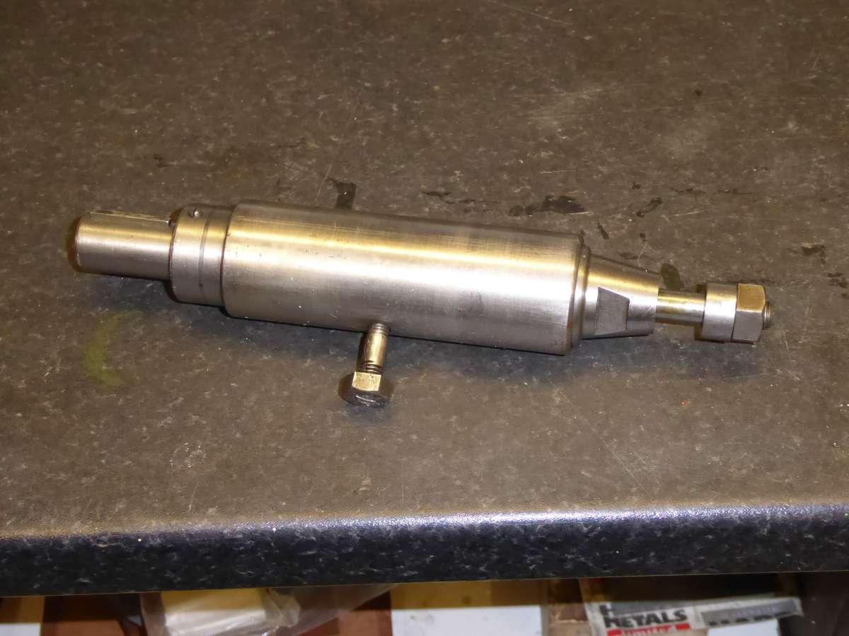

                                              Phil,
                                              My spindle does look like the bone pictured. If it does take tapered armors I never knew about it. I just moved house and have yet to bring the machines to the new workshop but as soon as I get a chance I will
                                              How are the arbors held in the taper?

                                                  My other photo did not load properly, these are the cutter arbours I made for mine and they are held into the spindle with an M6 drawbar.
                                                  I also made these workholding arbours, also held in with an M6 drawbar.
                                                  Mikron Tooling 001 02-06-21

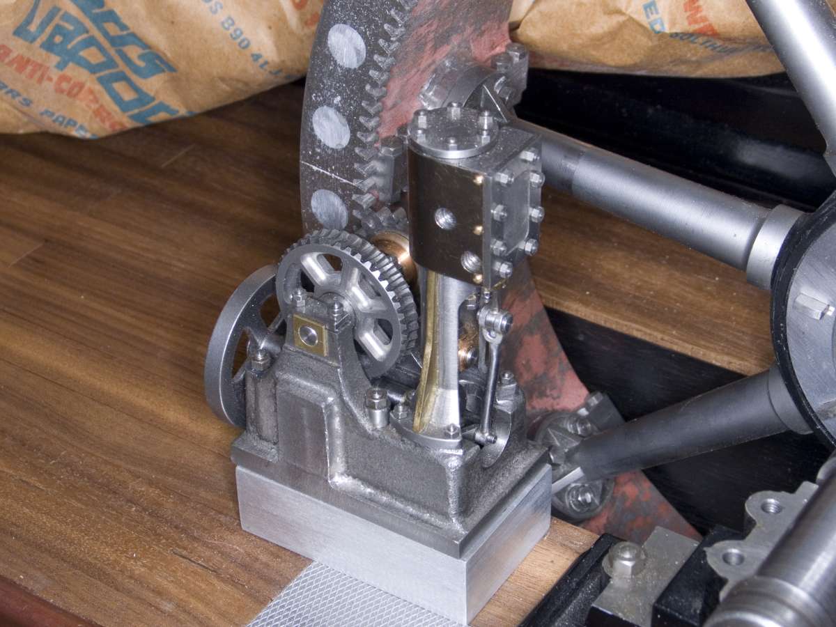

                                                    The cutter on the right hand side of the previous photo was used to produce the worm gear on my model of a Pollit & Wigzell barring engine.
                                                    Barring Engine 005 17-04-16
                                                    Minor Manifold 011 09-10-19
