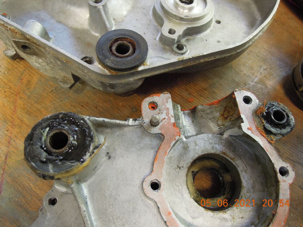

      As if I haven't all ready go enough to do, I've just made a start of restoring a 1950s Cyclemaster Motor Wheel. I got it back in the 70's clearing out a neighbours shed. I played with it for a while and it worked pretty well. It must be all this current talk about 'E-bikes' but something is compelling me to get it going again and perhaps use it for climbing mountain tracks in the north. (Might need a change of gearing for that though!)

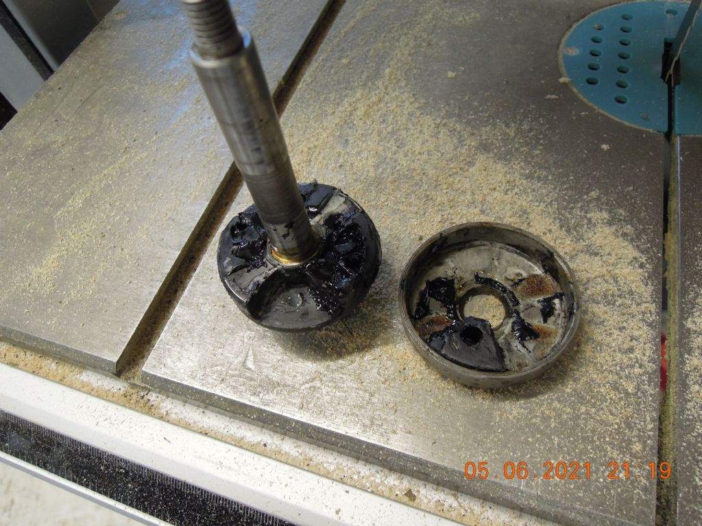

      Just a general survey of this mean machine yesterday showed that all the rubber bushed engine mounts and a 'cush-drive' on the output shaft have turned into a black goo. I imagine the original spares will be hard to come by so what do vehicle restorers usually do when faced with perished rubber parts ? Are there sources that can cut new parts from fresh material ?

            If you visit a decent electrical distributor , you should be able to buy a two-pack self-setting hard rubber compound that would do that job perfectly.

                Would sectors cut from a ice-hockey puck be too stiff? Could have a hole drilled to ‘tune’ them to what is needed.

                      Posted by J Hancock on 06/06/2021 13:45:50:
                      Potting compound wouldn't be ideal as it's often a hard setting epoxy.
                      We use this stuff for reproducing NLA rubber parts on vintage bikes, just pick a suitable hardness and make a mould. Give it a few days to cure and you're good to go. Link
                      One piece of advice with castable PU. To reduce the chance of getting bubbles when you mix the two parts, put the bottles in warm water before pouring it out.

                          Another piece of advice for castable PU: they're aren't kidding about the six month shelf life, so don't buy a bigger amount than you need because it looks more economical!

                                An alternative to rubber is polyurethane. The tuning shops tend to stock a range of sizes for suspension eyes – as do Land-Rover specialists.

                                  Yet another avenue to explore would possibly be 3D printing with TPU flexible filament. I don't have a 3D printer but from what I read, having Googled it, it could work, though I suspect that you may have to experiment with the infill settings to obtain the required stiffness.
                                  If I couldn't get direct replacements from a Cyclemaster spares specialist, like the one in Earls Shilton Liecester, I'd be tempted to buy a car engine or exhaust mount and carve it into shape, somehow.
