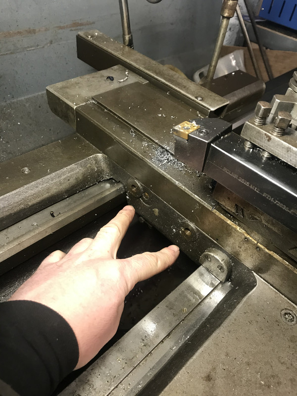

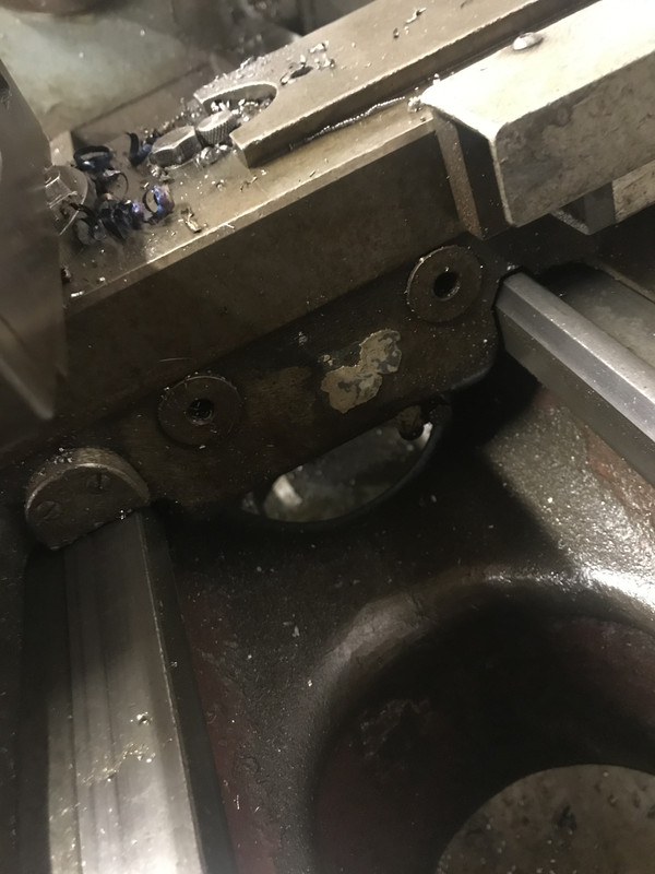

                #503636
                Dave S
                  @daves59043
                  On mine there are a pair of hole on the chuck side and a pair on the tail stock side:
                  I have no travelling steady, only the fixed one.

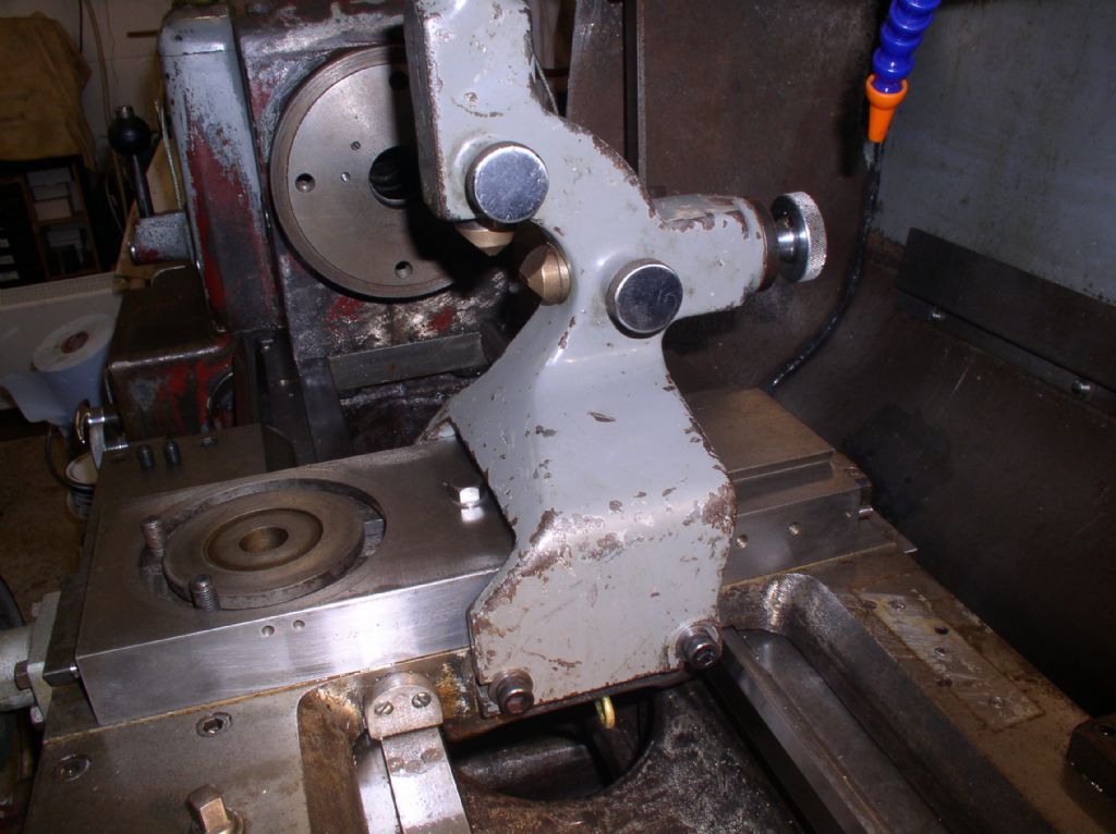

                      #532562
                      Martin Nichols
                        @martinnichols17110
                        Bit late here, but I've emailed George directly with positions & dimensions of holes.
                        Here's mine in-situ with the top-slide removed for clarity:
                        And note
                        (a) if yours is a short, 20" BC bed CVA (a mk1 rather than a 1A) the travelling steady is very different.
                        (b) if, like Dave S, you have a DRO scale here, the steady probably won't fit, without surgery!
                        Hope this helps.
