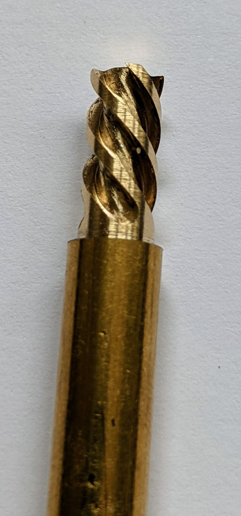

                      This is an initial attempt at milling a 4-start "helix lever" gear by CNC using my 4th axis on the Novamill. With some attention to supporting the blank it should be possible to do 1-start helices – the Victorian era clocks that used these had 1-start pinions so they could do large reductions in one step. Though milled with an ordinary slot mill (1mm) it is possible to do angled flanks by some careful offsetting of the cutter relative to the blank axis.
