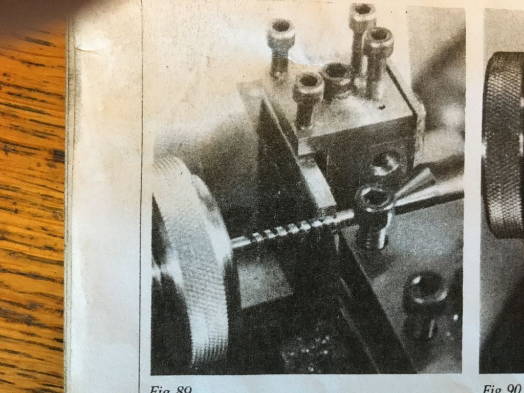

      Hi All,
      I am trying to cut an 8tpi thread in a 5/32" diameter silver steel bar. I am using free cutting silver steel as the instructions suggest. I have ground an ACME tool in HSS and have a live centre and travelling steady for support and turning the lathe by hand……but tool keeps catching (digging in) and warping the bar.
      Any thoughts or suggestions, as always welcomed !
      Ken

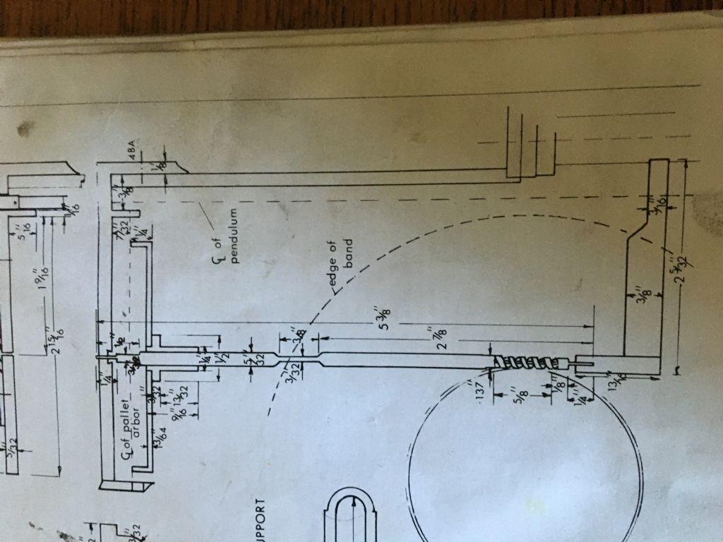

                    Hi All,
                    It is "only" 3/4" long thread. Just checking the instructions and it is 8tpi and 5/32" stock, it suggests a depth of 0.05" for the cut…..and fully admits it isn't going to be easy !
                    Maybe I should explain what it is for, it is a worm drive on a clock, so the thread drives a wheel, so, the depth of cut only has to allow wheel to engage, hence 0.50" cut.
                    The book also suggests a tip on the acme tool of 1/32", again maybe not standard. I think I will give Clive's suggestion a go and lots of shallow cuts from reading around
                    Ken

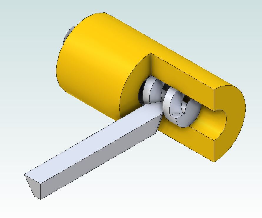

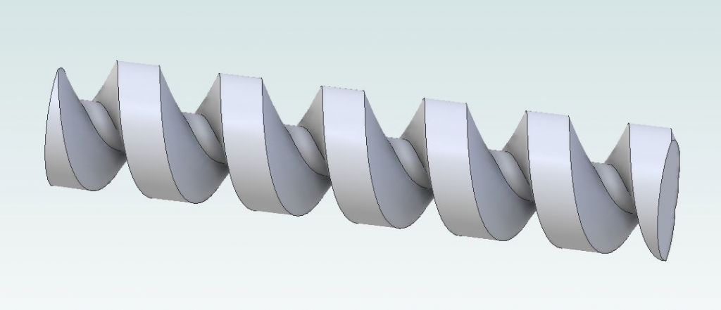

                          It will almost need a solid bush type traveling steady as you see on "running down" cutters. Rather you than me, at least it was easier to draw this is to the 0.05" depth and with 1/32" tool tip

                              I think I will try the 650 degree and then clean up……here is a photo from the build book, clearly better lathesmiths than me – but then again I thought making a wheel was impossible the first umpteen times I tried and messed up, I can usually get them first time now
                              Ken

                                              The photo seems to show the rear toolpost being used as a traveling steady, possibly a half round cutout in the end of the support, topslide set at 90deg to lathe axis to put on the cut.
                                              As I said another option would be to mount a bush on the cross slide to support the work and again use topslide at 90deg to put on the cut.

                                                The bush idea would work well as long as the assembly could be separated after each pass to completely remove all traces of swarf. Grinding the ACME form is not enough, it should be honed for the sharpest possible edge. Also, the cutting tip should be aligned exactly to match the helix angle of the thread.

                                                    This is similar, silversteel, diameter 2.8 mm, core 0.9 mm, pitch 1.10 mm and 8 turns if it becomes more slender you make an extra support. Nikomilling worm.jpg
