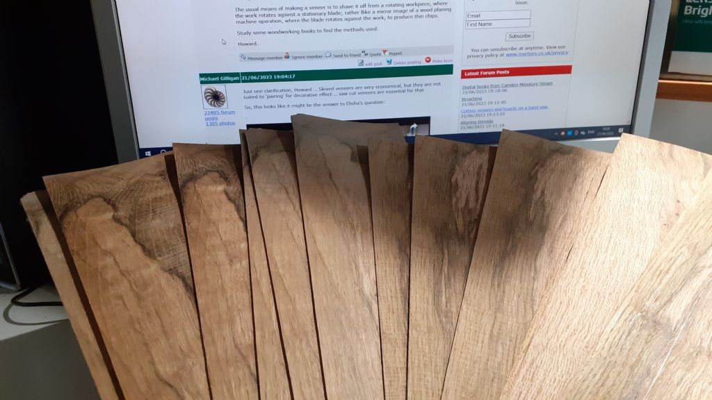

      Hi there, I'm a student completing her DT a-level and I'm doing my project on designing and making an object/item/tool that will assist in the easy making of veneers and boards on a band saw. I was wondering if you have any existing products that help assist in this area, or if you have any knowledge on ways and methods to complete this process easily, including the kerf in the measurements, meaning you don't have to re-measure every time.

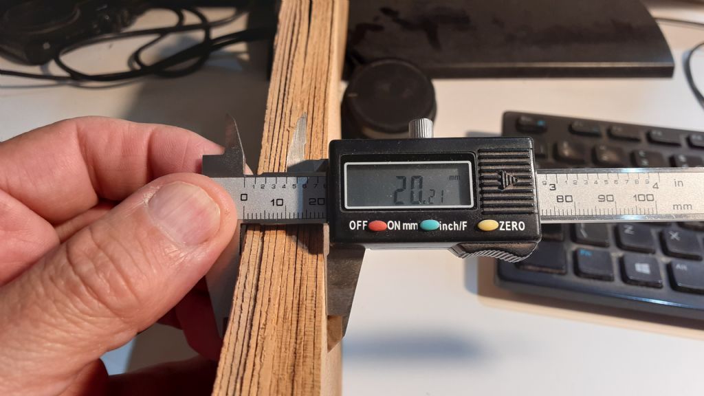

                You don't want a fine blade as it will just clog with sawdust, I use 4tpi. skip pattern What you do want is a thin kerf blade unless you are happy to waste wood. A good depth 3/4" blade will be about right and properly tensioned and tracked
                A good tall fence is all that is needed to run a preferably planed face against which will set a constant thickness, after cutting plane the surface again before cutting the next veneer.
                Bandsaen veneers are typically thicker than knife cut so you will be looking at 1 to 1.5mm and they will require more finishing so the extra thickness is useful there.
                13 leaves of oak I cut on a bandsaw
                20mm thick total
                As for decorative effect all methods can be used depending on the grain and what type of pattern you want, these are knife cut (sliced not rotary) and give quite a nice decorative effect when bookmatched etc In fact knife veneer is better for book matching as there is no kerf which is the equivalent of loosing pages

                    I stand corrected … Saw-cut veneers were traditional … Jason has shown that knife cut has advantages.
