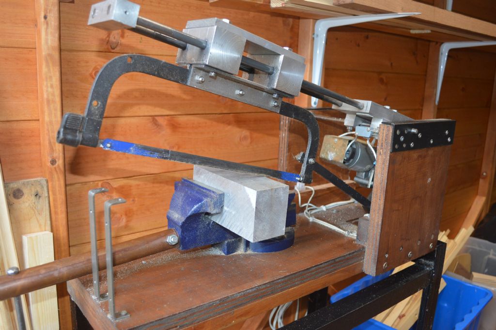

        Michael Brett 1
          @michaelbrett1
          I have a standard 12 inch hacksaw driven by a 12 volt windscreen wiper motor. Been using it for over 5 years to cut all my large pieces of stock metal . Has a fast stroke, much faster than I could saw. Some of the thicker pieces can take up to half an hour to cut, but I do not have to be present as it has automatic stop when the job is done.

                    File Handle
                      @filehandle
                      Michael, I like your idea of using a wiper motor to drive a 12" hacksaw. Have you a photo of your setup.

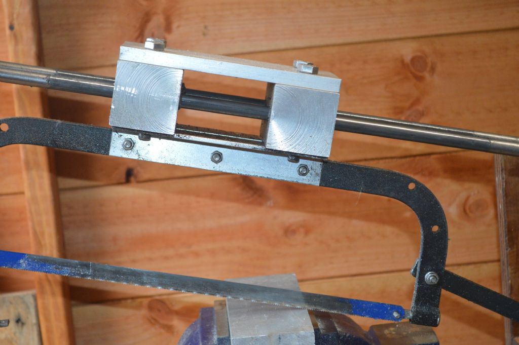

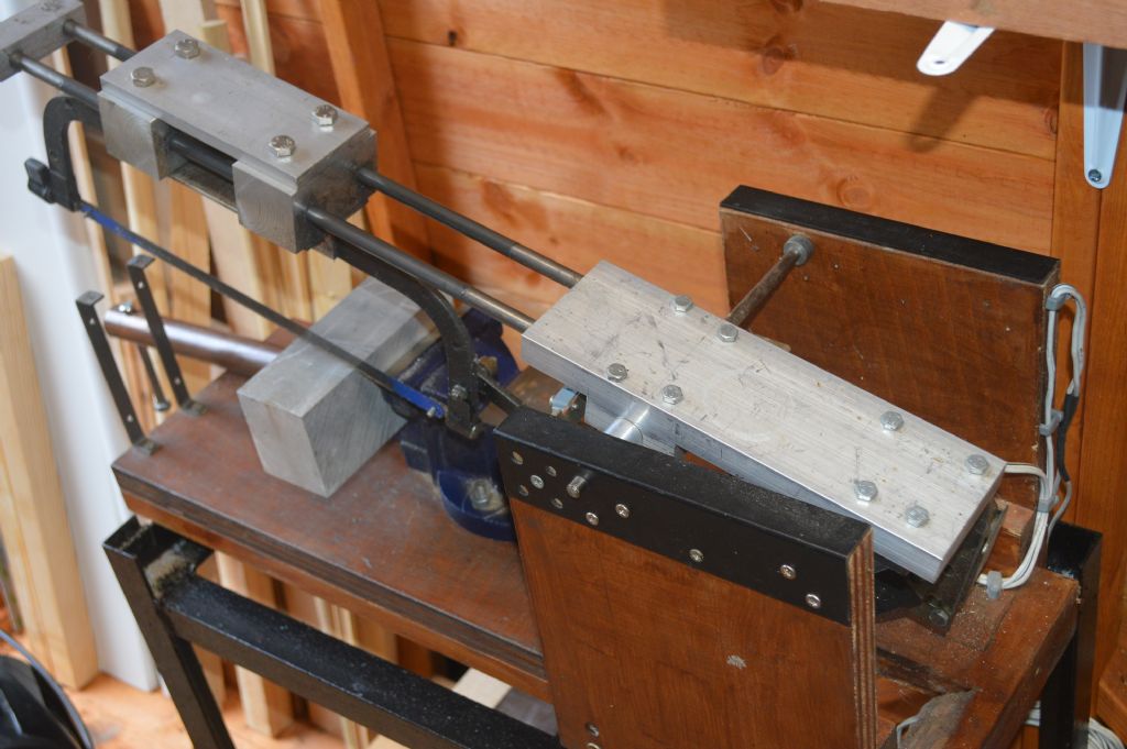

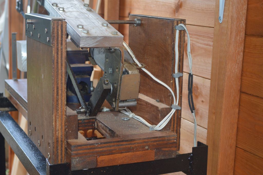

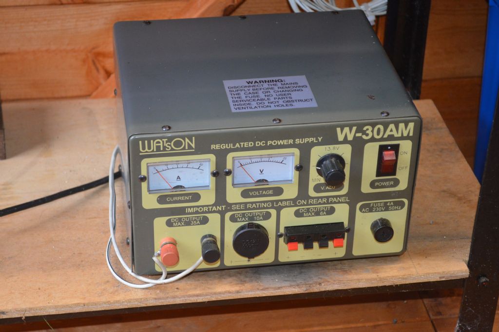

                              #571710
                              Michael Brett 1
                                @michaelbrett1
                                006.jpg005.jpg004.jpg003.jpgThis is my powered hacksaw, not the best looking machine I have made but it does the job. Needs about 5 amp @ 12 volt which I get from my 30 amp power supply. When I first tried it it tended to jam, especially on aluminium , I soon discovered that it works much better with the blade reversed , cutting on the backward stroke. It has never jammed since but it does benefit from a little lubrication when cutting softer material.
