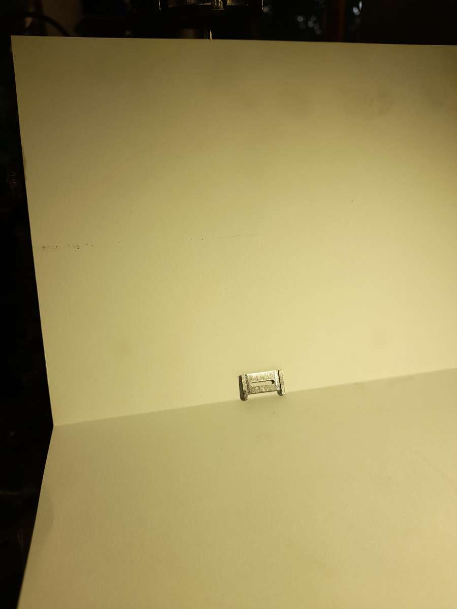

      What is the best way to cut a 1/2″ long x 1/16″ wide, full depth slot though 2mm mild steel strip. I have a 1/16″ slot drill and a 1/16″ end mill. I have though about chain drilling most of the metal away then using the slot drill to clean the slot up to a finished dimension. Not sure if the slot drill will cope with even the lightest sideways cutting force.

          Chain drilling is likely to create problems, not solve them.
          Milling cutters, especially in these small diameters, are much better in homogenous material. Chain drilling leaves lots of “teeth” that could snatch the flutes, possibly breaking the cutter.
          You don’t say how precise the slot has to be, but if it is critical, e.g. a keyway, it may be better to use an under-size cutter first along the centre-line then gently take the sides out to finished width.
          #751872
            The cutter should certainly withstand the correct cutting forces other wise there would be little point in them being made.
            Stitch drilling such a small slot can cause as many problems as it solves as the cutter moves from little load to no load it can snatch.
            Try drilling each end a little undersize say 1.4mm so that you can feed the cutter downwards without it having to ctr cut. Don’t try it all in one go say 10-15thou depth per pass. Run fast 2000rpm and feed gently but constantly. Keep chips out the slot so they don’t get recut or deflect the cutter. Use the slot drill for a more accurate width

                    The slot is not open ended. Will go for the slot drill with holes drilled at both ends, thanks your views.

                      If you are cutting a slot and the end is not open, then only drill a hole at one end. Running into a hole can be the cause of damage o the cutter. Cut with a small depth of cut and having a vacuum cleanser or some other suction device to draw away the swarf will make the cutter last a lot longer. Having the material clamped is also important. A cut depth of 0.1mm to 0.2mm id being realistic at a fine feed. Only feed in 1 direction, as if you feed in both directions, you can have an oversized slot. If the end if open, no need for a drilled hole. Ideally to make a 1/16 slot, would cut with a 1.5mm cutter first, and then finish each side, or finish with the 1/16  cutter at full depth with a slow feedrate. Slow being at a rate of 0.01mm to 0.02mm feed per tooth. So at 1200 rpm, the feed rate will be 24 to 48 mm/min or 0.5 to no more than 1mm per second feedrate. You can use this rate for the roughing out too but at lower depths of cut.

                                      Sorted with a 1/16″ end mill and a holesight screen drilled at on end of the slot.
