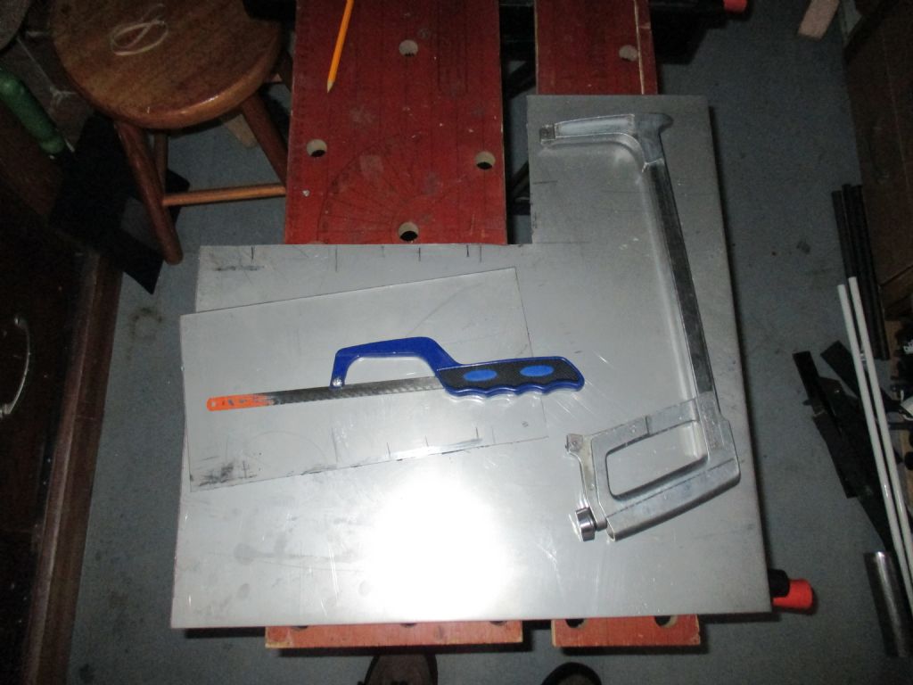

      I have a 500mm square sheet of 304 stainless steel 2.5mm thick and want to cut it into some smaller pieces. I have made a start with a metal cutting blade fitted to a jigsaw and while it does work it is extremely slow going. I have thought of using a thin metal cutting disk in an angle grinder and would welcome any thoughts from those that have done this with stainless steel. My worry is that the edges might get work hardened and make filing the edges difficult.

                            I tried to cut the stainless sheet with my tile cutter and had some success but I think the blade was too worn to work well. I then tried cutting with the hacksaw using a new 32 tpi bimetal blade (good quality Swedish Bahco one ) and was surprised at how well it worked. One cut was too long for the hacksaw so had to finish that cut with the other blade holder shown in the photo. On checking the blade after the cuts it was still in pretty good condition. So there we are then, the humble hacksaw won the day.

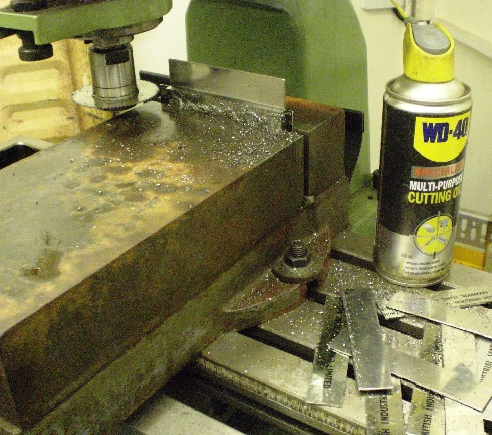

                                          Hi, I would in most cases cut stainless plate with a 4-1/2" angle grinder with a thin cutting disc, but it does need to be one with INOX marked on it, especially if you are going to weld it. When I had to cut 30 24mm wide stripes from some 1mm think plates, I clamped six plates at a time in the vice on my milling machine and cut them one by one with a slitting saw, which made sure they were all the same width and no over heat stains on them, and were far easier to hold, as the last two from each plate, would have made holding them difficult.
