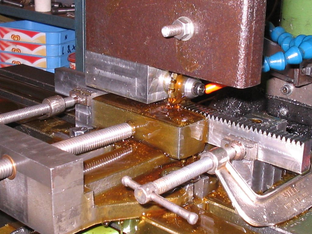

                            Somehow doubt if BJ 11 would be interested in cutting a rack.
                            This one here took over 5 hours to cut the 159 teeth.
                            Was definitely a "OMG what a painfully slow process as you mill each one"

                                    #563503
                                    John P
                                      @johnp77052
                                      Posted my Me 18/09/2021 11:40:12
                                      Was definately a "OMG what a painfully slow process as you mill each one"
                                      Should have pointed out the machine is part Cnc but he rack is about
                                      25 inches long, table traverse about 21 inch so done in 3 stages ,
                                      reset to do each 8 inch or so length ,plenty of time for a snooze
                                      in an armchair, machine beeps at end of sequence so no need for
                                      alarm clock , pumped oil system so no laborious squirting
                                      of oilcans to disturb slumbers.
                                      #563505
                                      brian jones 11
                                        @brianjones11
                                        Piccie of the armchair, big trough in the squab is there?
                                        Cant really see what happening at the business end, the spindle is clamped and you motor the y slide in and out to cut the tooth, then index along x wise for the next tooth is it?
                                        5 hours phew, were you compensated by the hour?
                                        Could this duty not have been done with a motorbike chain?

                                                      @johnp77052
                                                      Posted by brian jones 11 19/09/2021 22:54:39
                                                      Here is another view of the cutter and the rack .
                                                      Not really as bad as it sounds at 159 tooth and 2
                                                      minutes a tooth ,that is to cut the tooth retract set to
                                                      next position . 2 x 159 = 318 minutes 5 hours 9 minutes.
                                                      It is only a hobby machine ,i have 7 other machines
                                                      that run as part cnc that use the same system ,both Doreen and
                                                      Maureen have been Cnc'd for about 16 years.
                                                      It would of course be possible to have the all running at the same
                                                      time i guess it would be like
                                                      but much better to have just the one running at a time so you can
                                                      enjoy the
                                                      The bike chain idea has some appeal ,easy enough to nip into
                                                      town with a pair of bolt cutters ,plenty of choices there ,still
                                                      leaves the problem of cutting the sprockets ,back to one
                                                      tooth at a time ,another plan foiled.
                                                      I'm just worn out writing all of this,where's that armchair.
