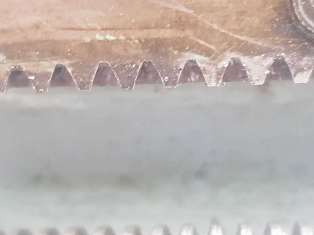

                                      I had a look under Maureens apron (she a bit coy about that sort of thing – girls born in the 50's were like that)
                                      As you can see the rack, straight sided teeth 60deg

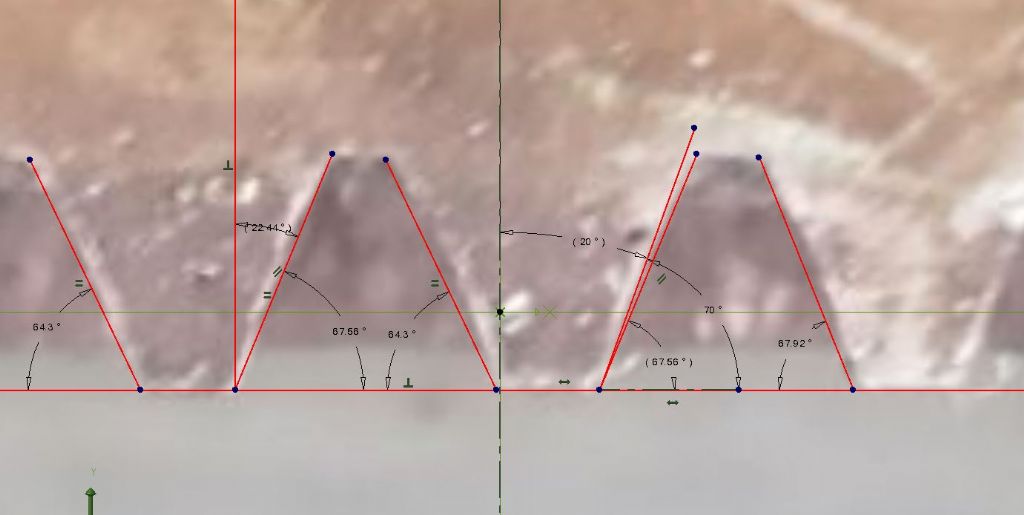

                                        Posted by brian jones 11 on 17/09/2021 14:55:01:
                                        Really, how are you measuring that?

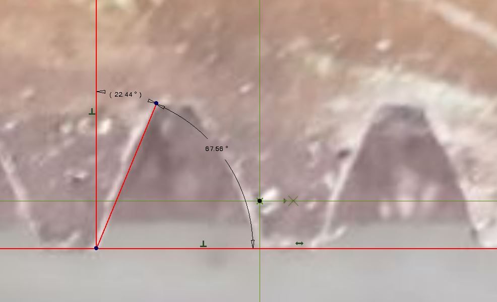

                                        #563186
                                        Martin Connelly
                                          @martinconnelly55370
                                          Copy your picture into a CAD program and measure the angle. Not 60°. I've done it but will let you find out what it is for yourself.
                                          Martin C
                                          Jason posted just after I started doing it.
                                          Edited By Martin Connelly on 17/09/2021 16:00:39

                                            Hmm well I was going on what I read, maybe Maureen got a faulty rack?
                                            How do you justify the angle of 67deg?
                                            Now if you postulate Maureen would have had a PA of 14.5deg then the combined angle should be twice that ie 30deg
                                            so if PA was 20deg then this should be 40deg
                                            so this is a long way off?

                                                Posted by JasonB on 17/09/2021 15:49:40:
                                                Could you try nudging that a little, Jason … and maybe get 20° instead of 22.44°
                                                [ requested before I saw your last post ]
                                                Edited By Michael Gilligan on 17/09/2021 19:03:43
                                                #563216
                                                  nudging numbers, I thought that was more Brian's sort of thingsmile p
                                                  There is some distortion, if you look at the notches at each side of Brian's original photo they are leaning so can only take a guess. However we don't really need to do that as if you look under "the Apron" in this old catalogue you can see that they did indeed use 20pa for the rack and it's pinion, must have been thinking of all those model engineers who wanted to use the carriage to plane keyways.
                                                  EDIT, here you go with the others measured and a token 20deg line for good measure.
                                                  Also note that the teeth seem to be slightly concave not "straight" as proclaimed by Brian, maybe after 70yrs of use she is showing some wear and is a bit bow legged under the apron. Click for larger image
                                                  Edited By JasonB on 17/09/2021 19:21:00
