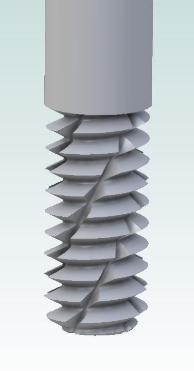

                              Hi JB I am still beavering away on hobbing but ran into major probs with SU and trying to intersect and cut a slanted cylinder from a screwed rod
                              Can your system model a spiral flute tap easily?. I am getting there and got a method from another board but its been fraught
                              I am looking at knocking up a manual hobber arrangement turning the tap by hand or with a 12v motor froma window winder (£10 bargain 30rpm 20W bags of torque). I have a speed controller as well
                              I also though of adapting a HT set screw by grinding a diagonal slot down the shank. It is an old trick to knock up a repair tap for female threads. The slot should make cutting edges sufficient for soft material, eg AL brass. delrin, tufnol – difficult expensive to get spiral flute taps
                              A simple hand jig might just suit small gears for light duty
                              I found some LH threads so might go for the herribone
                              It all makes work for lockdown man
                              The betting is that we will all get delta covid by xmas so i better get a wiggle on

                                Posted by brian jones 11 on 30/08/2021 19:02:47:
                                Yes thanks, its no different to modelling the helix of the tap, just a different profile and a steeper helix and multi start. Quick one here though flute profile is not right, would need to go and have a better look at one in the workshop.

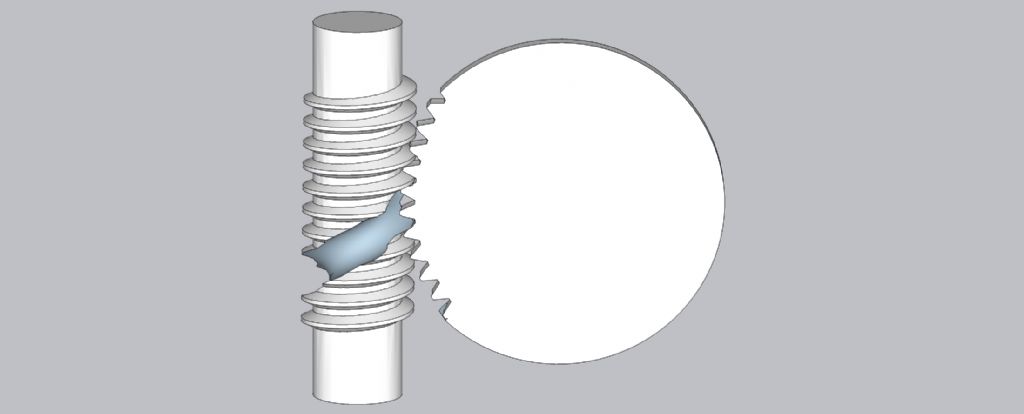

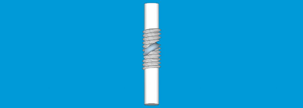

                                    Well I went from lockdown to near break down now I had a break through
                                    It was quite a business but I had some kind help from the SU forum that taught me a lot i didnt know and also some very neat extensions (all so far free)
                                    not a good pic but now I have to create the gear blankcrying

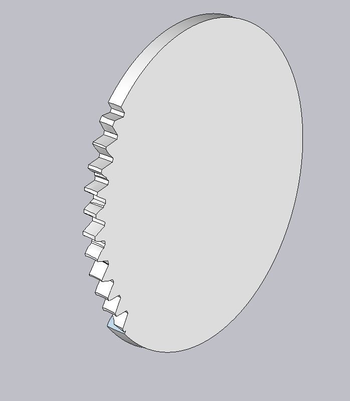

                                      Well you can have too much of a good thing and I have push my cad model as far as I need to go (having mastered the art of boolean intersections)
                                      spiral flute tap method
                                      a slightly dodgy gear form as all the armchair pundits predicted
                                      I will now proceed to make physical models to see if I can get usable rough gears

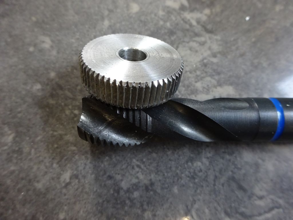

                                                      well curiosity got the better of me so I dug out a 1/4" BSP spiral flute tap as it was my largest spiral flute one, worked ot the helix angle at the pitch diameter to be quite close to 2deg so held a collet block at that angle in the vice. into that went an arbor from previous gear cutting jobs to hold a quickly knocked up 1" dia x 1/4" thick aluminium blank retained buy an almost done up M6 nylock.
                                                      I tried coming at it from the end as you would using an involute gear cutter but thought it was not right as blank seemed to be rotating very slowly so tried again coming at it from the side them moving the work left and right.
                                                      Thinking about it afterwards the blank will turn slowly as there are about 60 teeth so at my 600rpm spindle speed the blank is only doing 10rpm, this means you need a very slow feed across the blank so it's not really a quick method.
                                                      Well I'd say it's passable if you wanted a straight knurl and did not have suitable wheels, but I don't think I will be using the method any time soon for gears.
                                                      Rough and ready video
                                                      Now lets see yours Briandevil
