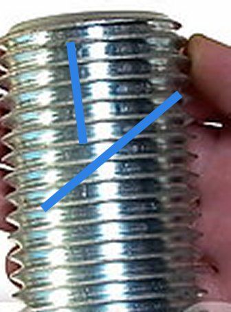

                    Thanks John P, a bit like screw cutting away from the chuck, something has to be reversed
                    #559281
                    Martin Kyte
                      @martinkyte99762
                      OK say the tap/hob has a 6 degree helix angle. In order to cut a straight spur gear you angle the tap/hob at 6 degrees to the blank.( Or the blank to the tap/hob). If you increase the angle you get a helical gear of one hand and if you decrease it you get one of the opposite hand.
                      regards Martin
                      #559289
                      Martin Connelly
                        @martinconnelly55370
                        Changing the angle of the tap changes the pitch produced so they may be of opposite hand but they will have different pitches.
                        Martin C
                        #559296
                        Martin Kyte
                          @martinkyte99762
                          No the pitch is set by the TPI of the tap. The approach angle of the cutting edge is set by the skew angle.
                          regards Martin

                              Posted by Martin Kyte on 21/08/2021 19:18:51:
                              regards Martin
                              Since the original post was regarding using a tap as a hob I will continue to refer to the process of using a tap as a hob. This is clearly not a tap but a bolt but the point is the same regardless, if you change the angle of the tap relative to the axis of the blank you change the pitch of the resulting gear. As I said earlier there is no quick and simple way of cutting accurate gears.
                              Martin C
                              Edited By Martin Connelly on 22/08/2021 08:34:21
                              #559342
                              Martin Kyte
                                @martinkyte99762
                                This is how I see it. In the same way that the pitch of the straight spur gear is dictated by the hob. The hob helix angle setting the set over angle. I agrre that the axial pitch of the helical gear will not be the same as the straight spur gear just by Pythagoras. However once you choose the helix angle of the gear you fix the set over angle of the hob. The pitch is then dictated by the pitch of the hob. You cannot just vary the set over angle to obtain different pitches. If you do you cease to generate an involute and merely alter the shape of the resulting teeth.
                                I'm not clear on how helical gears are specified but the pitch perpendicular to the helix (I would guess at calling it the helical pitch) will be the same as the pitch of the hob.
                                regards Martin

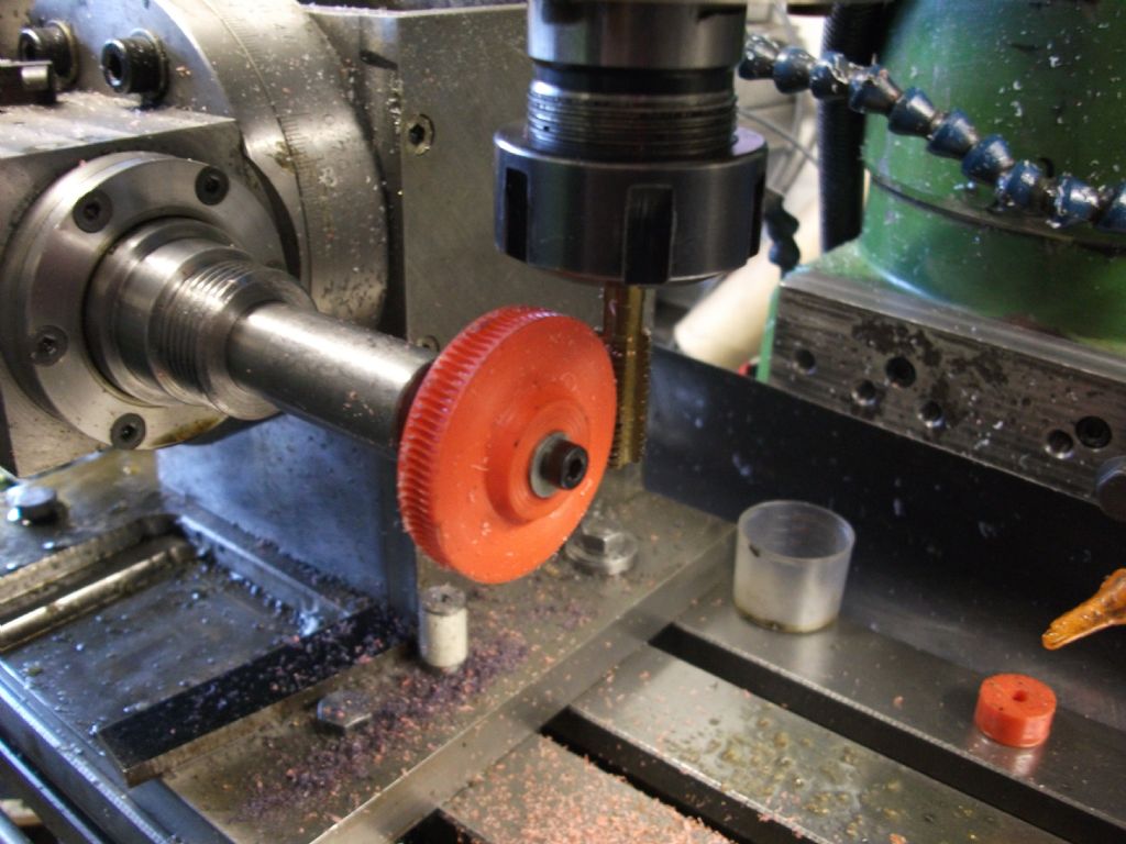

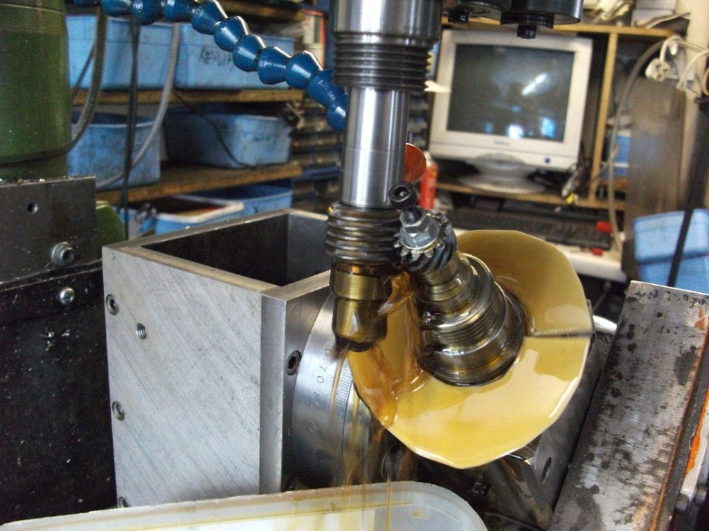

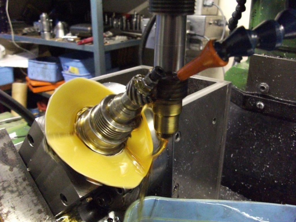

                                        Trying not to go of topic here. The OP 's aim is to be able to cut gears
                                        using a tap by free hobbing , whilst this can be done as some have shown
                                        on here quite successfully there is always the level of uncertainty as to the finished
                                        result The photo here is a 90 tooth wormwheel cut using a 5/16" tap the finished
                                        job works well using a piece of threaded rod, because this is done using a hobbing
                                        unit you get 90 teeth every time even if the blank is over or under size.
                                        90 tooth worm wheel
                                        It is possible to cut a spur gear using a tap providing the tap is set over at the helix
                                        angle and using the hobbing unit to time the motion .I think is less likely to be able to
                                        do the same with a tap or even a proper hob in a free hobbing situation ,the situation
                                        is worse with a tap and only 4 cutting edges as one cutting edge is disengaged
                                        before the next is engaged so the blank has to revolve 1/4 tooth pitch on its own
                                        with no driving mechanism,the most likely event is the cutting edge strikes the
                                        tooth wiping it out or gouging some of it away.

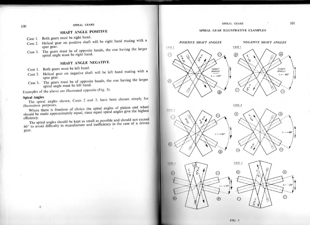

                                        In setting up the hob is inclined over at the angle indicated so the cutting action
                                        is parallel to the table traverse ,from this spur gears and helical gears may be
                                        generated in left and right hand using the same hob with no errors in pitch.
                                        The spur gears will mesh and run with the helical gears with no problems at all.
                                        The illustration here show the possible combinations and shaft angles.
                                        Shaft angles.
                                        Why is this the pitch of the hob dictates the pitch of the gear teeth and since
                                        the set over angle remains the same nothing changes in making any of these gears.
                                        The size of a helical gear will change for a given tooth count according to the
                                        angle of the helix and is calculated by blank divide by cos , angle.

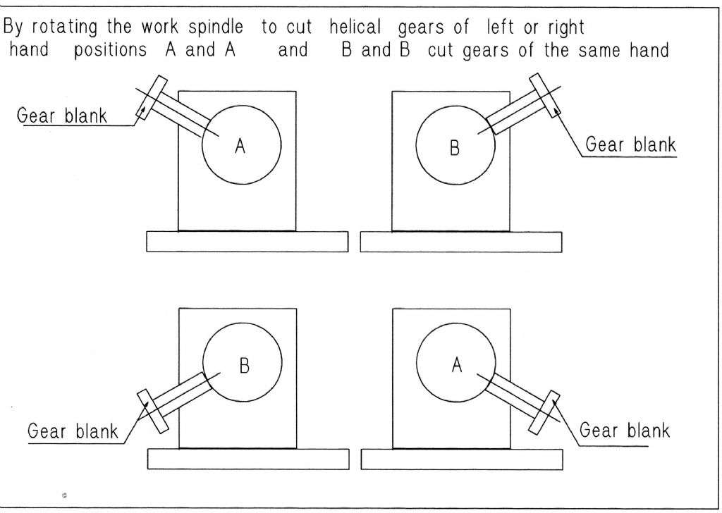

                                        The sketch here shows the hobbing unit work head and the positions to cut
                                        gears of the same hand and opposite hand ,this is really more to do with
                                        accessibility than anything else as there are instances where it is difficult
                                        to either fit the gear blank or get the cutter to a position to make the gear.
                                        As the hobber is connected to the hob electronically there is no problem
                                        in connection with the drive,the work head swings in an arc of about 250 deg.
                                        Work head
                                        There is however a variation in pitch if the hob is inclined at greater angle,
                                        an explanation of this can be seen in Ivan Law's book Gears and
                                        gear cutting on page 97 but has no real significance in cutting helical
                                        or spur gears as this can only be used when cutting worm wheels.
                                        At angles below about 3 deg this variation is ignored ,if the angle is greater
                                        the worm is cut to match the worm wheel.

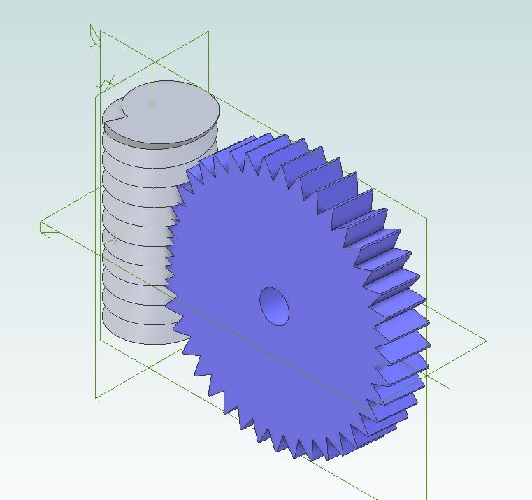

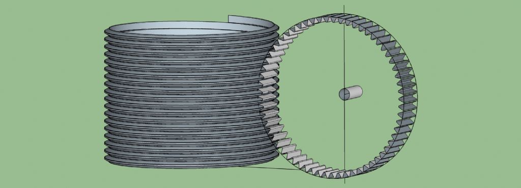

                                        #559376
                                        brian jones 11
                                          @brianjones11
                                          Well this topic has certainly addled a few FES pates, like stirring up the suds sumplaugh
                                          So to demystify the limits of plausible conjecture and give a platform to the deniably involved
                                          What else on lockdown Sunday morning from the desk within my Anderson Shelter
                                          I hope you can see the double helix (truncated Whitworth form BTW). I skewed 6 deg for fun and made from 2 identical blanks chived at the same time
                                          For the follically scarified, note that the yellow gear has been flipped over 180 to make the red
                                          also if you skew one gear wrt the other fractionally then you can mitigate backlash
                                          Now with the appliance of science I shall endeavour to make an animated version showing meshing and also the reviled tap attacking gear blanks
                                          My biggest challenge will be to post mpg or gif on this board, I havent seen any other Disneys on here
                                          Anyone know how its done – maybe Dropbox?, Ive never done a Youtube upload yet (do you have to sell your soul?)
                                          Sorry JP missed your eminent description above, most interesting
                                          As you point out, this OP is not about using hobbing gear and all the expensive industrial attachments involved, way off topic
                                          The point being that a hobbing method ties the spindle mechanically to the mandrel in much the same way as screw cutting on a lathe (excluding the tedious divider plate method)
                                          This is examining whether FREE HOBBING has a place for the hobbyist NPI.  Its clearly demonstrated in making simple worm gears so this is just an extension of the topic. As seen above there are a lot of armchair misconceptions.
                                          One point to note is that theoretical errors can creep in
                                          eg
                                          a) say you want to make a ruler with a 1" block.  Use it to scribe 12 marks then do you have 1ft – well clearly it depends on the accuracy of the block.  Hope you can see the implication of cumulative errors
                                          b) Instead use the basic tech drawing trick use the block to make 12 ticks then project that onto a 1ft line and you have your accurate ruler with 12 inches
                                          So the tap method is using method a)  and the dividing plate (or hob) is using method b)
                                          Now thats the theory but what happens in practice
                                          Edited By brian jones 11 on 22/08/2021 12:44:19
                                          Edited By brian jones 11 on 22/08/2021 12:46:01

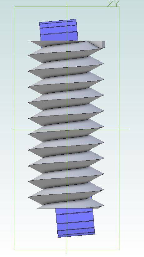

                                            #559397
                                            brian jones 11
                                              @brianjones11
                                              OMG the Monsignor is RIGHT
                                              10^3 apologies, I have flipped my gear blank wrongly????????. I will have to investigate
                                              You do indeed have to angle the tap anti clockwise 11.4 deg for a 10 tpi (5.711deg ha)

                                                  I thought I could pluck a ready made model of a whitworth threaded rod/bolt easily, turns out to be all clickbait stuff so had to start from scratch which also turned out i will gouge some flutes tomorrow
                                                  I still have a cunning plan
                                                  I wonder if a spiral tap might solve the problem
                                                  Edited By brian jones 11 on 23/08/2021 20:37:46

                                                    Brian looking at your sketch t looks like you have the tap(hob) vertical which is OK but you also seem to have shown the gear blank with it's axis horizontal rather than tilted by the helix angle of the tap. Unless the much larger diameter tap you are now using has a very shallow helix angle that means the tilt of the gear can't be seen. If you don't tilt the gear axis the tap will act like a roughing mill and just chew its way into the gear.
                                                    This is with a 1/2" tap

                                                      Yes JB indeed my model needs more realistic sizing. By the time I had sorted my cad problems I was knackered
                                                      What do you think of a spiral tap?
