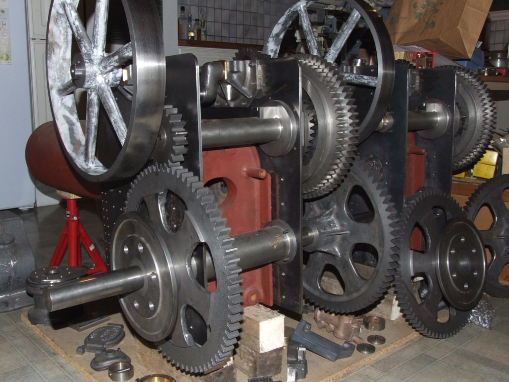

          Posted by Nathan Sharpe on 19/08/2021 22:39:29:
          If I were to use the same tap to cut a number of gears with varying diameter with the same tap would they mesh or would they not? Yes, they should do, although I've never tried it.
          If I were to introduce a "worm" of same thread between gears would I be able to build a gear train to increase/decrease speed? Yes, the worm wheel I showed being made with a tap mates smoothly with a screwcut length of 7/16" UNF thread. However, it will only decrease speed. The worm wheel will not back drive the worm unless the helix angle of the 'thread' is much larger.
          I've never cut a gear in my life so have no idea, would like to know where to start If I wish to! Making a non-critical worm drive is fine using a tap. For spur gears I wouldn't start here.
          See answers embedded above.
          Andrew
          #559082
          Martin Connelly
            @martinconnelly55370
            Driving the blank with the hob only puts pressure on one side of the tooth form. As the hob is advanced from one face of the blank to the other the amount of rotation force varies, only a small amount at the start and end and maximum rotation force between these extremes. That will result in a less than perfect tooth form that is unpredictable. Going from one face to the other at different rates will introduce other variables into the process as there will be additional wear on the pushed face from a long slow cutting action compared to ploughing through aggressively. Driven blanks in a real gear hobbing machine do not have this issue of one sided pressure on the tooth form and form tools in an indexed setup will also be free of it. Using the free hobbing method is only good for one thing and that is light duty worm drives where there is no need to worry too much about the tooth form or contact face but even here it is important to not overdo the cutting because even when the tooth form is completed you can carry on removing material from one side of the teeth until all the teeth are worn away.
            Trying to make spur gears with a free hobbing method using a tap will produce teeth with an odd pressure angle so will either wear faster with fat teeth under load or have thinner teeth than standard gears and so be more prone to breaking. Standard pressure angles have been chosen to give the best compromise between the strength and the wear of gear teeth.
            Two worm gears cut using the free hobbing method will not mesh unless the blank is moved through its full thickness relative to the cutting tool, pointless even considering it.
            Anyone who has ever cut gears will know that there is great satisfaction in it because it is not a quick and easy process however it is done and there are no simple shortcuts.
            Martin C
            Edited By Martin Connelly on 20/08/2021 08:40:53
            #559083
            Anonymous
              Posted by Martin Connelly on 20/08/2021 08:36:56:
              Anyone who has ever cut gears will know that there is great satisfaction in it…………
              Cast Iron Gears
              Must be careful not to get over-excited. teeth 2
              Andrew

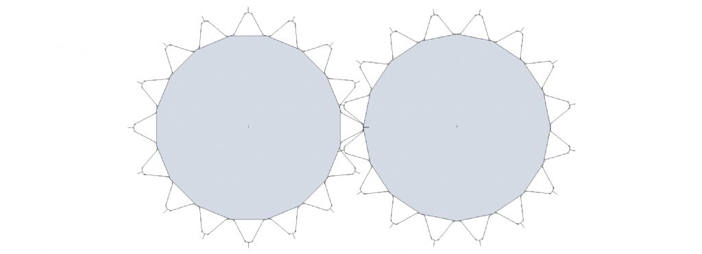

                            brian jones 11
                              @brianjones11
                              Yes indeed I fully recognise its a crude method hence "rogue method" but there maybe some mileage for simple apps
                              After all there is a whole science you could spend years on perfecting the perfect tooth cos users wanted efficiency and also quiet operation and long life
                              none of the above would be satisfied by my dirty method
                              As you can imagine it would vibrate under load
                              Something tells me this isnt the thread form I am going to get, it doesnt feel right, I am assuming a tpi tap of 16
                              Perhaps its why members have reported that they didnt get the number of teeth they expected? Hmmmmsarcastic 2
                              Edited By brian jones 11 on 20/08/2021 15:52:22
                              Edited By brian jones 11 on 20/08/2021 16:56:55

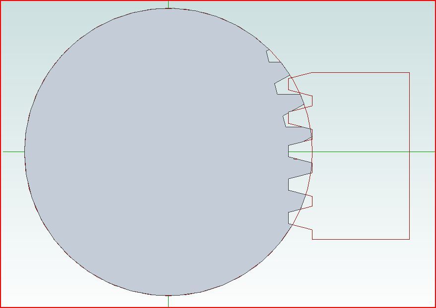

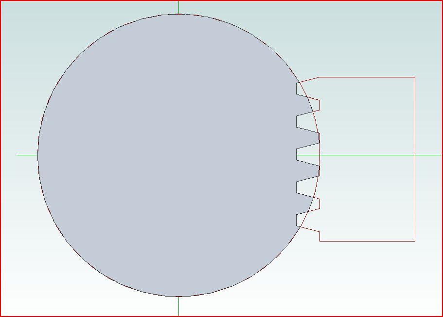

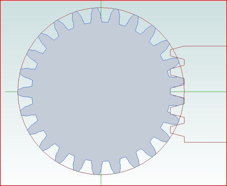

                              #559151
                                You will probably get a bit more curvature or faceting of the teeth as the tooth above and below the central one on the tap will take a small amount off the gear teeth above and below ctr height, more so on larger gear tooth numbers
                                Couple of sketches I did some time ago to illustrate the effect, you will also get this with the cutter Dave (SOD) shows and that is why one cutter does all gear tooth counts unlike commercial involute ones where you may need several.
