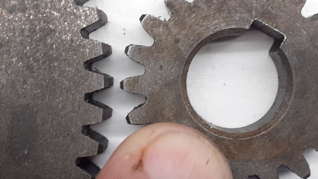

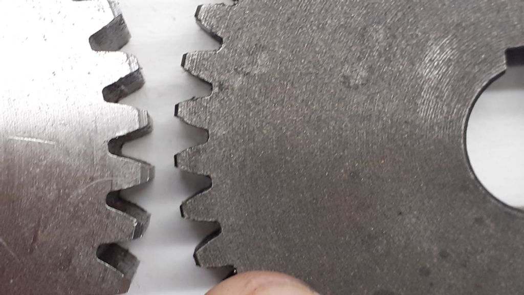

        #566284
          Dave the reason why lathe change gears are often done with a strip of paper is that it is a darn sight easler than calculating the PCD for the pair and trying to set the banjo studs to that PCD. Also has the benafit of compensation for worn studs and bushes on the machine as well as any wear on the gears
          Funny enough I've just taken some photos, will post in a while.
          #566289

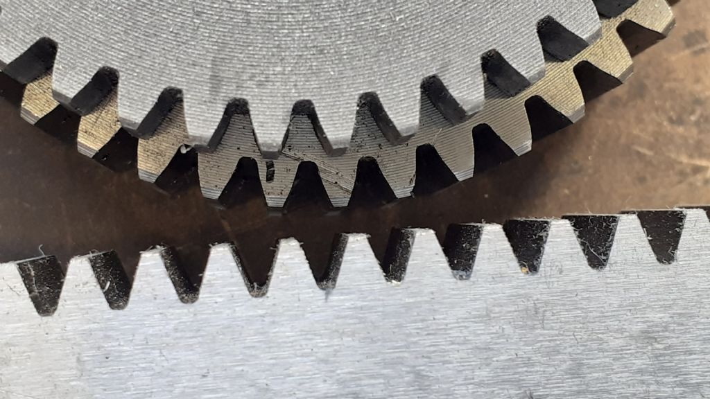

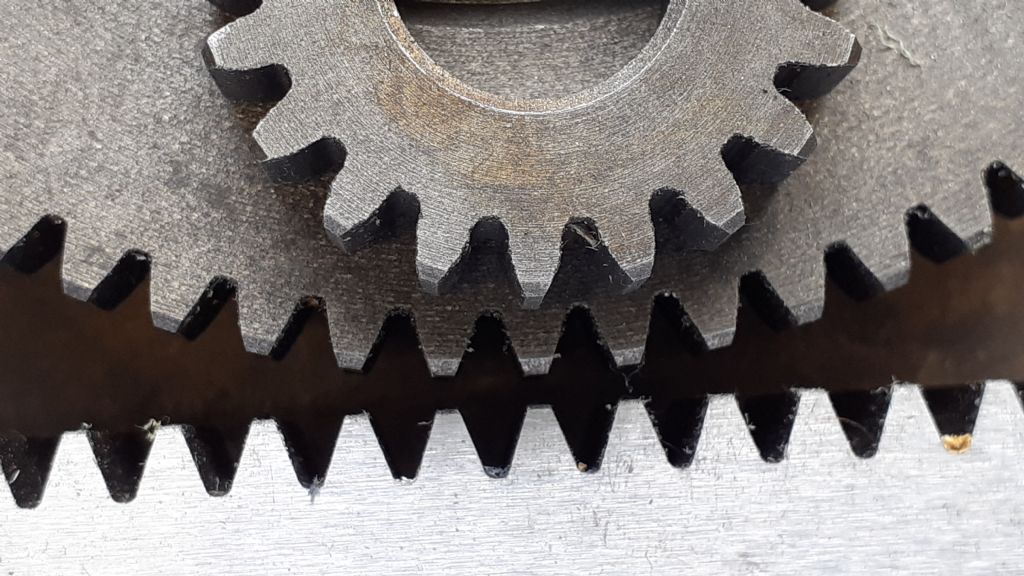

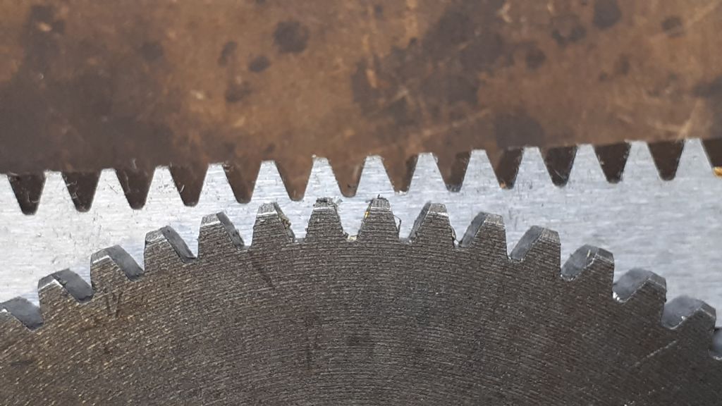

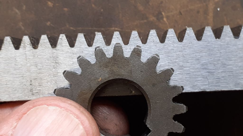

            So as I said it really depends on what gear you pick up and look at as to whether it looks straight or not. Here we have the 25T and 70T change gears from my lathe which are MOD1.5 20pa, easy to see the smaller gear on the right has more curve than the larger one on the left though I can still see a small amount of curve on that.
            Next lets compare the lathe change wheel with a bought in commercial gear of reasonable price from Belting on line. 45T change wheel on right, 46T bought in on left not a lot of difference, both show curves.20211010_145516.jpg
            If we now lay the gears on a rack it is easy to compare the straight sides of the rack to the shape of the gear teeth, 25T first
            Then 70T
            Now the 45T lathe gear laid on top of the 46T commercial held opposite the rack
            Finally the 25T and 70T against the rack
            So I would conclude that my far eastern lathe change gears are not a lot of difference to commercial gears and certainly none are straight which makes me wonder why if Myford ones are straight people pay good money for them. devil
            Now if I wanted some cheap plastic gears as I have said before 3D printing would be the best way to go. For that you need a 3D model to print so here we have 25T gears laid on 80T gears, 20pa on the right, 14.5 pa on the left and all com out with correctly curved faces using the CAD to generate the tooth form also predictable tooth count. PCD, profile, PA etc.

            #566293
              Posted by JasonB on 10/10/2021 16:14:57:
              Myford change gears are 14.5° Pressure Angle
              To the uninitiated free-hobber, they might therefore appear straight [ish]

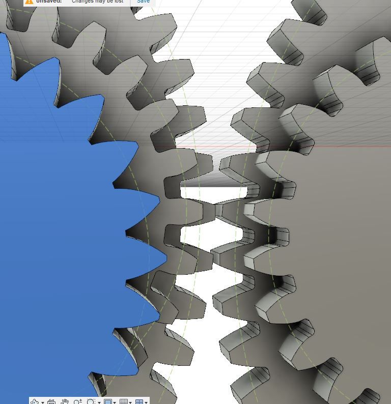

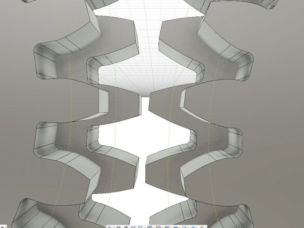

                Indeed and that was one of the reasons I included the last image from F360 and there is not a lot of difference between the two so if visible on a 20pa should be on a 14.5pa too subject to tooth count.

                  here is what the uninitiated free-hobber may end up with if using a 60deg thread form tap or bolt as a hob laid ontop of the 14.5pa gears this one luckily to turn out to be 25T

                        Posted by JasonB on 10/10/2021 17:01:22:
                        here is what the uninitiated free-hobber may end up with if using a 60deg thread form tap or bolt as a hob laid ontop of the 14.5pa gears […]
                        Q.E.D. yes
