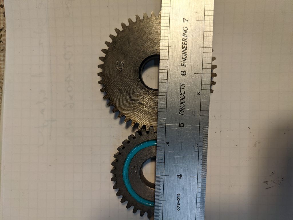

                                        Going back a bit nearer topic I am fairly sure the Myford manuals tell you the gear standards, so you don't need resort to measuring etc.
                                        I must admit I have never thought the headstock gears and the change-wheels on my ML7 either "crude" or "square"; whatever those were meant to mean. If my screw-cutting comes out ragged, I blame the operator not the machine!

                                          Myford and most other lathe gears are 'good enough' rather than well made. The main disadvantage of their relative crudeness and imperfect curves is noise. Vintage car gearboxes use basic gears and the whine is all too obvious, but lathe gears don't work that hard. Backlash is also evident, but doesn't matter when screw-cutting or anything else lathe related.
                                          Putting the best possible gearing into a lathe is a waste of money unless the machine needs to be as quiet as possible or is exceptionally powerful. Myford lathes, bless 'em, aren't powerful!

                                            Though I doubt that they made especially crude gear cutters just for Myford! However they are 14.5* PA which I think will make them look squarer. This from the late great Sir John in 2012:
                                            "Jim,
                                            I can't comment on the rack or it's mating pinion as I don't have any details on these but could get them if I wanted.
                                            However as regards the screw cuting gears they are all 14 1/2 degrees PA with the exception of the first 4 on the Super 7 and like family.
                                            The first 4 being spindle gear, the two tumblers and the gear the tumbler drives. These are 20 degrees PA.
                                            Outboard of this they are all 14.5 degrees.
                                            The ML7 are all 14.5 including back gear but the backgear on the S7's is special and requires a special hob as the tooth form is modified.
                                            John S."

                                              It is a strange thing. Of every manual for every machine tool that I have ever come across, the gear specification is never mentioned.
                                              As a few examples: Myford 7-series; Colchester Bantam, Chipmaster, Student; Harrison L5, 140, M-xxx class; Boxford. Look at every Asian-sourced lathe available new from UK suppliers – how many of them mention the change gear spec.?
                                              You might also explore mills that use change gears (e.g. Harrison, Deckel, Alexander, early Beaver).
                                              It is notable that change gear specs. are hard to find on lathes,co.uk, perhaps the most comprehensive resource available.
                                              Also surprising is that in the many years since the web has been part of our life, no-one has produced a compendium of this information.

                                                I guess if unkown gears seem to conform and mesh ok with std forms then you can guess what the spec was (all thanx to AGMA of course)
                                                but if its a modified form, how do you measure it without resorting to sophisticated optical equipment?
                                                let alone say you have to make a replacement to mesh with an existing gear
                                                If its CI then you cant just TIG weld some new teeth and re machine AFAIK
