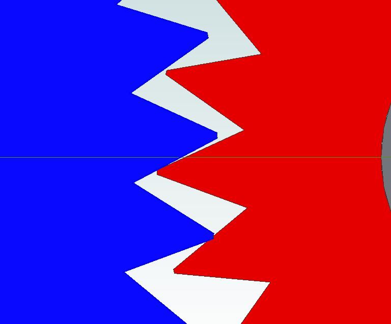

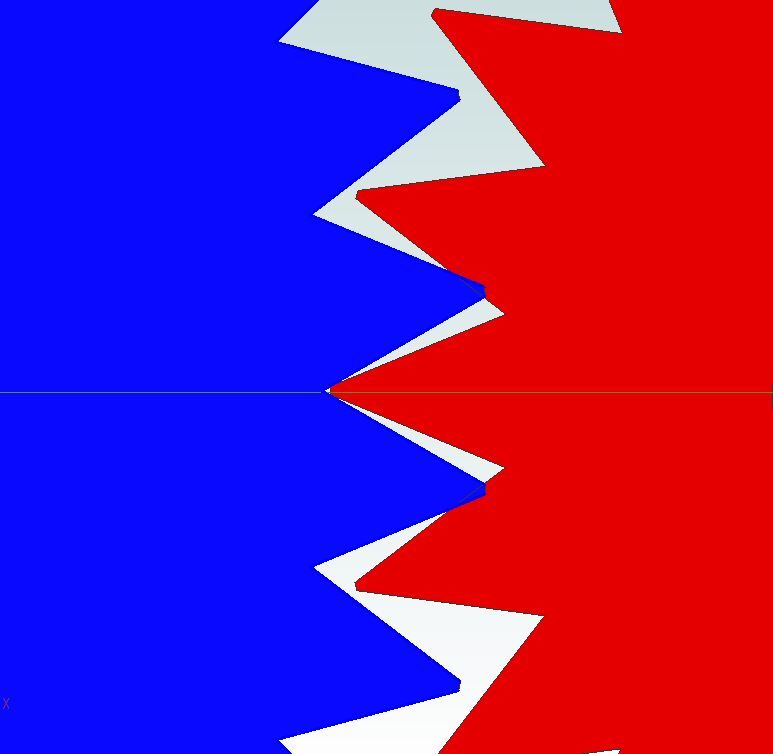

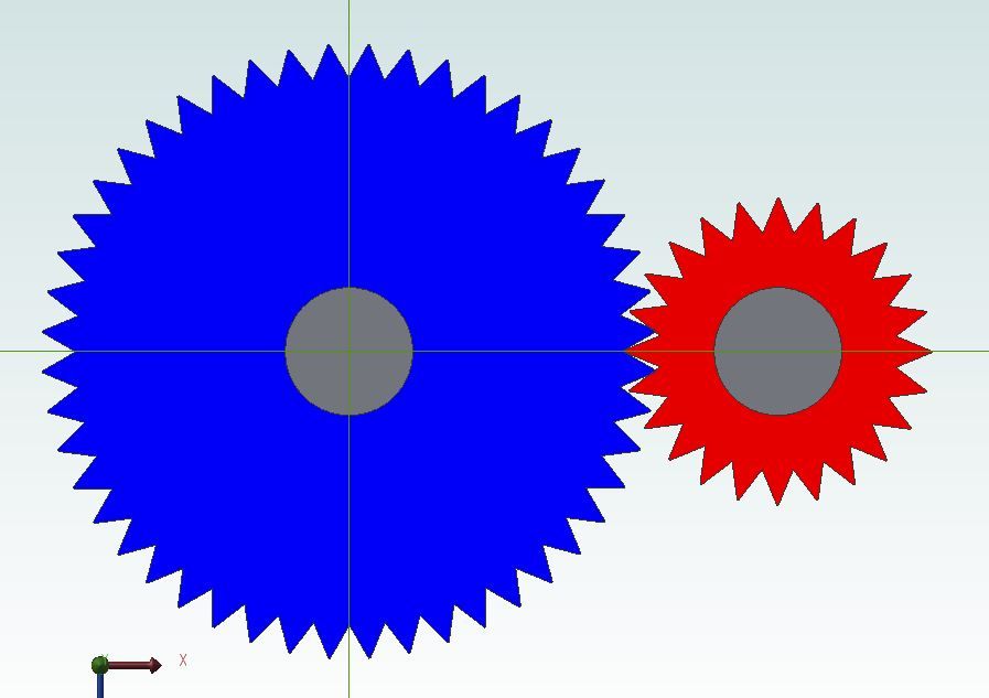

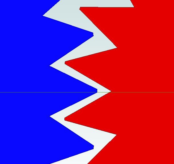

                                        I think I have worked out why it's taking Brian so long to come up with a workable set of 2:1 gears.
                                        he posted this as his KP (nuts? ) method showing the tooth form from his single helix cutter
                                        Now it may give a pair of gears with the same number of teeth that may just pass as usable but oh dear look what happens when the same cutter tooth form is used for different tooth counts, in this case a 48T "meshing" with a 24T
                                        Looks OKish from a distance
                                        But close up the lack of an involute and the thinner teeth that result from using the same cutter on a smaller gear start to give problems as the tips of the gear teeth either side of the meshing ones start to clash with the flanks of the other
                                        Not a problem for Brian as he has not got any specific PCD or shaft centre distance to worry about so just move the gears further apart he will say. This is about as far apart as they need to go so there is no overlap.
                                        But keeping them at the same PCD and rotating the gears shows a little bit of backlash may be presentcrying
                                        This is why the spring washer of single turn of helix on the hob is no use to most people.
                                        #565424
                                        John Haine
                                          @johnhaine32865
                                          But surely if the cutter is triangular it should cut an involute tooth?
                                          #565428
                                            There should be some rolling that will give some curve which Brian has not included in his drawing but being just a single Vee will not produce an ivolute which is why a hob as several turns of the helix

                                                  Actually JB your spikey gears could have some merit
                                                  if you truncated the tops of the addenda say 5% and then run the gears together with a bit of load/speed in some abrasive flour or fluid of some sort I believe they would rapidly "run in" and settle down to be less noisy and become quasi involute
                                                  As you have the gear to make it so perhaps you could run a little trial for us to learn from
                                                  It could be quite cheap to make up a triangular tooth cutter – even a 20deg compliant one
                                                  WaM
