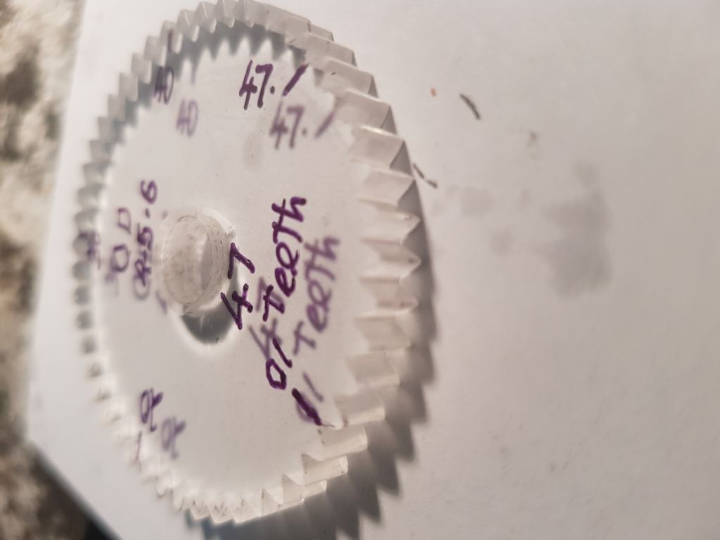

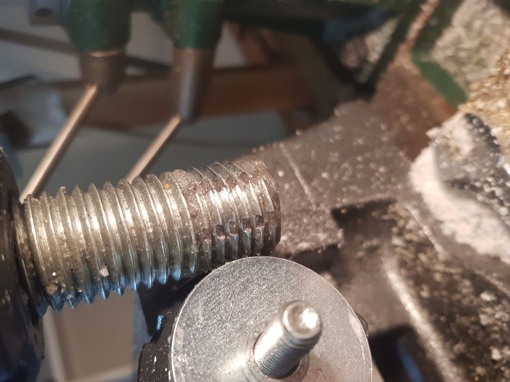

            suffice to say this is the result of an M24 screwed rod piece with 6 slots milled in sides to make proper cutting edges
            i used a 3mm carbide end mill, it lost its edge after 6 slots ie 3 inches – is that normal for MS?
            Once set up it only took 5 mins to make a gear
            45mm OD 3mmCP 47 teeth
            I made two mesh ok

            My secrete weapon worked but only gave me 2.1mm CP
            it was made from a spring washer
            the largest in 30mm but would need lots of eng to hold it properly and i havent got a TIG welder – shelved
            I can get an M24 HT bolt gr 8.8 but would probably have to grind the slots accurately somehow using a jig

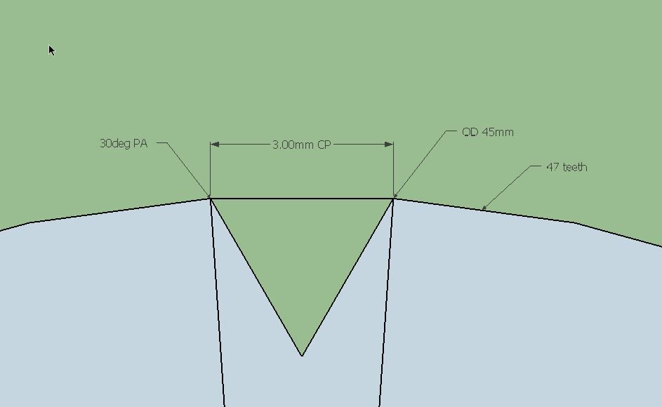

                                      Now here is my first bash a the polygon approach to gear numbers from the example above
                                      47 teeth OD 45mm CP 3mm. The diag shows a compliance within 130mu OD error almost negligible
