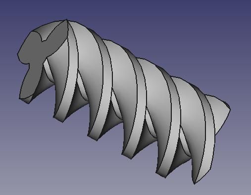

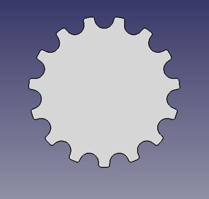

                        #564187

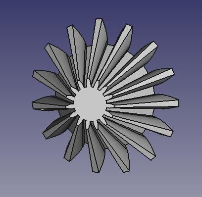

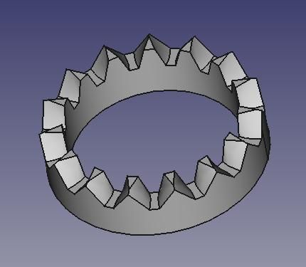

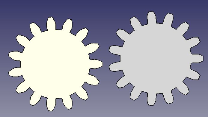

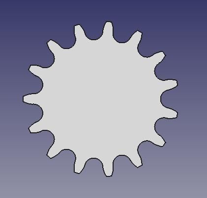

                          Posted by Andrew Johnston on 24/09/2021 20:15:58:
                          Spur gears are simple compared to other types of gear. Gawd help us if we ever get onto other types of gear!
                          Andrew
                          These examples are from FreeCAD's 'Gear' Workbench, which may be downloaded from Tools->Addon manager.
                          1. Involute and Cycloid side by side: although the difference isn't obvious these two gears don't mesh properly:
                          2. Bevel Gear:
                          3. Crown Gear
                          4. Lantern Gear:
                          5. Timing Gear
                          6. Worm:
                          7. Hypocycloid gear.
                          The hypocycloid form, with or without pins, is a new one on me. Looks hard to make – anyone know what they are used for?

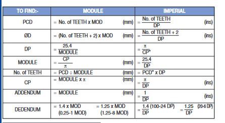

                              Here is a typical example of how industry and teachers present these gear calcs to us
                              2021-09-25 10_30_35-c29 755-821 technical - 27.48-27.60.pdf ? mozilla firefox.jpg
                              Just slipped in amongst other credible bits of algebra – 2nd from the bottom
                              No explanation or qualifier – btw its a fudge factor we use for convenience so that OD is (N+2)/DP
                              It falls down when Profile shifting is used to reduce undercut and if peaks are truncated as in stub gears
                              No mention of this
                              and the whole industry and educators are perpetuating this algebraically illiterate myth
                              Addendum = Module
                              and furthermore the word "pitch" should never been attached to "Diametral" as a descriptor for a gear size factor
                              Its wholly misleading – call it Diametral Factor" great no problem
                              Europe opted for Module equivalent to 1/DP and set Addendum = Mod in mm. Thats the teutonic mind for you
                              Thats sorted then
                              Another first for MEW

                                    Brian, the table that you copied above is a summary for the practising designer, not a presentation of the theory. No one wants to have to go back into the algebra when they want to do a quick calc and there's no reason to present any underlying theory in such a table. If you want to see it there are mechanical engineering textbooks that go into as much detail as you want. When starting to learn a new and complex subject it's common to get frustrated by the way details are presented and blame the messenger, you just have to work through it.
                                    I don't think anyone else here has expressed any disquiet at the use of the term DP or module, you'll just need to get used to it. I don't think the gear industry or their users are going to change the way they express things just for you.
