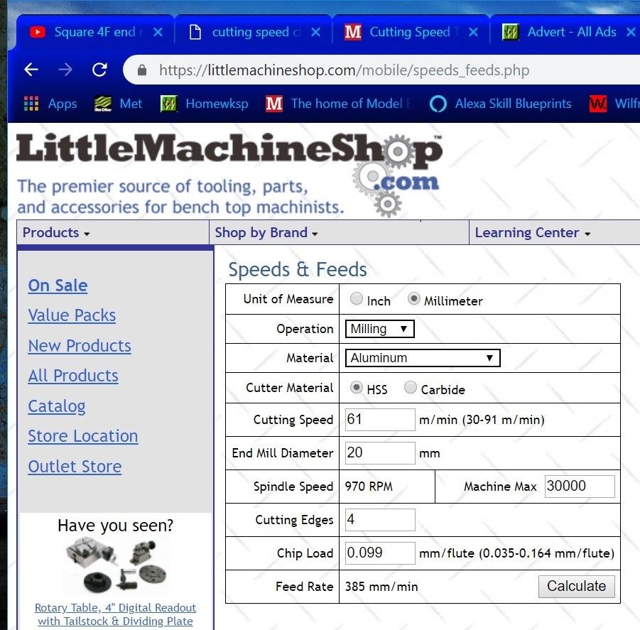

                    To use the table that started this thread your cutter is Ø20mm and the material is aluminium. This gives a speed from the Ø19 line of 1006rpm. Consider this a maximum speed if you have a machine with enough power at this speed and choose something close to it eg 1000rpm would be fine but lower would also work.
                    What this table does not tell you is feed rate for milling. It is important to keep the cutter cutting not rubbing as earlier posts have stated. If we take the rpm to be 1000 for ease of calculation then we need to look at tooth load and number of flutes on a cutter. Let's go for a tooth load of 0.125mm or 0.005". First we can consider two flutes, this will give a count of 2×1000 = 2000 teeth per minute at the cutting point. In order to give a tooth load of 0.125mm we need to multiply the teeth per minute by the tooth load and we get 2000×0.125 = 250mm/minute as the feed rate. If we put the figures in for 4 flutes we get 500mm/minute as the feed rate.
                    So if you want to cut at the correct tooth load with a Ø20 milling cutter with 4 flutes you need to feed the material past the cutter at 500 mm per minute or 20" per minute.
                    Can you achieve this? It will depend on your choice of hand cranking, power feed or CNC on you machine. If you are hand cranking I think you should time yourself over a suitable distance to get an idea of the speed you need to go. Similarly if using a power feed you should find what speeds you get for the available settings. Using smaller cutters with higher rpm will require even faster feed rates.

                      #390585
                      Richard –
                        @richard-3
                        Out of interest a similar exercise as Martin using the free speed and feed calculator as provided by Little Workshop
                        Might help
                        Richard
