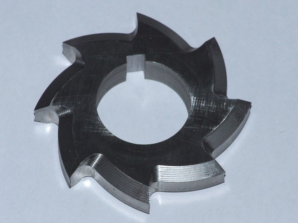

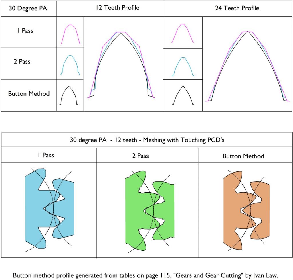

With regards to forming the flanks of the single tooth cutters that I use. A series of photographs recently appeared in the thread on my design for the Myford Tailstock dial. Or you can find them in my album.

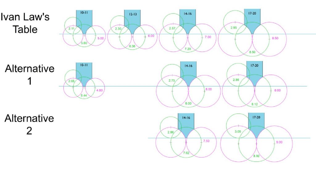

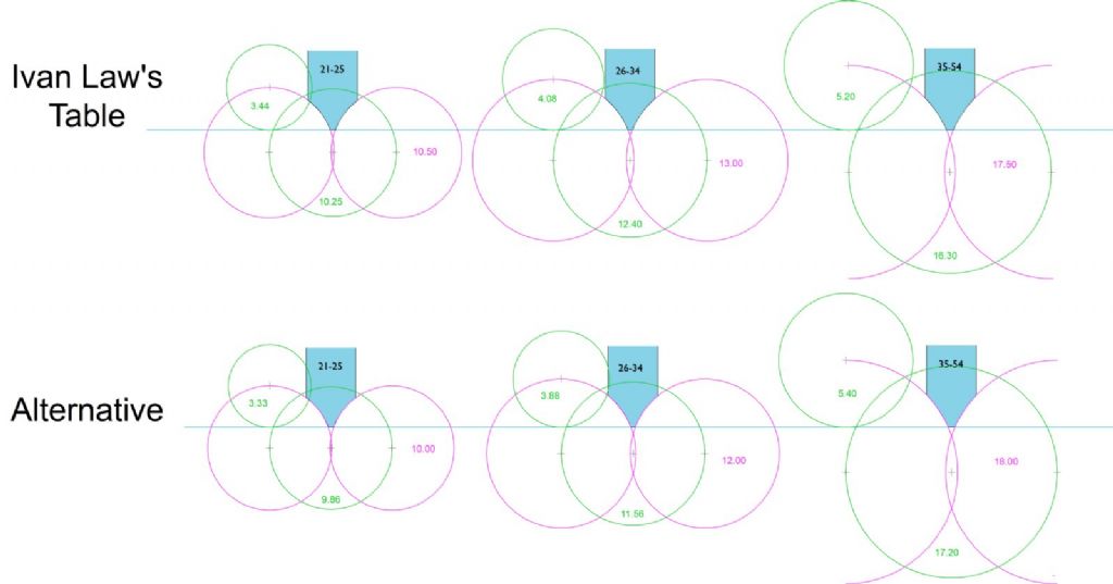

As regards the flank radius this is always going to be a compromise. B&S cutters cover a range of teeth per cutter. For obvious reasons the cutter will have to be made to cut the smallest number of gear teeth in that particular range. Thus those at the top of that gear cutters range are going to be a compromise.
I design my cutters to suit each gear used, that way the teeth are as close to a hobbed profile as I can get with a form cutter. These gears run extremely smoothly together because of this. While I draw and work exclusively in Metric very often an Imperial cutter is so close that it is not worth worrying about, so I use that.
