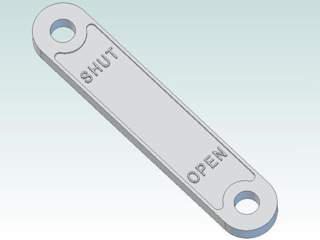

Thanks for the replies, plenty to think about. To avoid confusion this is the current CAD model of the part:
For scale the width of the part is 3/8" and the lettering is 0.08" high. Material is low carbon steel.
The supplier I was looking at was Drill Service, about the same price as APT and a quarter the price of the YG cutters from Cutwel! Sadly Drill Service don't provide any detailed cutting parameters. I found something from Harvey Tool where, for a 0.015" cutter, they recommend a chip load of 0.00009" with a depth of cut of 1D and radial cut of 0.13D for finishing in steel. They seem quite agressive depths of cut. Out of interest I looked back at my CAM files for the governor bevel gears (1mm ballnose in bronze) and the smokebox nameplate (1mm endmill in engraving brass) and I ran both cutters at 24000rpm and 350mm/min.
I'd thought about engraving cutters, but assumed they wouldn't be good for raised lettering; is that a misconception? Special thanks to Adam for his generous offer, which I'll keep in mind as I decide which way to go. I have some engraving cutters from Arc but they have a sharp point unlike the Taylor Hobson ones.
I had rather assumed that I'd need to pocket out most of the metal with a larger cutter and use the small one to re-machine just the detail. But oddly the CAM system doesn't think it'll take long to do the whole thing with the small cutter. Likewise using a tapered cutter and V-carve was suprisingly quick.
