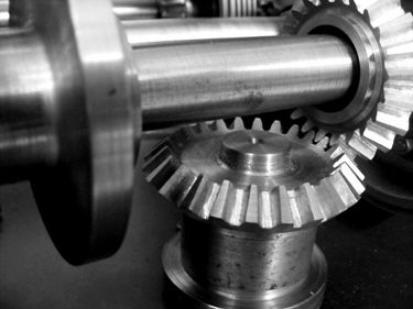

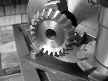

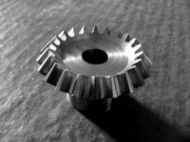

        I decided the prudent thing to do after all the information was to try a couple of practice runs to get a feel for the operation. One of my better decisions. Not having had much experience of driving a dividing head I found the time well spent. Because I had to set the dividing head at an angle angle on the milling table right next to a wall visibility was not good and mistakes were easy to make so several blanks were used.
        This first two examplesboth seemed a bit thin on the crest of the teeth but I don't know why. To make sure the centre height of the cutter was right I made a gauge to put under the cutter face after measuring the distance with a piece mounted in the chuck with slip gauges and feelers. I also made two others for use with the cutter offsets and used then to position the cutter height.
        I must confess that I found first gashing the teeth at cente height and then two other positions bloody confusing with having to reset the gear position twice so I elected to use a slightly different procedure.
        My first action was to offset the cutter downwards, lock the quill and do a shallow gash for the full number of teeth. This had two effects. Firstly it calmed my nerves and secondly it got me familiar with resetting the the dividing prongs. I also made sure that I turned the dividing head clockwise to rotate the gear anti clockwise.
        After the first gash I went around again and cut to full depth. The results are shown below. Instead of winding the dividing head on a quarter of the indexing angle I wound it on a half of the index angle – 20 holes (anti clockwise on the handle = 20 holes clockwise on chuck) for the 22 tooth gear – raised the head twice the offset -0.112" using the DRO – and locked the quill. I then went around the second time winding the handfle clockwise this time so that the gear rotated anti clockwise. I don't know why but the result was much better.

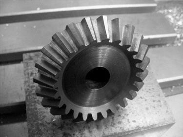

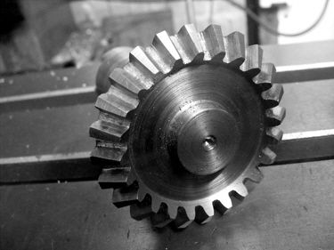

            Carrying on fromu before Christmas I can now put up a couple more pics of the two 24 tooth gears that came out much better. Only problem I had was that one was made from EN9 ? and the other from EN24 because of the duty it was to be subjected to. One cutter startedto go blunt and had to be changed to tackle the EN24 and I then found that it lost a few thou on the depth of cut which meant resetting. Apart from that hiccup they seem to run together with their 22 tooth partners ok but may just need som finaldressing with a file.

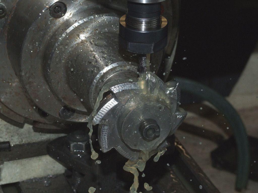

                  CNC is the answer. wink 2 Here's a cutter being machined in gauge plate, with proper relief, and intended for cutting splines:
                  I used an uncoated carbide 6mm ballnose cutter. Total machining time was a shade under 4 hours at 3000rpm and 150mm/min feed.
