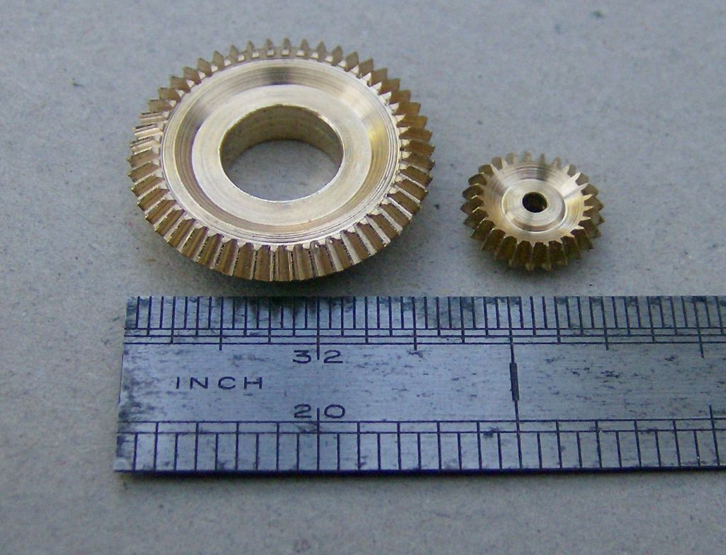

            Hi Geoff,
            Two essential points:
            1 there is an error in Ivan's book. On P108 column 2 the calvculations for o/dia small end and o'dia big end should BOTH use COS not SIN.
            2 Ivan's cone angle is HALF the included angle so, assuming your bevels are at 90 degrees the angles are 42.5 and 55.5.
            I have made asymmetrical bevels using Ivan's method and they worked! If you have any furher questions – just ask

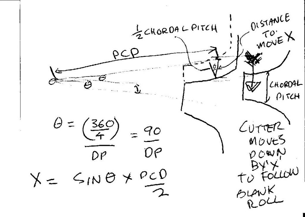

                            I have been looking again at the formula for establishing the movement off the cutter in conjunction with the rotary movemet of the bevel being cut.:-
                            Formula :- Offset = Half Chordal Thickness X 1/2 PCD X SIN Included angle (which in my gears will be 85 & 95 Degs).
                            Can anybody tell me the logic to this formula and how it is derived? I am trying to understand it's physical relationship to the gear being cut and the drawings in Ivan Law's book.

                              Hi Geoff,
                              Offset = half chordal thickness = 1/2 PCD X SIN included angle
                              The 'blank roll' is 1/4 of a tooth pitch.
                              The 'chordal thickness' is the distance across a tooth on the PCD i.e. the width of the cutter on the PCD or 1/2 the pitch if the gear was a straight rack).
                              To follow the blank roll around 1/4 of a tooth it has to move by half this distance (chordal width/2) and adjusted for the angle of the blank roll. This angle is where his example of 90/20 comes from 360/4=90 and 20 is the DP of his gear.
                              So imagine a right angled triangle with an included angle theta at the centre of the gear. The hypotenuse is the PCD of the gear and the opposite side is the distance the cutter has to move to keep itself lined up with the small end of the teeth. (Note that PCD must be measured as the true diameter at the small end of the bevel.)
                              As SIn = opposite over hypotenuse the distance the cutter is offset (opposite) = sine * hypotenuse
                              It would have been VASTLY easier to follow if Ivan had used the exactly equivalent formula of:
                              CUTTER OFFSET = SINE (BLANK ROLL) * PCD OF SMALL END OF BEVEL
                              Hope that helps. It has confused the hell out of me. Careful study of the picture on p. 110 helps, or see below.
                              Finally, if you have the courage and the eyesight, you can just execute tha blank roll and very carefully realign the cutter with the small end of the gear – this way you would HAVE to cut the theoretically unnecessary central cut first.

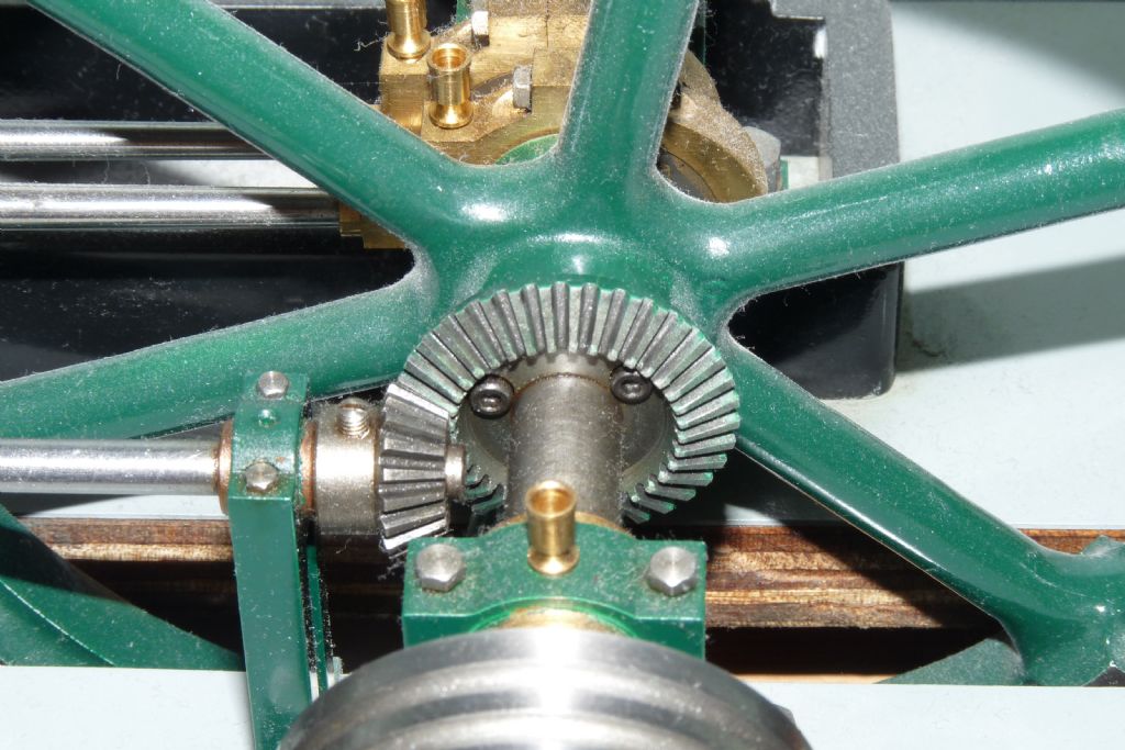

                                                A picture of the bevel gear on my Stuart Victoria –
                                                Hadn't realised how dusty that engine was! Anyway – point is that the teeth are parallel in depth and not parallel across the tooth. The teeth do look better in the flesh, honest!
                                                Other photo's in my "Victoria" album.

                                                Sub Mandrel
                                                  @submandrel
                                                  They look good to me , Steve.
                                                  #136754
                                                  Stovepipe
                                                    @stovepipe
                                                    Agree with Neil – they look good anyway !
