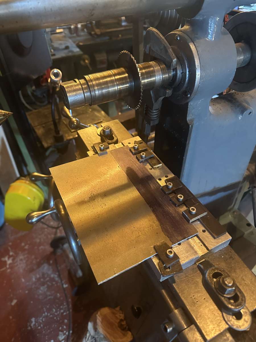

      That is really interesting Michael, thanks. A much simpler design than I was contemplating, basically a fence and a clamp.
      #693051
        Here’s a useful photo of one in action, Steve:
        https://www.hobby-machinist.com/gallery/myford-saw-attachment.43817/

                The Myford saw table is a good suggestion. I hope it is clear that on the attachment, the table is fixed to the cross slide of the lathe and thus moves in and out relative to the blade. That is why the stock can be clamped firmly to the table.
                Again, in the woodworking world, it is analogous to a sliding table panel saw.
                The set up would work on your mill. If you wanted use it on the bandsaw, you’d need to make a sub-table that can be pushed across the one shown in your photo.

                  If you’ve a horizontal mill I’d thought that the obvious choice – accurate cut and a finish needing little or no cleaning up beyond de-burring. Alternatively use a vertical mill with the material clamped to an angle-plate.
                  You might need bet a bit ingenious with the clamping if the stock is wider than the table slots; e.g. using a piece of old laminated chipboard (ex-cupboard material) as an extension table you can also saw into.
                  Yes, a bit slow but no worse than any other method.

                    If you have a vertical miller available, how about placing the workpiece in a vice, (vertically with long side horizontal, with free ends suitably supported) and use a slitting saw to cut your slot.  You may have to finish the very last bit with a hacksaw!  The machined ways in the vice base would be your datum, thus ensuring a parallel cut.
                    Another suggestion, for a horizontal miller.  Bolt flat down on the table, against suitable datum stops, and allow the slitting saw to break out into a Tee slot.

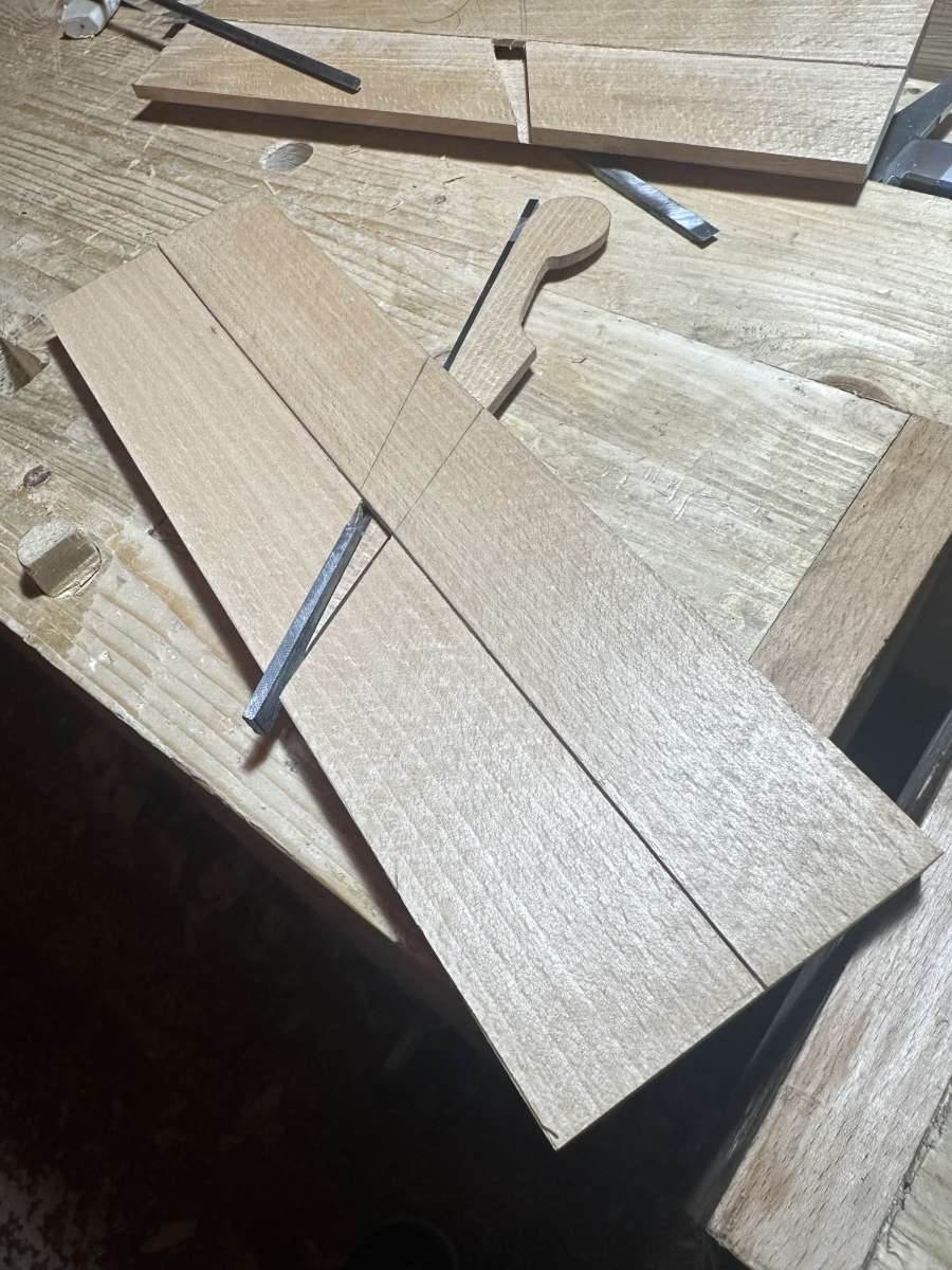

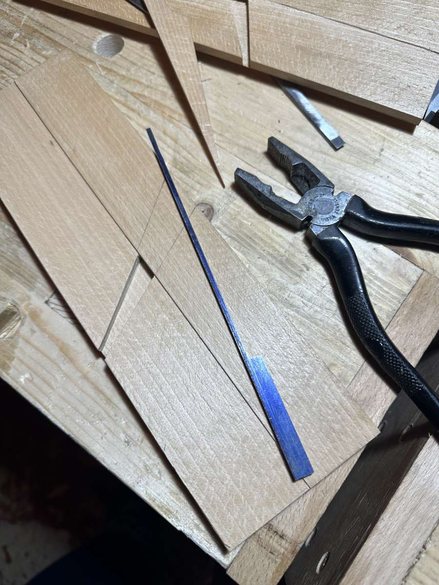

                      Well…. My new bandsaw blade came and it did indeed cut the O1 pretty nicely. BUT …. not cut straight. I mean, it’s fairly straight, but it needs to be properly straight. I spent more time trying to clean it up with a file and the surface grinder than I saved by using the bandsaw. Anyway thanks to whoever made the suggestion, it was a good idea in theory.
                      Also, it left behind an edge on the waste, which was similarly not straight, which causes a problem for the next plane blade I want to make from that piece of O1.
                      I think I’m back to making the jig.
                      Here’s the cut metal, with its 3/32” tang. Not an easy cut to make. Most that I do are not that skinny, but they still need to be straight.
                      IMG_4458IMG_4459
