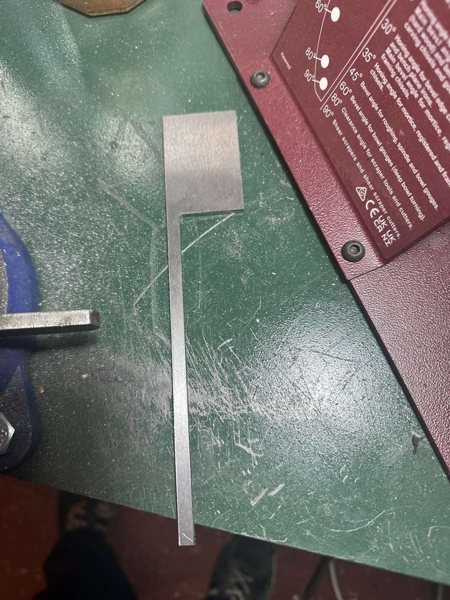

      I have been making wood plane blades for a while now. The process requires a piece of 3mm O1 tool steel to be cut into a particular shape, then tapered with a surface grinder before being profiled, hardened and sharpened. See a pic below of one of these blades being ground on the surface grinder.
      It’s the cutting part I have trouble with. Basically these blades are 8” long, and require 2 lengthways cuts plus a cross cut. The cross cut is easily done with a hacksaw but the lengthways cuts are not – too long for the hacksaw and they need to be dead straight.

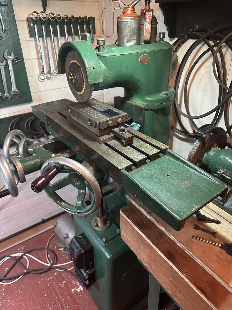

      I have been using my little Burke horizontal mill to do this, but it’s an absolute pain to set up for such a simple cut. I can’t believe anyone who knows what they are doing, uses a horizontal mill for cutting 3mm plate tool steel, which is very soft in its annealed state.
      I came across the Vevor 8” bench shear which looked hopeful. Clearly it would introduce some bending/twisting action but this may be recoverable from.
      If anybody has any great ideas, I’d be very pleased! I’m spending far too long messing around, making these simple cuts.

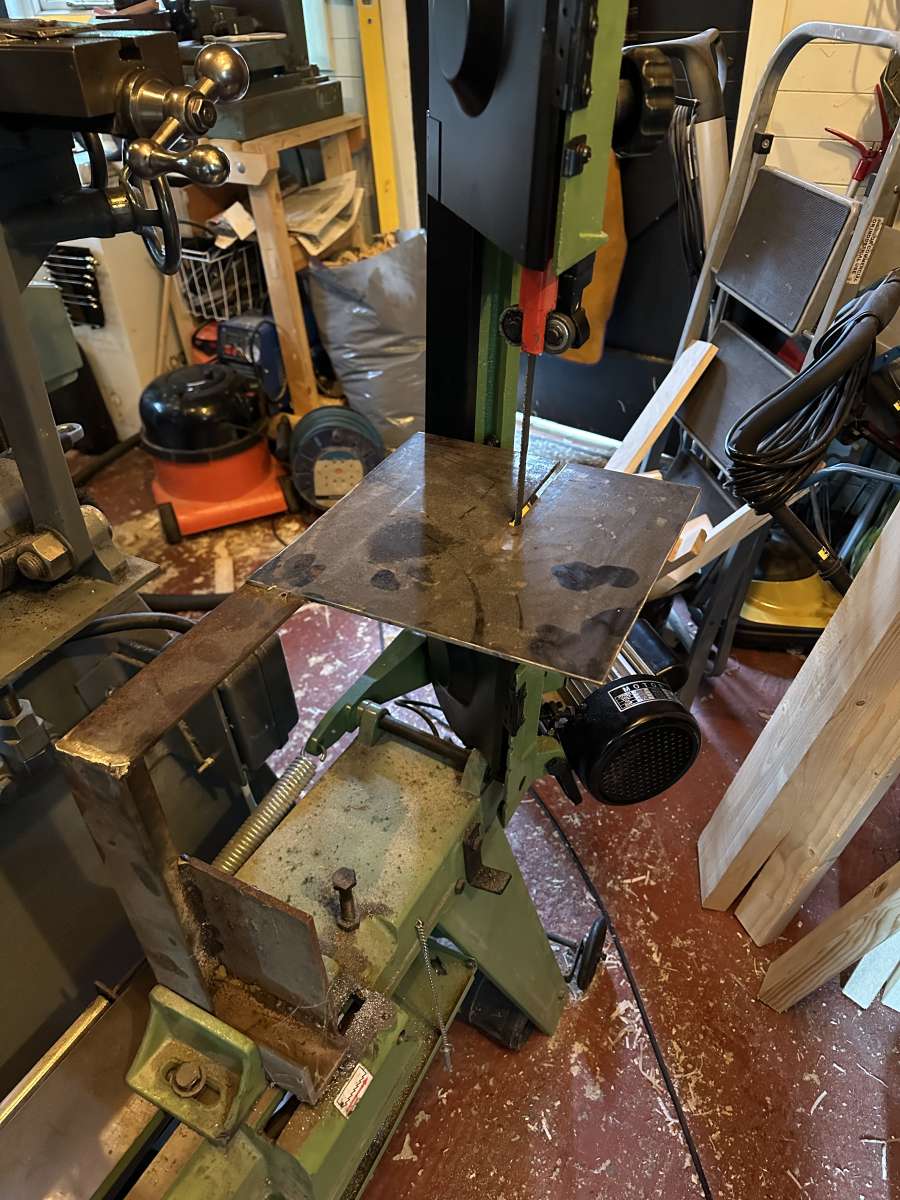

                  I do have a horizontal bandsaw, for which I made a vertical table sometime ago. But I couldn’t get it to cut O1 with the blade that I had. I ended up giving up on it at the time. But that may be worth another try with a more suitable blade.

                    here’s the bandsaw table. Could easily have a fence on it that would allow a straightish cut. Might work.

                    #692822
                    KenL
                      @kenl
                      That bandsaw should cope easily.
                      Use an M42 (Bi-Metal) blade and run at a slow speed with a bit of lubrication. If you use a wide blade (13mm+) and don’t “force” the cut you probably won’t even need a fence.
                      The most important part is to set the blade up very carefully every time you fit a new blade, look at the various You Tube videos for detail on adjusting guides, drive wheels and blade tensions.

                                        I don’t understand how it’s moving on the mill – what kind of clamps/set-up are you using?

                                                The cut’s too long for a burke model zero or one in one pass, but an aluminium fixture plate fixed to the table slot allows you to mount a fence along the back , which can be dialed in to be as parallel to the X travel as you can measure. You can then clamp the work to the fixture plate, locating against the fence an do the cut with as many repositionings as you need. A moderately thin slitting saw with do the job perfectly well. You might have just a whisker to cut through by hand to  finish the corner, but it looks like a correctly located hole to cut towards will result in what you need.
                                                The fixture plate can make the mill far more flexible, especially for our sort of work (often, really beyond the limits of the tools we can fit in the shed 🙂 )
                                                #693000

                                                  Hi MarK
                                                  It’s a Burke #4. It can just accommodate an 8” cut with careful placement. I bought a piece of aluminium as suggested, but I had a couple of problems – no doubt my fault through having barely any experience with Aluminium. I made a fixture plate but struggled with tapping holes in it. The tapped holes somehow ended up loose and then the tap snapped off in one and… well it didn’t work.
                                                  I have a new piece of aluminium. I will make a new fixture plate, but I realised that making something that can secure a tang that is potentially only a few mm wide so it can be cut with conventional milling, isn’t an easy task. So for simple plane blades, if there is a shortcut method that doesn’t require the mill, it’s worth investigating it. I thought I could make a more generic fixture plate to make work holding on the Burke #4 generally easier.
