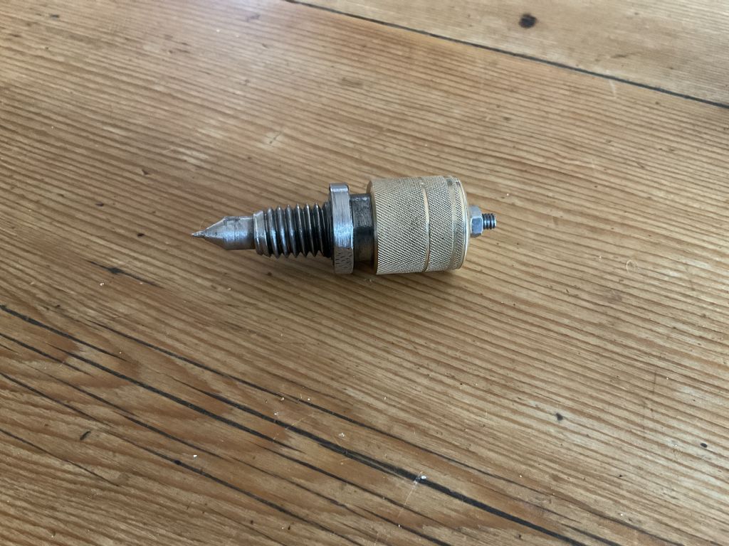

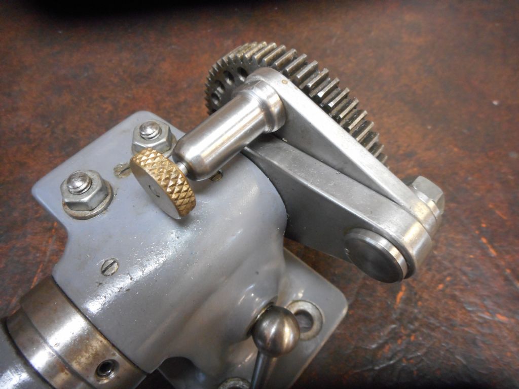

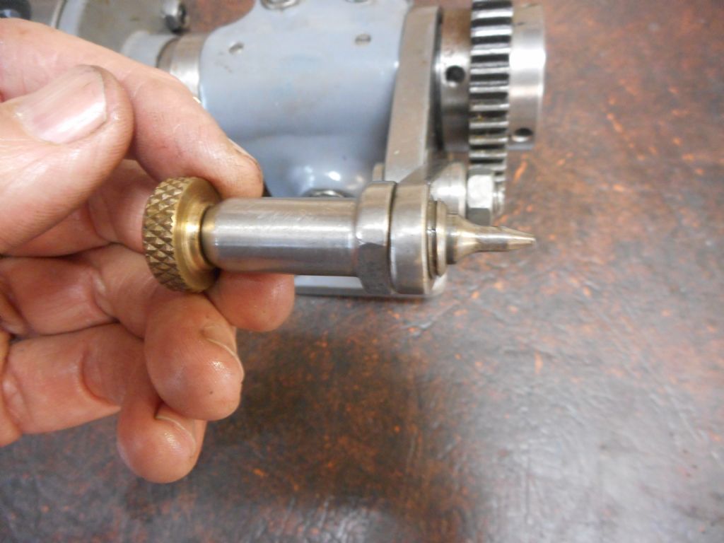

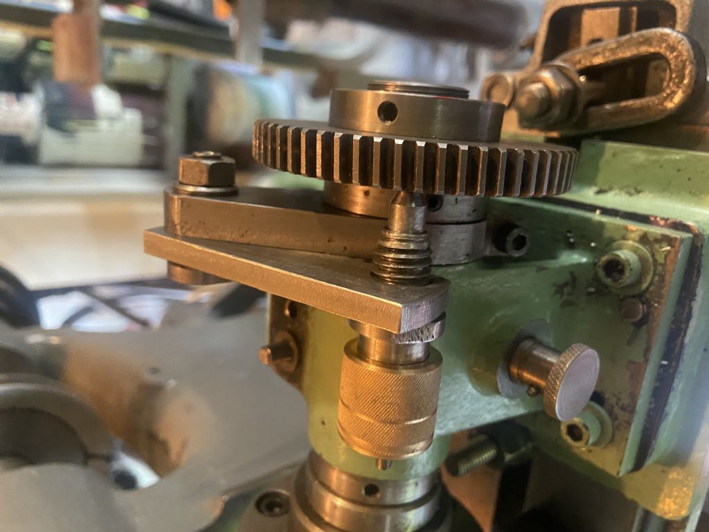

      Here's a few pics of the spring loaded plunger on my VDH. It's just a stepped spindle with a spring inside that body that screws into the pice of flat bar bolted to the existing index plate holding bracket.Easy to make without drawings.
      I made this non-standard right-angle mounting for the plunger so it can engage with the outside teeth on the 60T gear, which allows you to index more numbers, including fives and tens etc.
      I did what you said…. Not perfect, but works!

          Exactly Howard, this was a nice little thing to try with bits of scrap lying about, It didn’t cost a penny, unlike pretty much everything else I seem to do!
