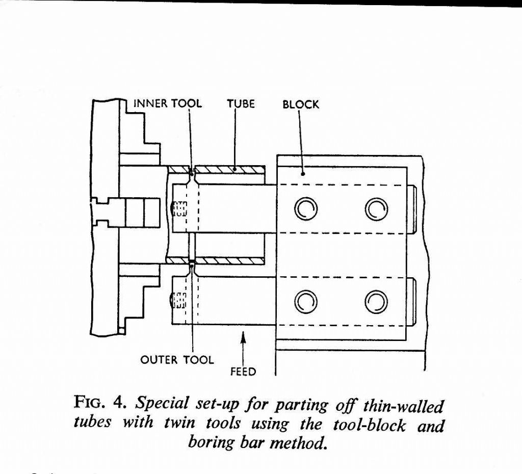

                                                  #514722
                                                  ega
                                                    @ega
                                                    The technique illustrated in my picture is aimed more at avoiding burrs than squareness although this should follow:
                                                    I have not included the accompanying text from Cliff Bowers' "Book of the Lathe" since the method seems self-explanatory.
                                                    The off-cut would, of course, be retained on the leading toolbar.
                                                    Edited By ega on 21/12/2020 10:33:48
