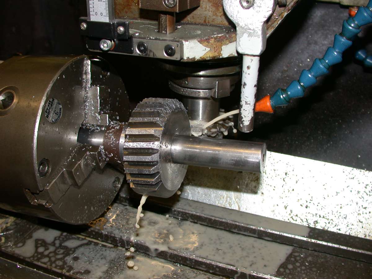

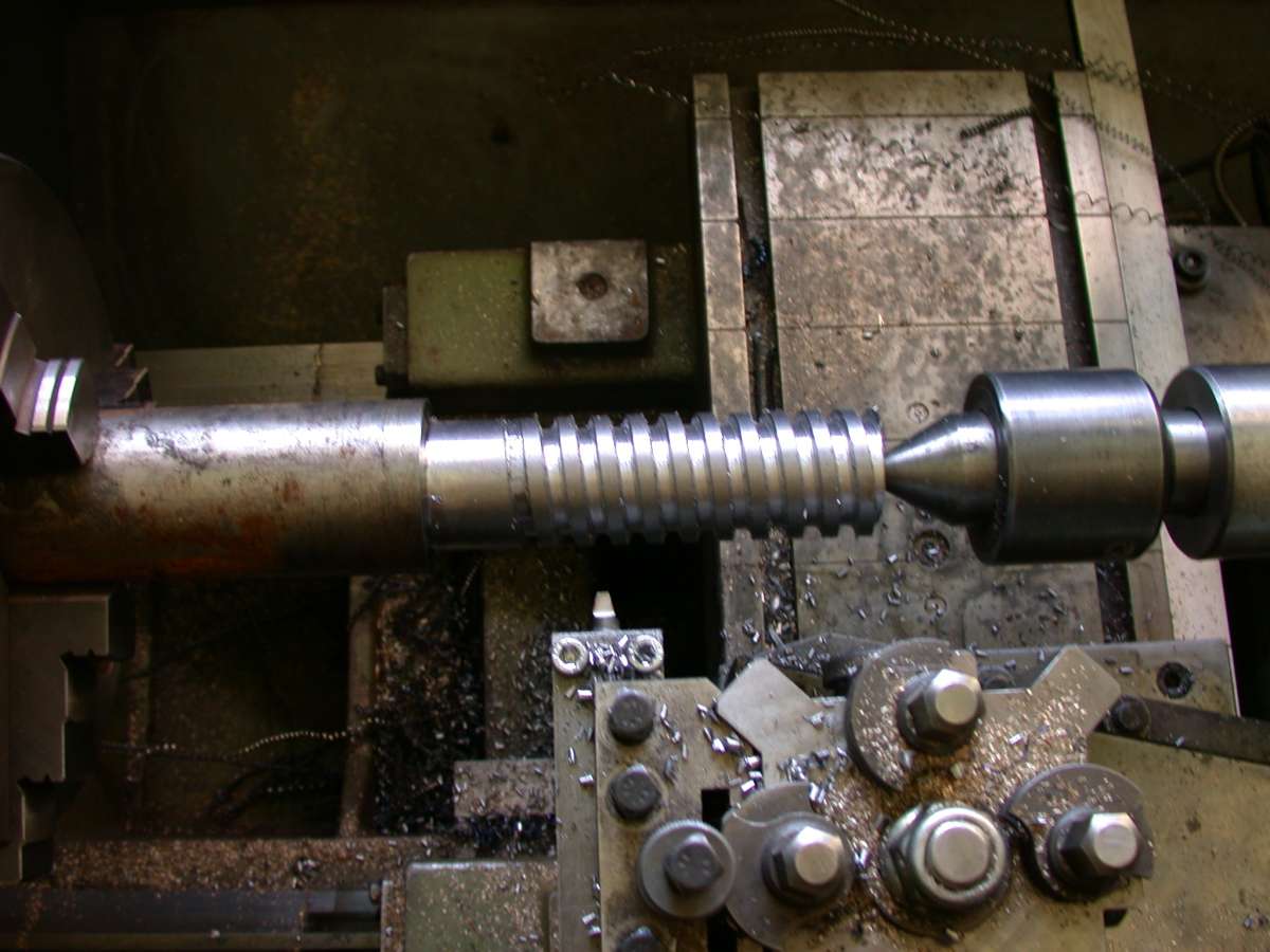

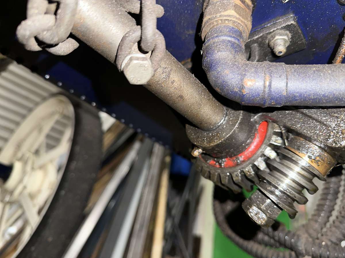

                  A little bit bigger scale but similar method :
                  I wanted to make the steering worm and wheel for my 4″ traction engine.
                  I used the info in Ivan Law’s book in the workshop series.
                  Cut a blank and gash it at the pitch angle, Turn a worm that has enough spare to make a “tap” as well.
                  Then cut off the length for the worm and put 4 flutes in the remainder and case harden.
                  Set the wheel up on the lathe toolpost to be free spinning and put the newly made cutting tap in the chuck.
                  Bring the two together and gradually mesh them. As the wheel is already gashed there isn’t much to come off and you can’t get wrong on tooth numbers.

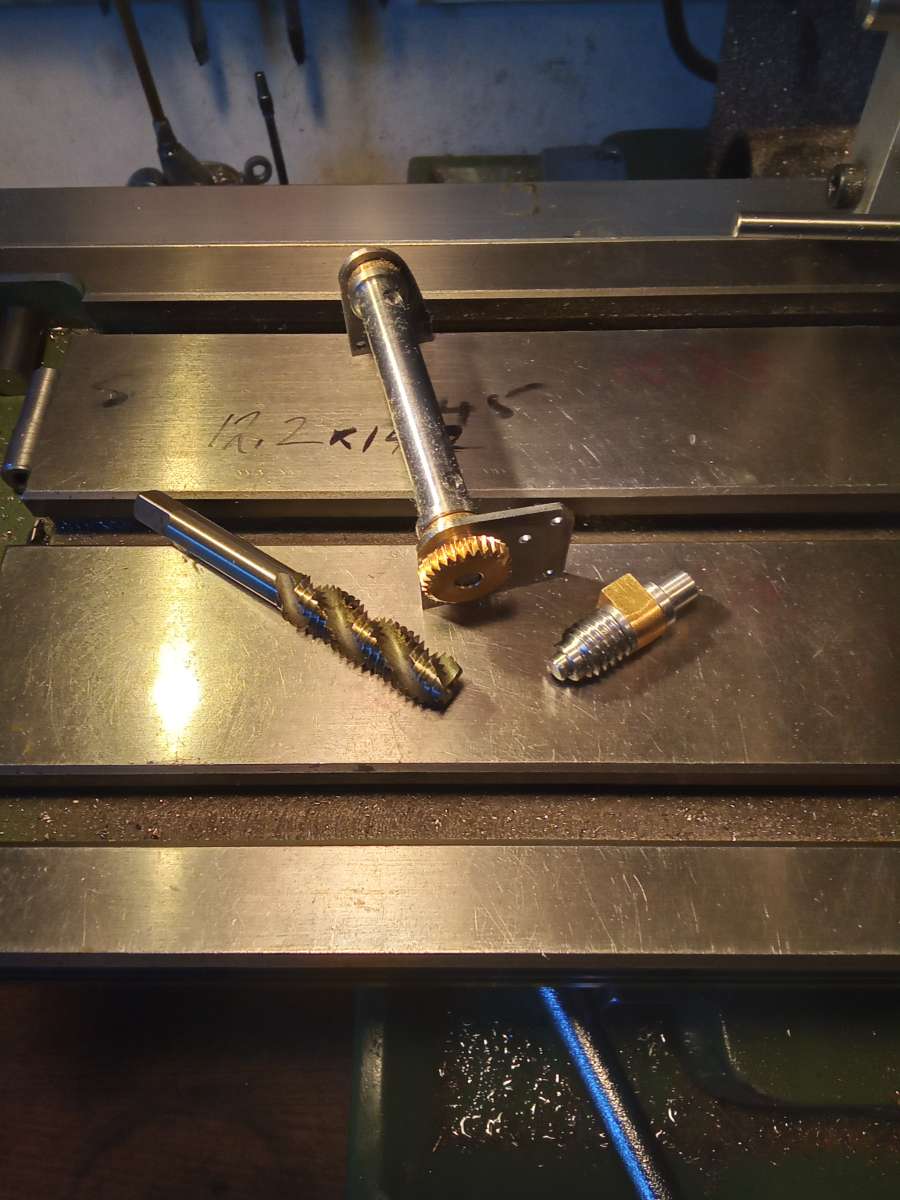

                                    Some interesting views there but I can say I found this to be a much easier operation than I envisaged.
                                    I agree – it’s not a ‘precision’ method as such but it was precision enough for the job in hand and has produced a smooth running worm wheel that works perfectly with the worm made to suit – and by that I mean the ‘diameter’ of the worm to suit the pre made bracket for good engagement.
                                    As said I made two – I doubt very much they are identical in diameter – I didn’t check as there was no need, I only needed the one but the one matter I could not visualise beforehand was the point at which the pitch of the tap would cut a true number of teeth for a given diameter – exact number of teeth were unknown so I don’t see pregashing would make any difference – beside surely it would need pregashing at the pitch angle too.
                                    Slip was not an issue either – the blank began to turn immediately the tap came into contact, I just fed the blank into the tap by the given depth of thread keeping a very close eye on the teeth to see if any were deformed. I think slip would only occur if the re was a distinct drag on the blank
                                    So no, not precision, but precise enough for a small one off gear required for the engine – requirement for two would have possibly been a different matter.

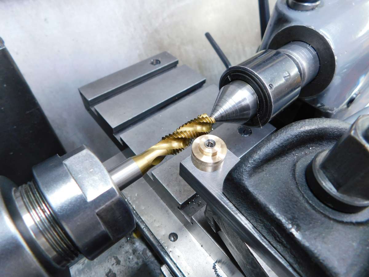

                                    This image shows it backed off after the initial ‘cut’ after touch on to see if it would work. It was then cut by constantly feeding in to depth

                                        I am just curious as to wether the spiral tap actually maintained contact with the worm wheel blank at all times ?
                                        It might be just the angle of the photo, but it sort of looks like it might lose engagement still.
                                        Phil

                                              Phil P – I can see what you mean but I didn’t experience any indication of it when cutting – if it hadn’t been in constant engagement I’m sure that that would have been felt as the cut was advanced. The tap was M10 not M12 as previously stated BTW – the wheel is quite small the diameter in the groove just 13 mm

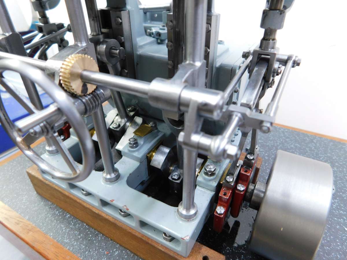

                                                  The one in the photo certainly looks anything but bodged ,Tug.
                                                  One thing I’d add – if possible, make the blank much wider than required to increase the chances of continuous tooth engagement by the tap.
                                                  Due meanness with materials, I didn’t do that with the one shown below and ended up with several gears, none of which had the exact number of teeth. I picked the best, but wasted far more bronze than if I’d made the blank wider in the first place. Still, it was pretty easy to do (unlike setting the lathe up to cut 7 TPI for the two-start worm. Hopefully such shenanigans will soon be a thing of the past when the parts for an electronic leadscrew arrive).
