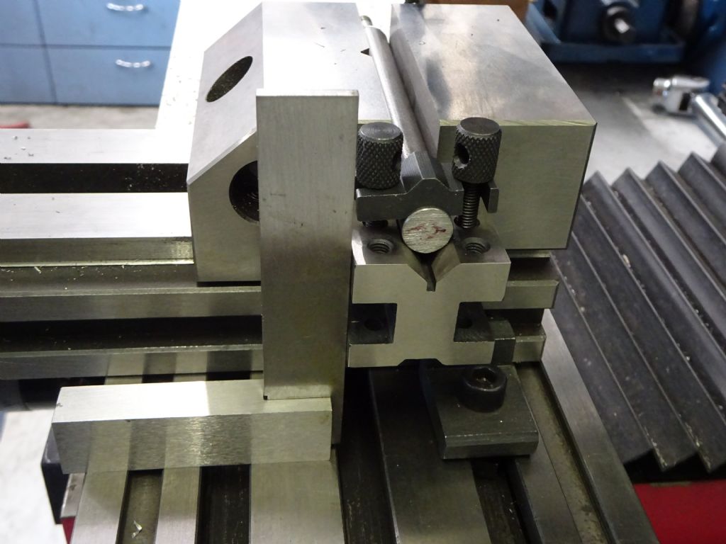

                To use the try square method successfully, hold the stock of the square firmly against the flat on the job and look at the gap between the long blade of the square and the cross slide table, as shown in the pic i posted earlier. Any error is greatly exaggerated by the length of the square blade compared with doing it the other way round and looking for a gap on the very small milled flat.

                    Another way to make the use of a tri-square easier if the flats are quite small is to clamp something to the rod, such as a Vee block. I saw this tip in a bookwink

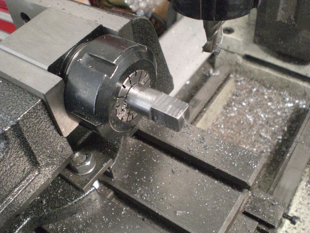

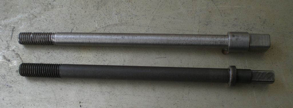

                      Hi, when I needed to make the imperial drawbar for my mini mill, although I didn't see the need to make the top exactly the same size as the metric one that came with the mill, I still put a square on it for a spanner. As has been said though, I used a Stevenson's square with a collet and just clamped it in my vice on the milling machine table, calculated how much to cut off each quarter and the job was done, then just popped in in my mini lathe to take a small cut to round off the corners slightly.
                      Regards Nick.
