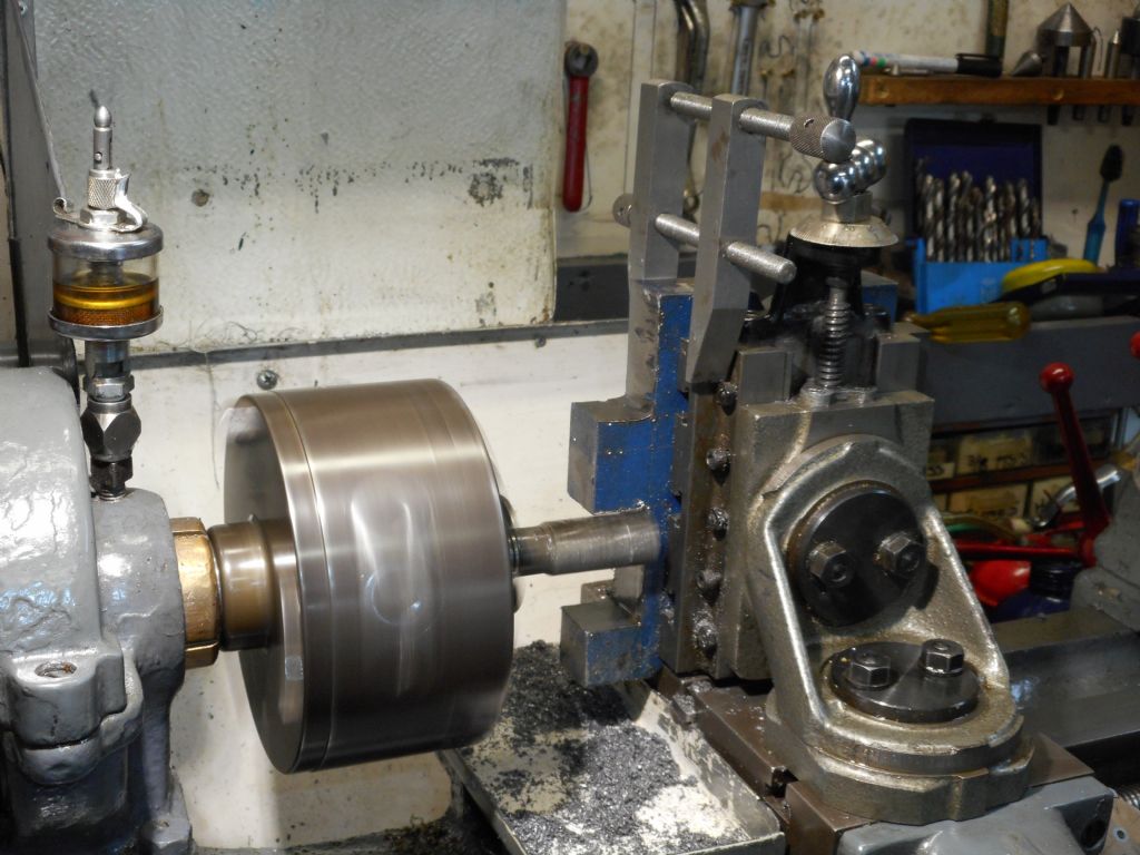

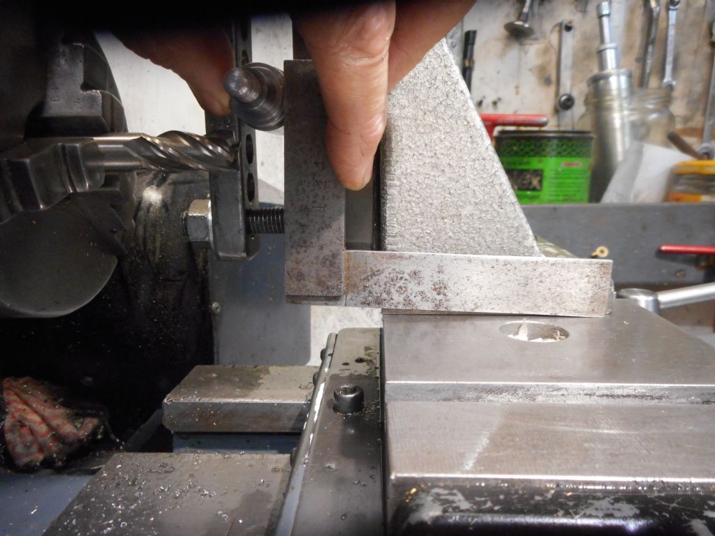

                  Hold an end mill cutter in the three jaw chuck of the lathe. Clamp the job in or to the toolpost and mill the first flat on it. Use a try square to rotate the job 180 degrees and mill the second flat. Then rotate it by 90 degrees by using either a steel ruler across the flats, or one of those magnetic digital levels. Then repeat to 180 to do the 4th flat.
                  Of course if you have a vertical slide, you just clamp the job to a T slot and use the same principles.
                  No it does not give the sort of accuracy for cutting gears but plenty good enough for squares and hexagons for spanners etc. I do it all the time that way. And yes the three jaw lathe chuck will hold a milling cutter without it winding in. Been doing it for years without a mishap. (famous last words!!)
                  In your case, clamping to the toolpost should do the job.

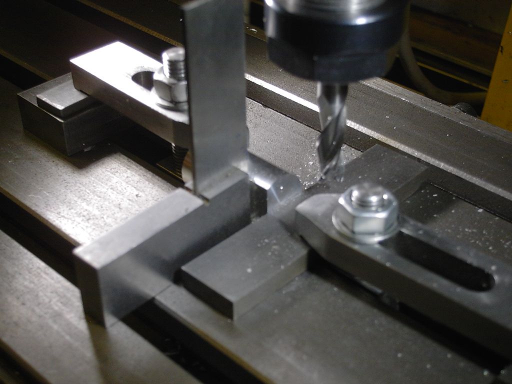

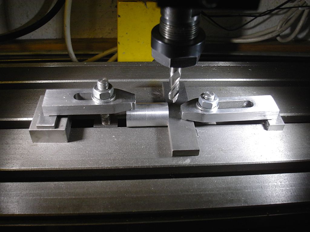

                    The easiest way is to fit a chuck to the rotary table. It centres jobs like your chuck key on the table's axis, making it straightforward to cut the four faces of the square with a milling machine. Might be possible to attach your lathe's chuck, but chucks for rotary tables usually have four bolts passing through the chuck's body so they can be undone from the front. The bolts engage with T-nuts in the rotary table's slots. If you haven't got a suitable chuck, welcome to the wonderful world of model engineering, in which there's always some new accessory wanted!
                    Rotary tables shine when other than right angles are needed, otherwise not essential because other methods produce right angles. I made my chuck keys by gripping the shaft in an vice on the milling table with the end sticking out enough to receive the end of the milling cutter. After the first flat was cut, I turned the shaft 90 degrees in the vice and used a set-square against the face to get it exactly* vertical. Then cut the second and other faces in the same way.
                    If you don't have a machine vice, the shaft can be clamped directly to the milling table. It's a little more bother adjusting it compared with a vice.
                    *exactly needs some qualification. A casually used set-square will get close enough to 90 degrees for most purposes, but on this job the short face length and fiddling with the shaft in the vice limits accuracy. The vice problem is much reduced if it already has a V-slot jaw, or V blocks are used, to keep the shaft horizontal. Good news, chuck keys don't need to be anything like accurately square! I wouldn't risk it, but I'm sure our more accomplished brethren could eyeball a good enough square end on a chuck key, not just with a milling machine, but by hand filing it in a bench vice.

                          I'm a bit nervous of holding Milling cutters in a 3 Jaw for some of the methods mentioned above, but I'm quite timid with some things.

                                I have clamped the work direct to the milling machine table using the tee slot. Use a sqaure when rotating to the next face.
                                        Never had one move yet (Famous last words!) ranging from 1" diameter in the 3-jaw down to 1/8" diameter set to run dead true in the four jaw. Both chucks ancient Myford fittings. Ditto on my even more ancient Drummond. I think if we were taking deep cuts at high feeds in industry, it would be a different matter. But the lathe and vertical slide are so comparatively flexible that you have to take shallow cuts at fine feed anyway so I have never had a problem with the legendary cutter being pulled out. Mind you, I do have a firm hand with the chuck key.
