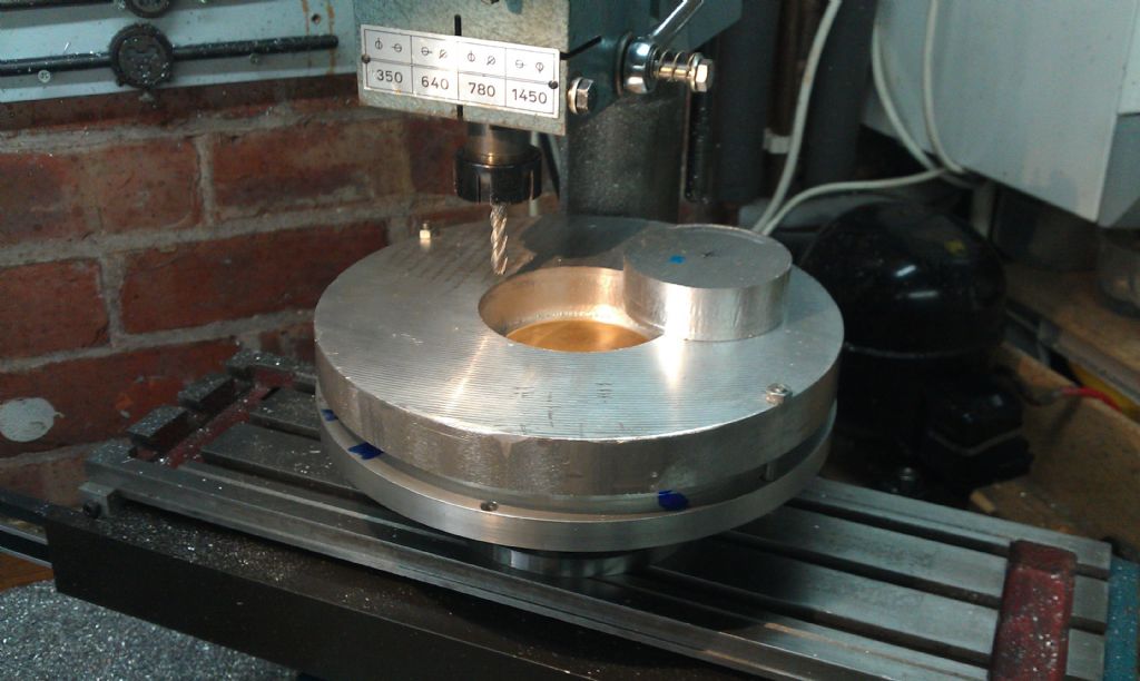

        imag1768.jpgIn case anyone wondered how I was able to hold an 11" diameter aluminium disk in my elevated headstock Boxford (in a separate thread) I have uploaded a video to YouTube showing how I cut a large central hole so I could grip it in the chuck.
        Video is shaky as I am lowering the cutter and giving the job a spin whilst holding the camera. This was the second hole I cut, the first one started almost by itself. Cutting through the 1" takes about 10 minutes.
        The rotary table is made out of a car front wheel bearing/hub assembly. It has very little preload and yet no detectable play.
        The video is at,
        http://youtu.be/Jv8_JCiAbRk

              I have done something similar but always used the handwheel on my rotary table. As you say, yours almost do everything by itself! I suppose the bearings in your rotary table has much less friction than mine. Nice video.

                I would have done the same but I dont have a real rotary table. The 'table' on my rotating axis has a few sets of indexing holes in its top face (12 & 10) and I use it as a rotary indexer (with a lash up clamping device)
                I have used it to 'carefully' cut large radii on rectangular reatures by arranging temporary travel stops. Rotating the job whilst cutting needs concentration and a firm grip on the table! but it works.
                Ian P
                Having said that if you have a table on which you can disengage the worm gear then
