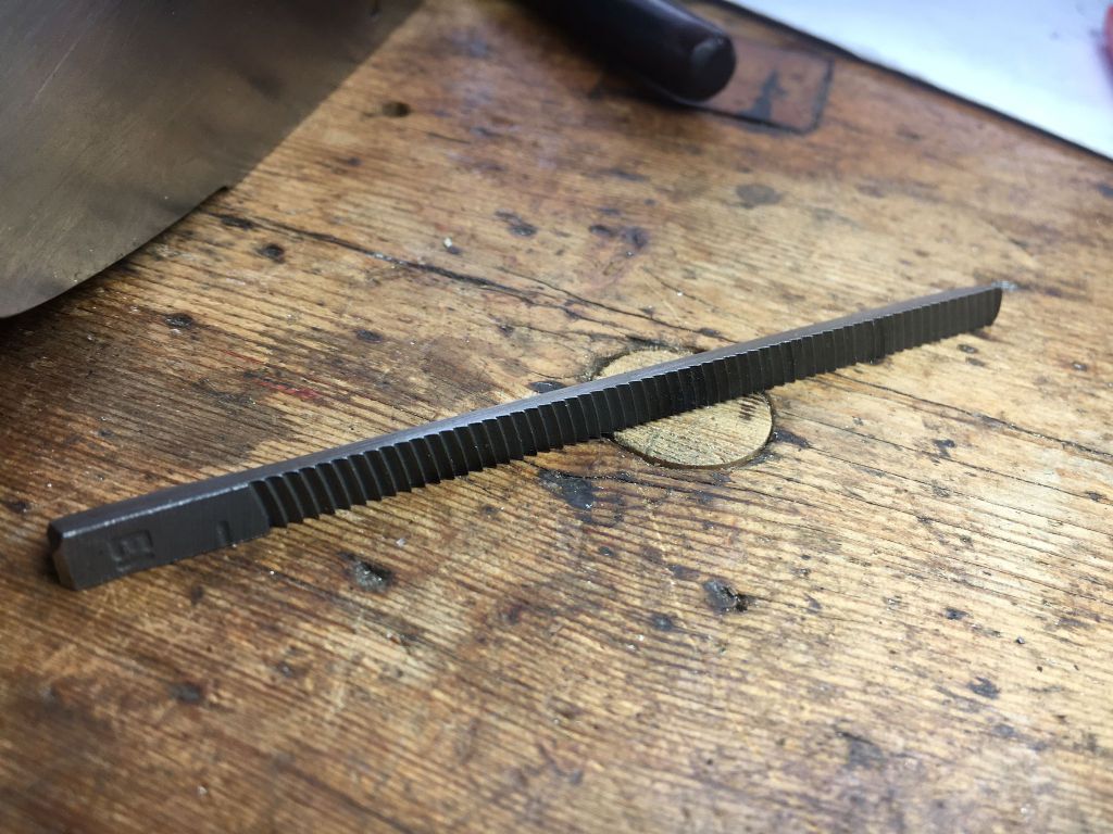

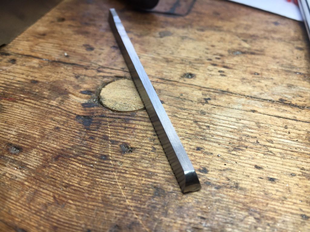

                  #656395
                  Mike Donnerstag
                    @mikedonnerstag
                    Many thanks for all of your answers.
                    In the end, I found part of a dreadnought file that I had already cut out of a larger file into a square section. Although I had drawn the temper in a spot when I cut it out, I didn't think this should be too much of a problem.
                    I spent several hours on an upturned belt sander to slowly and carefully grind on the 15deg angle on each side, quenching in water as I went and being careful not to sand my finger-tips! I went through three blue zircon belts, which are probably still good enough for sanding wood.
                    Not great photos, but hopefully they show what I achieved.
