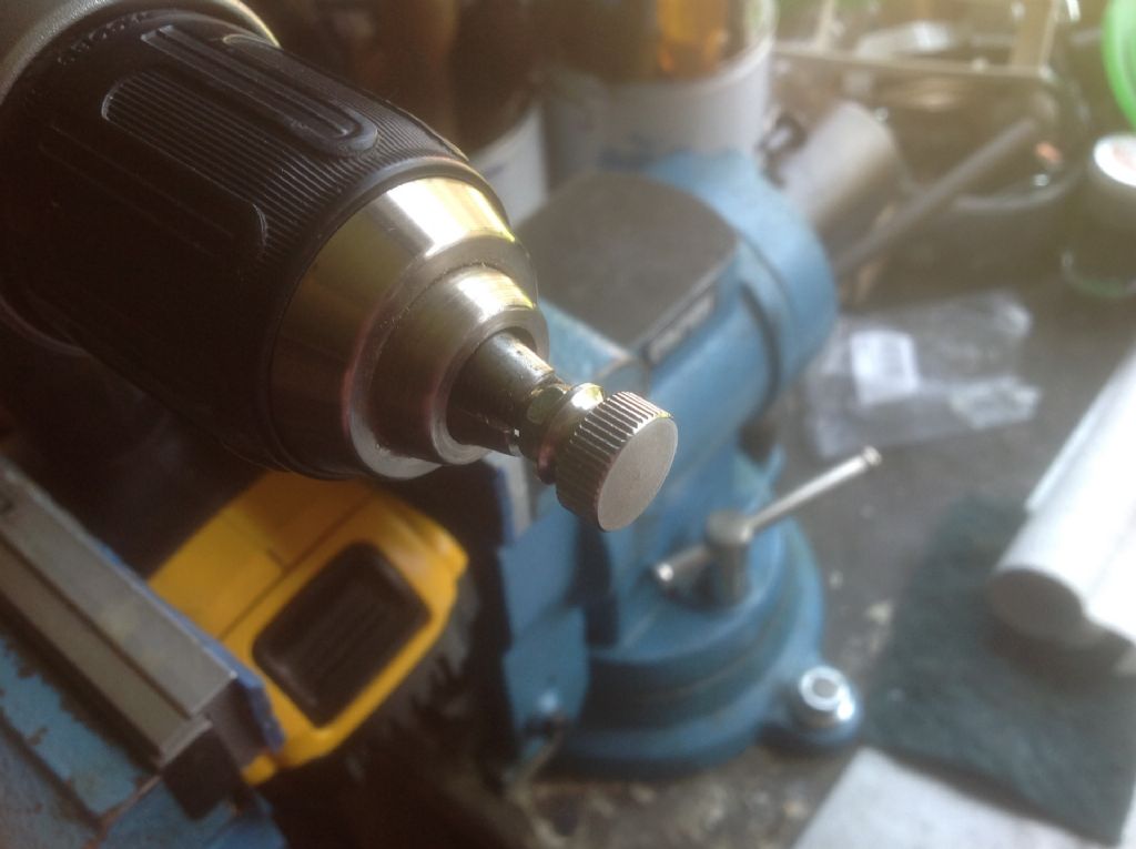

        come to think of it. Bill's method would work.
        How do you dome the top of the nut to make it round?? Can you please elaborate?

              Philip, in the image, a thumb nut is set up for doming. The technique is very simple. Hold the drill in a vice or Workmate: spin the chuck and hold a cutting tool (e.g. a file) or an abrasive material at the right angle to create a slight dome.
