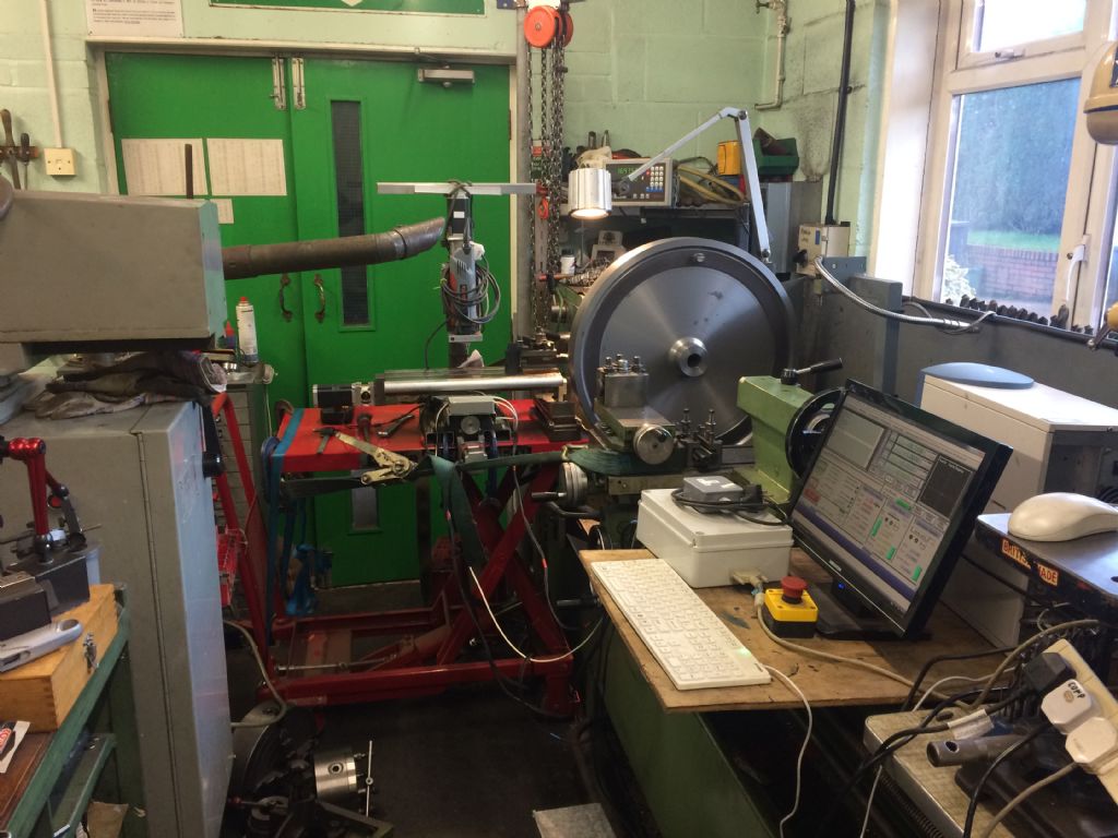

                                  Thinking outside the box, I recently needed to put a crown on the flywheel for my current traction engine build.
                                  I used my little CNC mill on a hydraulic table next to the lathe to perform a simple curve cut with a lathe tool clamped to the mill table. Worked perfectly!
                                  #635224
                                    An excellent ‘hi-tech realisation’ of what I mentioned earlier, Les
                                    Very impressive yes
