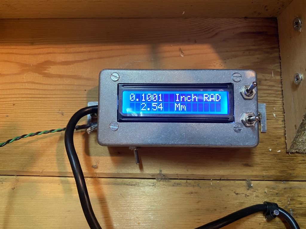

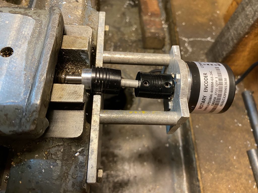

                                        Speedy Builder5
                                          @speedybuilder5
                                          Finally got there. Using an Arduino and Encoder, a couple of in line flexible joints and now can read out to 0.0001". A bit of a tight squeeze into the aluminium box and at first noise between the encoder cable and general electrical noise. We seem to have a stable and repeatable system by Screening the Encoder cable attached to the metal box and encoder "grounded" to the lathe.
                                          The switches are On/Off  Reset  and choose of Radius or Diameter setting (Not sure if I would ever need Diameter !!)

                                          Ian P
                                            @ianp
                                            Posted by Speedy Builder5 on 25/11/2022 16:44:09:
                                            Edited By Speedy Builder5 on 25/11/2022 16:46:06
                                            Look like a couple of 'out of line' inline couplings!wink

                                            bernard towers
                                              @bernardtowers37738
                                              So if your couplings are out of line how can your measurements be ok to .0001 at all points of rotation?. Wouldn't it be better if the encoder was directly in line with the feed screw ?.
                                              #622659
                                                I like it except the measurement is of screw turns rather than tool movement and is thus vulnerable to backlash error.
                                                The Arduino could be programmed to compensate but would need to be recalibrated periodically as the nut and screw wear. Which reminds me, the amount of backlash on my lathe has crept up enough to annoy me again. There is no rest for the wicked…

                                                  Speedy Builder5
                                                    @speedybuilder5
                                                    I don't know where my reply went to Bernard, but the reason for the offset is that the cross slide would foul the encoder as it reaches full travel. I had a quick scout around to see what the angular error might be, but didn't find anything on the net.
                                                    Dave, I could live with that probably no worse than the divisions on the cross slide handle Its been an interesting exercise in rattling the grey cells.

                                                    Ian P
                                                      @ianp
                                                      Without dimensions or knowing what lathe this is it is hard to offer an opinion or make judgement on the arrangement, however from the picture it looks as if the cross slide will be well out of its dovetail engagement by the time it gets anywhere near the encoder body diameter.
                                                      At full travel does the cross slide pass over the encoder?
                                                      To minimise angular accereration errors in (pairs of) Hooke (and I presume beam type) couplings, the input and output shafts need to be parallel but also the 'phasing' of the two couplings has to be correct. On a Hooke joint the pivot points are obvious but on the helical coupling it would be a bit more difficult to define just where the beam starts.
